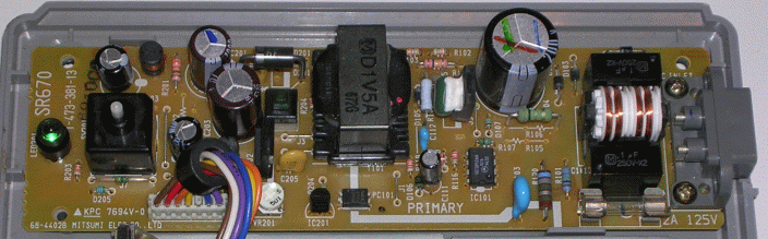

Ok, here is the bridgerectifier (D001) in detail:
I guess, four pieces of BYV96e will do a better job. 😀

And here's the Mitsumi SR670, coming from my SCPH-1001.

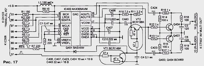

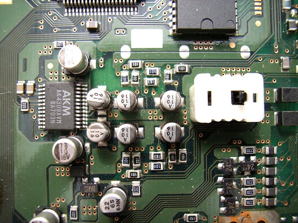

Has anyone seen the output circuit topology described anywhere ?
I assume there is a DC blocking cap on the output, which, judging by some of the excellent pictures must be a small surface mount device. I wonder if a low value here accounts partially for the lack of bass ? My preamp has adequate DC blocking anyway so I was thinking of removing any caps in the output signal path as the next obvious tweak ?

Attached is a schematic of the output stage.
Mick
many thanks Mick.
sorry to bury you in questions but you seem to have been a trailblazer on the PS.
q1. Is this output stage standard across all models (particularly the (SCPH 1002)
q2. C424 & 423 appear to be there to block any DC element. Have you tried replacing these with links ?

1: I think so.
2: No I have never tried as I use no input DC blockers in my current amp.
