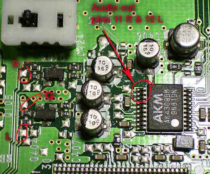

ps 7002
Here is a photo of the output of a 7002. There are no components under the board so it is easier to follow. I will be connecting onto the pads by pins 11 & 12, removing the 4, 10uf caps, connecting staight to new RCA's via the same caps as I used on previous PS's (models 1002 & 5552), and seeing how it sounds in comparison.
It is also easy to see the output stage and I have marked the outputs, L, R and G after this section.

Re: ps 7002
Thats quite a different beast isn't it ? The DAC has 4 less legs and the output is much simplified. Mind you, you can see the ceramic PSU bypass caps very clearly.
I guess you could gut a controller to figure out which buttons perfom which functions, then put in some small switches at the player end. I just use a £5 remote I got from ebay which plugs in the controller slot. Looks butt ugly but does the job

Re: ps 7002
from what i have read the 7002 don`t sound good.
the models that worth the effort are 1002 5002 and 5502
