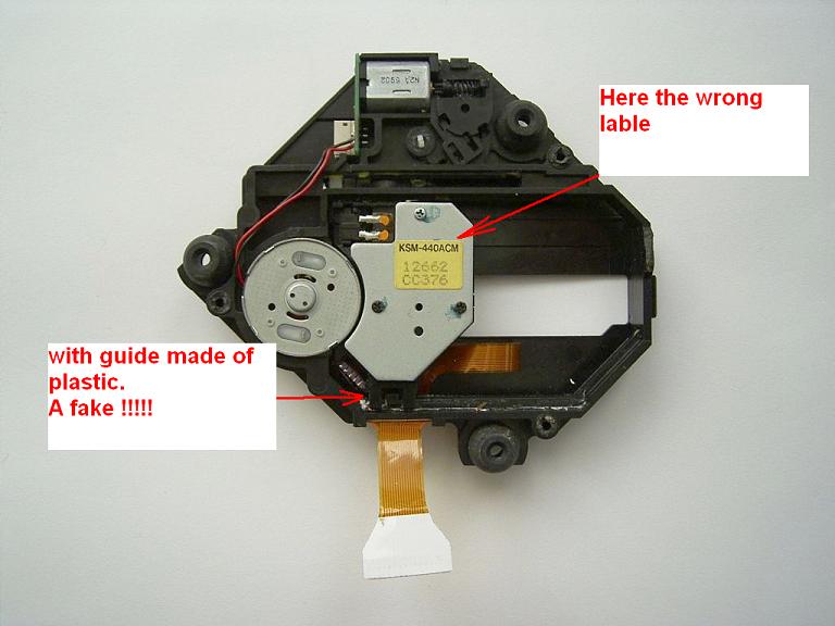

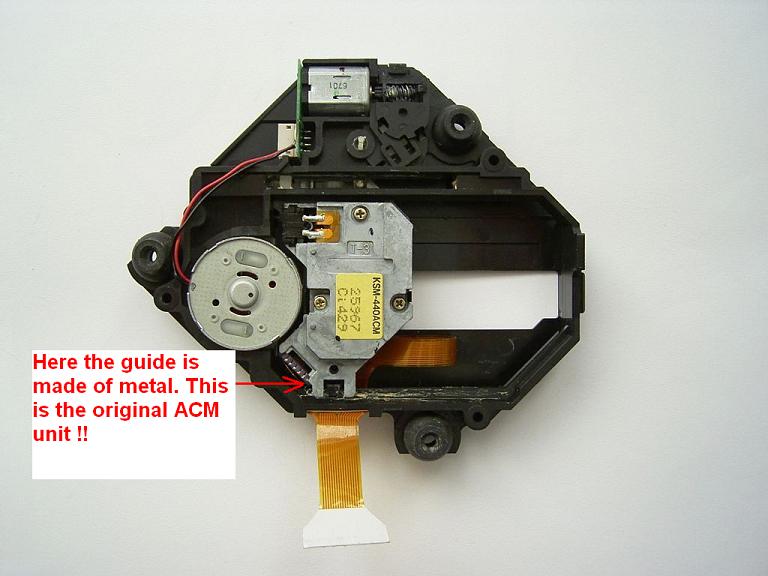

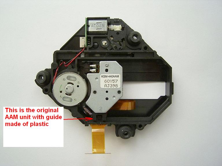

i had a little bit of time the last days so i could work a little bit at my PS. I have 6 new Laserunits here. On 5 units the distance between CD clamp and motor is 0,3 mm. Only at one KSM 440 BAM the distance is 0,6 mm. Why ? Because i have a metal clamp. It depens on what metal clamp you have. At my clamp with no holes 0,3 mm it not possible. If you have a clamp with the big holes, or the plastic clamp than 0,3 mm is right.
Than i checked my Bias and Gain Adjust : Values : Bias 1,56 Gain 1,76 V. Now i tryed all units with a verry problematic CD. I know that if the PS is able to play the last tracks of this CD she will play all other CD's too. All laserunits haven't had any problem with the CD.Than i tryed other CD's with same results !
I than measured the lasergain and the results are :
Laserunit AAM 11,4 mV
Laserunit ACM 24,4 mV
Laserunit ADM 24,4 mV
Laserunit BAM 11,4 mV
I was verry bemused because i had one laserunit ACM with 24,4 mV and one with 11,4 mV. ??????????
Than i saw it !!! The lable on the laserunit with 11,4 mV was a fake !!! I saw the guide of the unit is made of plastik !! So the unit is a AAM unit with wrong lable !!! I looked at the HP www.playfidelity.com and i acknowledged my presumption. Look at the pictures below. So my first statment zhaz all units with short kopper cable have 11,4 mV Gain is wrong ! The correct values are shown above.

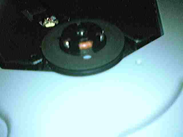

Hi
Both my 1002 PS1 playstations seem to have bits missing
from the central spindle. It seems to be a habit of Sony Units
with ball bearing clamps to shed bit of plastic. How critical
is it? They seem very light bits of material and I wonder
how badly spindle balance is upset. Otherwise tracking on
both units seems good. At AUD$39 each they did not break the bank.
Regards
AnthonyPT

Hi Thomas,
please have a look on the Lasertransport of your ACM. In my post i discribed that there a fakes which are labeled ACM but have a plastik transport. See my attached pictures on past posts.
If your transport works with 9,2 mV and the discribed Gain and Bias o.k. I will try it with a transport and will report if the sound is changing. Because if you have a Laserbias of 9,2 mV you have to highten the Bias, so the Lense is nearer to the CD. Maybe you get an other sound.
I measured the Lasergain on new transports.
Buy the way, last friday i received a new BAM unit (from EBAY )with Gain 24,4 mV. It works good !!
BR Domenico
