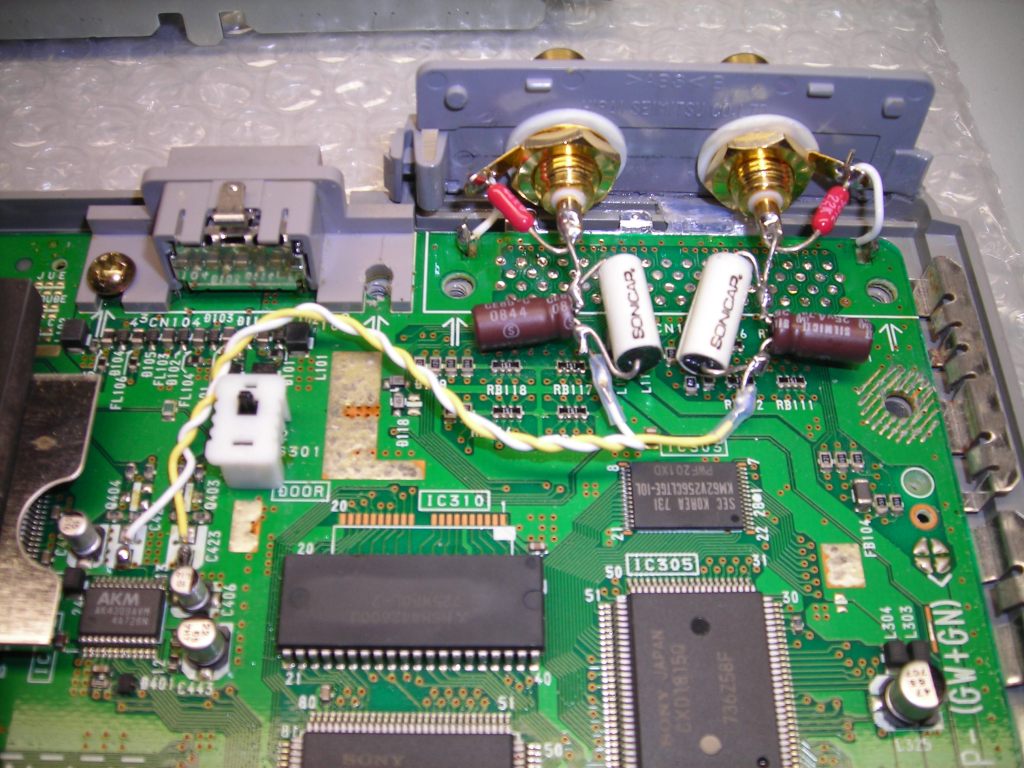

Hey guys, I own a SCPH-1000 which uses the AK4310 DAC. Can someone please tell me where should I start reading for mods on this particular model... *headaches*

Could you explain how you connecte d the S-Video to your music system? I have that Sony S-Video cable but when I plug it into my 1002 no audio comes out when I connect the red/white rca's to my HIFI.

I don't think you remember me, but I've contacted you through Facebook several times asking about the DC/DC converter for the OPA.
I want to thank you for your immense help and guidance, I still haven't changed the OPA or added the conv. yet (each parts ordered took like a month to arrive), but I've swapped out the caps with some Mundorf 4.7uF, used proper rated resistor for the output RCA as well (forgot what is the value, it was months ago).
Unfortunately one problem arises, it boots up well and recognizes there's a CD on the spindle, but when I press any button on the gamepad controller nothing responded.
I'm assuming it is a faulty controller so I've ordered a PS2 remote control. It should arrive today and I should be able to test it out later when I get home from work. I hope it works.
God I hope it works.
I've had this project on and off since I was still a student.
Good news! I got the controller to work again. It was a broken 3.3V fuse for the controller port. I desoldered and replaced it with a single copper jumper.
Too bad the sound isn't as good as I thought it would be :/
Maybe I put wrong value capacitors.
Also it skips so much. I guess the laser pickup needs replacement too.

I assume we cannot edit our posts?
Anyway, I took apart the laser pickup assembly and greased every moving part and put them together again. Then It turns out one foot from the high pass filter resistor detached due to a cold solder. I soldered it again and did some general cleanup with the connections between the caps and the RCA sockets. It played beautifully afterwards. It stopped skipping now except for a problematic Ellie Goulding CD.
And I think the capacitors needed some burning in too, the sound continued to open up as I changed CDs for the next few hours. Non fatiguing, very smooth, the output stage doesn't roll off the bass anymore so Lana Del Rey - Honeymoon has some solid, full, and controlled low end.
I do detect some sibilance in certain vocal parts and 'esses'. Not too sure what is causing it or if its actually in the tracks, but I'll let the caps burn in longer just in case.
