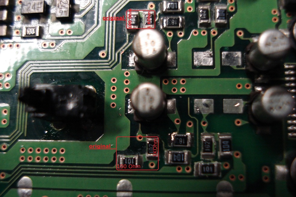

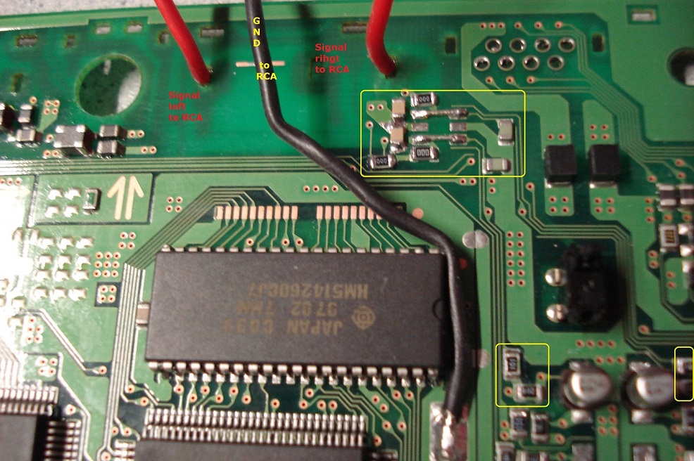

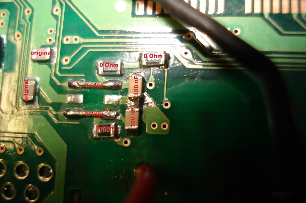

Hello guys,
I have modified SCPH-1002 with overload (?) sound. I have no idea what goes wrong with the modification (all done like a Feinste ANALOGE Klangeigenschaften SONY PS1 Playstation 1 SCPH-1002 High End CD Player deutschermanfred.de, including power supply).
Here is audio file with startup sound and modification photos:
https://www.youtube.com/watch?v=gn_LU1rjq4s&feature=youtu.be
I have used OPA2134UA and DC2WSIL5/12 (DC/DC converter).
In audio section are 35k Ohm resistors, but on 39k (smd) effect is the same.
My testing platform is Logiteh x-530 (PC speakers) or FiiO with CAL! headphones (better parts is not avaible now).

Hello @Koveras,
where Is the exact plan for this modification?
What happens on pause function when the CD plays (rotates CD, and you push START) and at the amp is of maximum level?
greting @Cochise
www.spektral-audio.de
@ Koverasich ,
have also modified a Playstation 1 SCPH-1000 guidance of deutschermanfred.de. I am very satisfied with the result. Obviously is Manfred the only one who has published a complete guide, and all for free.
Did you do the trace cut before you soldered the OPA2134? Did you measure the voltage at the OPA and DC/DC converter?
If you 're stuck, then write to Manfred an email. He allways gives competent and helpfull answers. Here is his email: info@deutschermanfred.de
Hello @Pg2005,
the question is "where is the construction plan for @Koveras modification" I did not ask what is on the page yet offered shall, because it does not solve the problem.
On the page "feine analoge Klangeigenschaften" I can not (more) find this plan - why? @Koveras has this modes from there.
So I analyzed according @Koveras film, and I think I know where the problem is. I have explained this up in a German forum two years ago.
>>> What happens on pause function when the CD plays (rotates CD, and you push START) and at the amp is of maximum level? <<<
I think all who have built the get this problem.
! - The opamp (also the BB2134UA) oscillates - !
Look my pictures.
