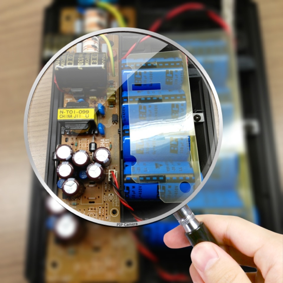

I use a fully modded playstation scph 1000 with external psu and massive over 20.000uF, burr brown op amp 2134 and dc/dcconverter5/15v.
The sound is absolutly clear and the orchester seems to play in the room. Really clear and also smooth.
it doesen't cost a fortune to build this jewel

External power supply for 7,6v 3,6v & 15v (also 18v for my burson discrete HD opamp's) and with more than 100k uF etc etc...
and "the orchestral seems to play in the room" you can not achieve even with high end stuff
but ps1 has indeed great potential.
