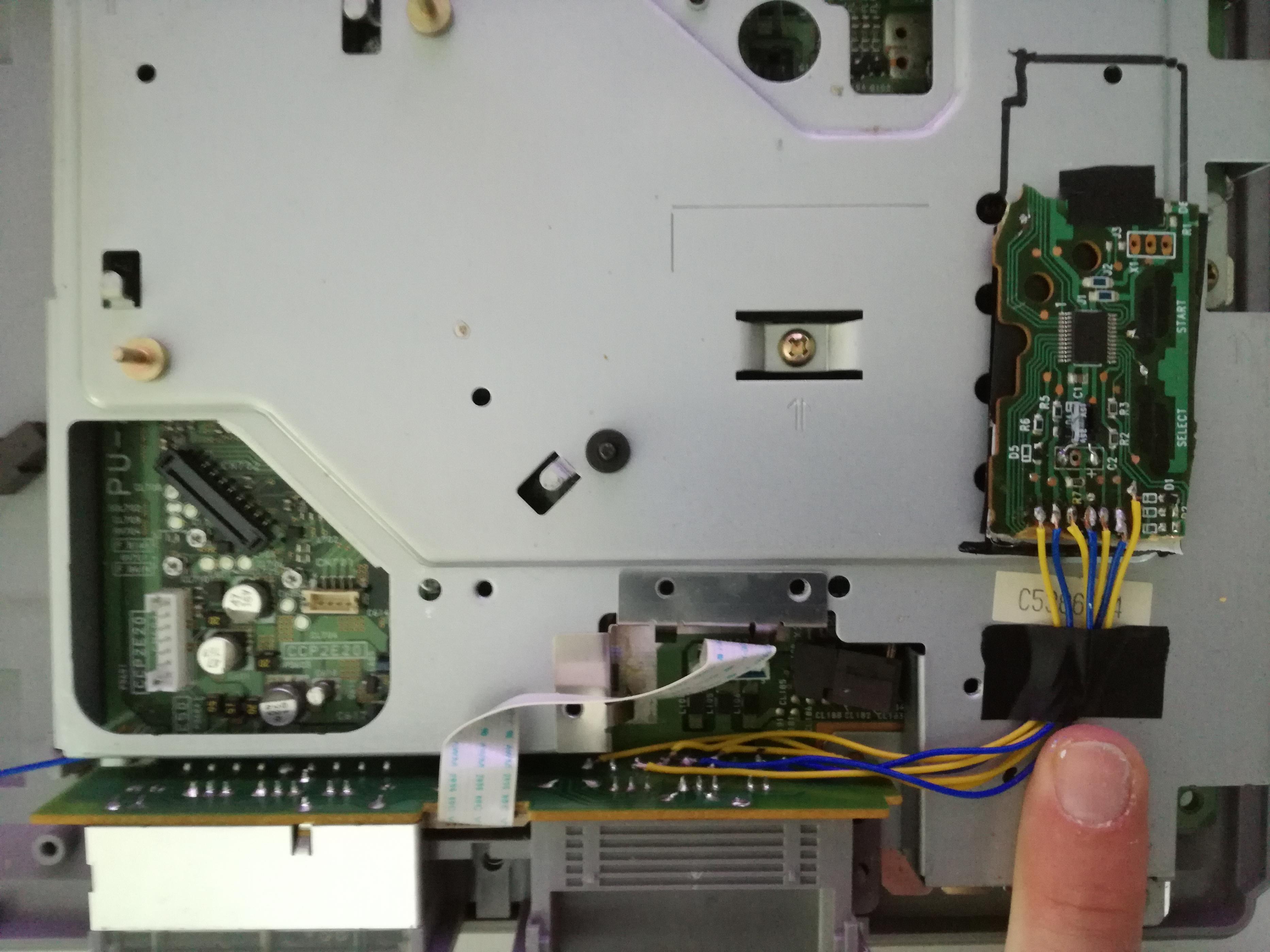

The last few days/weeks I've been redoing the PSX and repainted it. Last night I soldered on the IR receiver for the PS2 remote to the motherboard, but then it worked for a while.
Afterwards the remote control only worked intermittently, and then stops working entirely.
Anyone has any idea what could be the problem?
I followed the guide from this page.

At the risk of sounding like a spammer - the remote receiver is working. It turns out the connection is loose somewhere so need to wiggle it. I've stuck it into its original housing with foam tape so they won't move anywhere anymore.

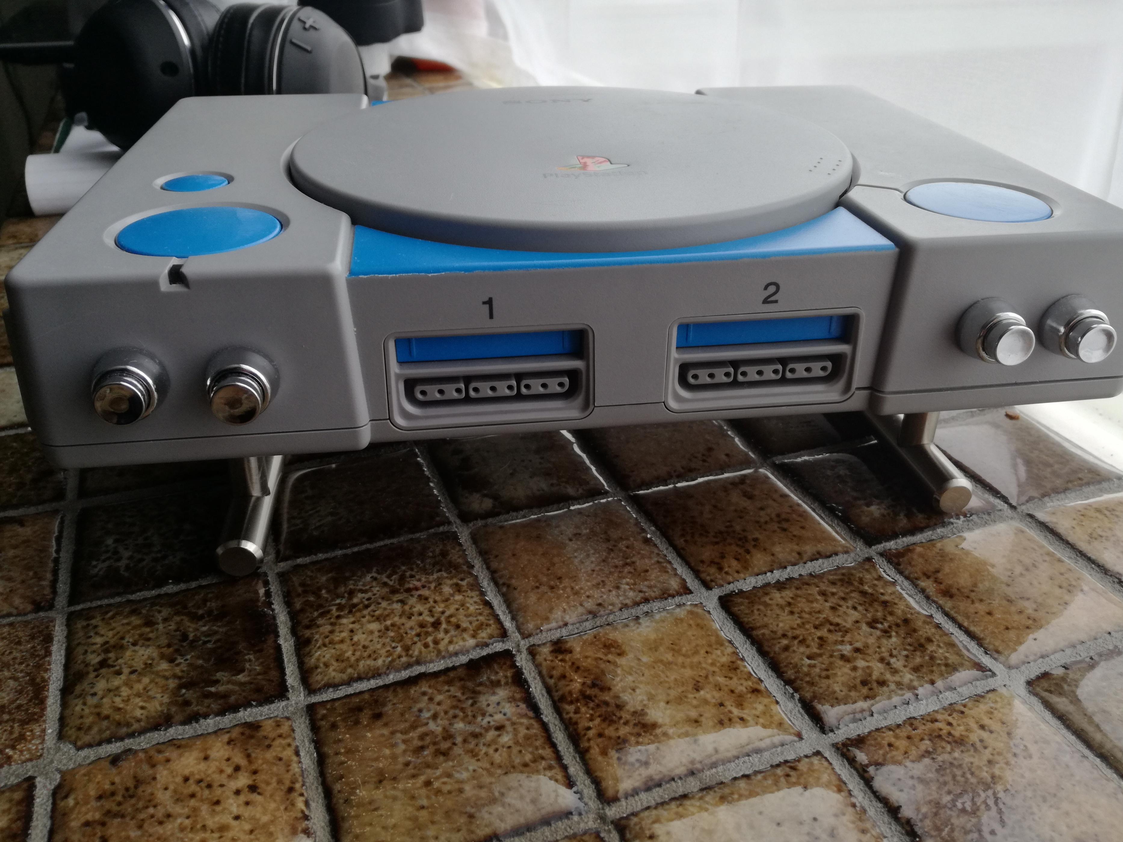

Long struggles and tribulations i managed to pimp my ps1. I did low pass filter / new outputs rca and added buttons via part of a controller internally
Everything works perfectly! However! I would like to also add a remote. Push buttons are linked on 2nd controller port. And if i plug in receiver for rc it will overrule controller port 2 / so then buttons dont work.
Or i can add the receiver to 2nd port (same one as the buttons are on) then they both work.. But gets mixed signals.. like it loops... with 2 devices on one port (controller + receiver) it will get double signals it seems. so pressing forward once will skip 4-5 tracks.... backwards same... which ofc makes the whole thing kinda useless
So my question is : does anyone know how to fix this ? has anyone modded the ps to both buttons and receiver. I would really like to but i dont know how its dont (yet)
