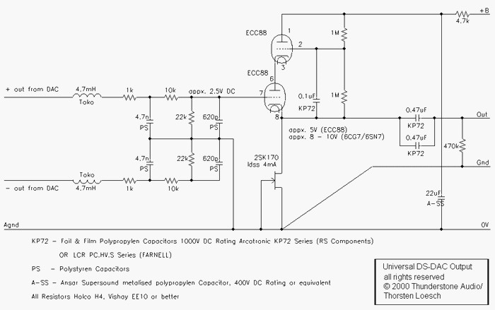

I would like to offer an update on my PS1 CD player project and also ask for some help increasing the gain from the tube output stage.
My CD player has been completed for a few months now and is sounding excellent through my single ended triode EL84 amp.The PS1 has a linear power supply and a 6dj8 output stage direct from DAC.The tube stage I used was posted in this thread it is by Thorsten Loesch titled "Thermionic Valve analog stage for digital audio".On the bench I noticed the RF filter at the input caused a bit of a drop in the already low output of the player so I opted not to install the filters,just a 1k resistor input.This sounded fine and I used it for months like this.That is,until I upgraded several components in my amp to make it much more revealing.Now the sound was a bit hard and Harsh,Or perhaps "grainy"would be a good term.I decided to add the RF filter.This made an obvious improvement.The CD player is now very smooth sounding and enjoyable.But Now I would like to find a way to get the output a bit closer to a normal CD player and would like to get some advice from those with more experience and expertise than myself.Ideally I could modify this circuit to increase gain?Or perhaps someone could suggest another?
Much thanks to all.This thread has been an incredible source for me.Enclosed is the schematic for the tube output stage(using only half of the balanced RF filter of course).
