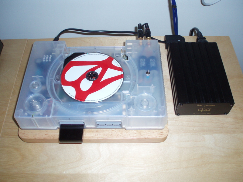

Found some Solen 3.3uF caps from a gutted pre-amp, and had some 22k metal film resistors in the parts box so installed these in the space between the metal cover, and the outer chassis, on the right hand side. Also installed some gold phonos at the back, also on the right hand side.
Worked first time thank goodness (been a while since I'd used it as a CD player) and sounds awsome! Will post some pics later.
Here it is. Bought one of those translucent chassis. Decided to remove the lid as one thing less to vibrate and disturb the laser tracking. Drilled a few holes over the PSU for some added ventilation. Will have a stab at Mick's PSU at some point.
You can just see the solen caps on the right hand side, by the cd TOC switch.
Power is supplied by an old DPA 'the power' mains filter - seems to work extremely well on digital sources, though I never like using filters on amplifiers as they seem to squash the dynamics.
VERY happy with how it's sounding - thanks MickF and to all others here for such a fab project!
