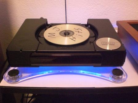

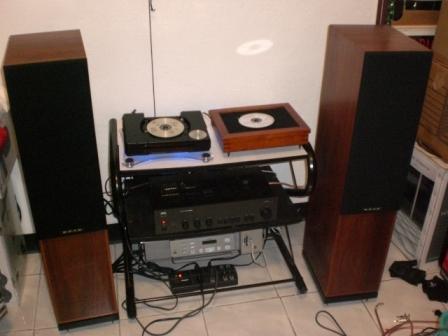

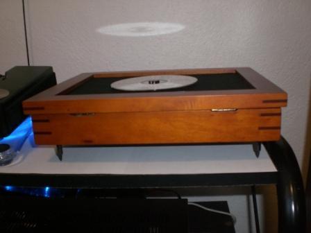

I just wanted to thank everyone for sharing thier ideas and solution on this topic!.. I had no knowledge of the internal componets in an electonic and how it works until I came to this site..
It took me like a week to read to most of the post but I understood what I had to do.. I bought my first PS1 1001 model on ebay for $17.. which I think was a steal because it was perfect inside came with controller, power cable, and AV muti out cable..
I followed Mick's direction (Thanks Mick!) on his site and was finish with the ps1 in less then a week (need materials). Later I found a picture frame around my house which I later use to case my ps1.. I wanted the ps1 to match my speakers =)
My friend later gave me his ps1 same model for free and when I compared to the one I modded, I was shock!.. Huge difference!.. I am now making another one for my mom..
