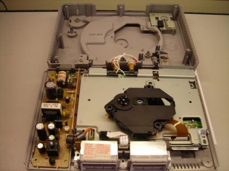

Modding Model SCPH-5501
The Playstation 1 does not provide oversampling.
On a different note, I have modded Model SCPH-5501 using the exact same mods for Model SCPH-1001 with the exception of adding RCA connectors. It seems that this is actually the better model to mod since the laser unit is oriented further away from the power supply. Also, it just seems a lot more reliable and quieter than Model SCPH-1001. In fact, it seems to play CD-R disks better.
I would be interested to know from others who have modded both models if they feel Model SCPH-5501 is the better model.

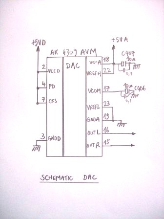

Hello,
The output stage is different from the 1002.
The powerstage to the DAC is also different.
The PCB is totally different.
I power the DAC each, analog and digital from outside with 2 shunt regulatedpower supplys...THAT !!! is an enormously upgrade!!!
The output direct from the DAC with an capacitor 10µF,
a little resistor 47 Ohm in series and a load resistor 100Kohm, NOT 22 Kohm.
Thats the best result that i have.
I have the CORRECT schematic of the DAC 4309.

sigurd said:I have the CORRECT schematic of the DAC 4309.
Schem. for the AK 4309 AVM or better AK 4309 VM?
Can you mail me?
post at nanocamp dot de
but not for the AK 4309 B ...

hallo,
next week I will set the CORRECT shematic off the 4309 AVM
here on audio forum.
I have not a system to set my drawnings here on the site now.
Yet next week, it will be OK. Please, a little patient...

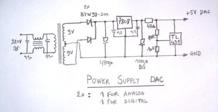

Powersupply DAC digital+ must come later than analog+.
On the SCPH-1002 the connections are not like that. They connect first analog+ and later digital+ with a resistor from 10 Ohm and a little interwindings and that is not correct. It is just otherwise, first analog+ and later digital+.
I connect two different powersupply's on the DAC 4,92VD and 5,02 VA and it's fantastic !!! I use TL431 for powersupply. It's schuntregulated. 😉 If you want the shematic, tell me, i will give it to you. It is not difficult to change the pcb for connecting different analog+ and digital+. If you do that you will have a fantastic sound...
If you are interrested, let me know, i will help you.
I have also pictures of the pcb how to do it.
IF YOU DO THAT, THE SOUND WILL BE LIKE A SUPPERBE CD-PLAYER!

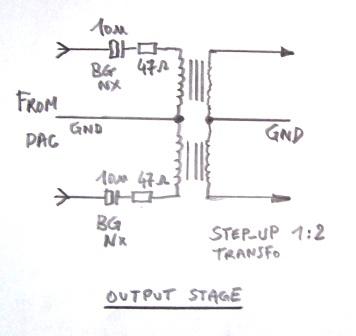

I use a transformer output stage, that's seems me the best, i have tried different possibilities.
Remember a little resistor is needed in series (47 ohm) to prevent vhf. So i use a 10 µF BG X and a little resistor 47 ohm for output and than a line transformer. The sound is amazing.

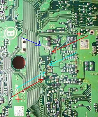

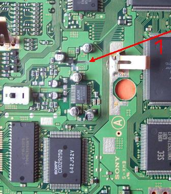

Sigurd ,nice job you have done !
I have a question for you. I'm trying to feed the dac digital and analog separately as you did, but with battery power.
So, after lifting the legs of 10 ohm resistor and a coil the VAnalog pins still measure 4.2V instead of the 5v ,is there something I'm missing here?
On the upside from the PCB, you must cut (scrath) were I marked
a red arrow ( this for disconnecting the 5 volt from the power
supply of the unit )
On the underside I marked a red arrow for connecting the 5
volt on the Digital + ( blue for the minus ) and a red arrow
for the Analog + ( blue for the minus ) . The dark blue arrow
is also for disconnecting the 5 volt from the power supply unit.
The red arrow + ( where is written (sony ) ) is for Digital +

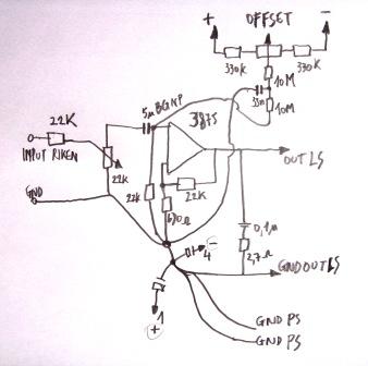

gainclone offset regulation LS
Hi, schematic for offset regulation LS on a gainclone :
the input volume control is a stepped resistor attenuator
( attention on connecting, it is as marked )
all resistors are riken
there is an offset regulation for the LS output
