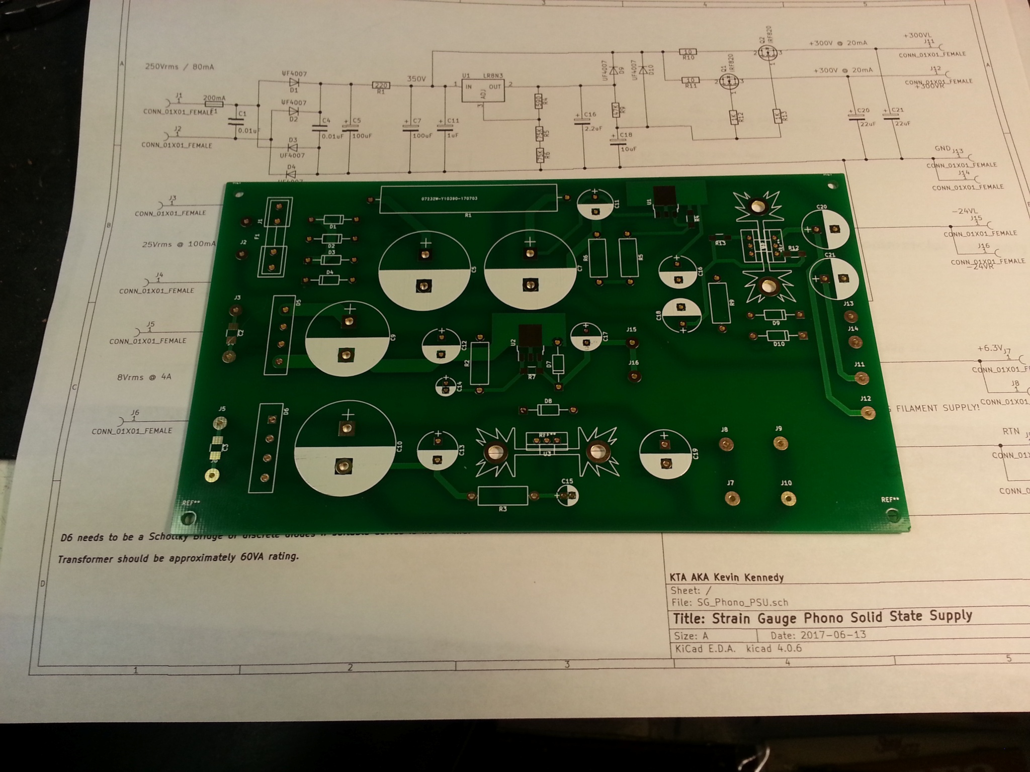

PSU BOM, SCHEMATIC
Here is a sortable BOM, the schematic, and the assembly drawings for the PSU board.
The boards are currently being fabricated and I expect to put together one in about a week to see how it all fits together and whether or not it works as I expect it to..

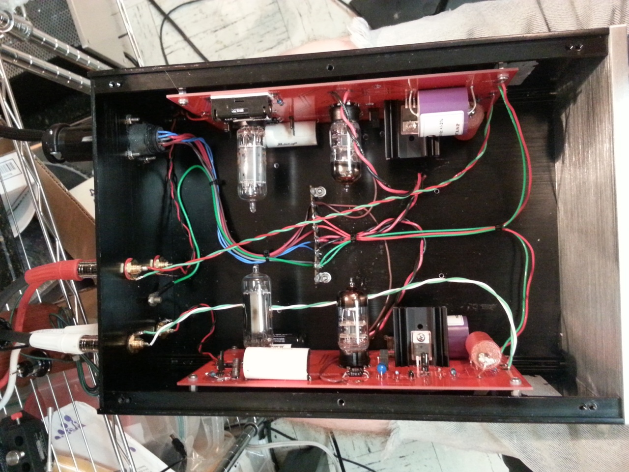

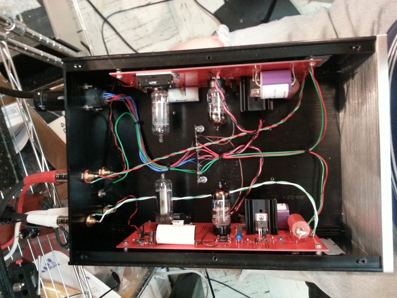

So this is what the retrofit looks like on the current PCB. Not nearly as bad as I imagined when I was thinking of the lithium coin cell based approach. (Note that I am not offering these earlier boards at this time due to the admittedly minor fix required to sort out the CCS.)

Here are the updated files for the pre-amplifier boards..
A BOM and a pdf of the current schematic are included along with screen captures of the current PCB and schematic.
Most of the parts are available from DigiKey, Mouser or Farnell. Most items are commodity parts, but I do recommend purchasing high quality film caps for the audio path and board decoupling.
PCB tube sockets are readily available on eBay, the foot print will accommodate a wide range of modern and classic (Amphenol) sockets, some minor lead bending may be required.
The LSK389C is a SOIC 8 pin SMD device, do not buy the A version, and expect to tweak the value of R20 and possibly others if you purchase B or D parts.
Q1, Q2, and Q3 are static sensitive. Use a grounded soldering iron and build in a static free an environment when installing these devices and related components.

The PSU boards arrive tomorrow. I plan to build up one next week and do some limited testing.

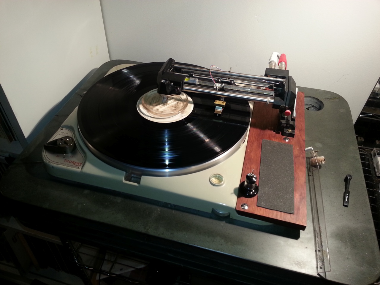

Here are a couple of pictures of the turntable with my 451CR on it, and the line stage repackaged in the old Muscovite Mini III, the old MMIII supply provides power to this unit.
I will be building up a complete pair of the new boards, and PSU in the next few weeks and the plan is to package them in a custom set of Landfall chassis.
This set up is getting a lot of use, and is quite enjoyable to listen to. The comparatively inexpensive and replaceable stylus makes it the logical choice for casual listening.

PSU PCB are in
No particular problems putting one together. On reflection I should have probably bought a taller heat sink for the filament regulator.
I apparently forgot to order some 1uF caps for local regulator decoupling. I figured they were optional but planned to put them in anyway. A comprehensive search reveals that I never ordered them - it must have been deliberate.. LOL

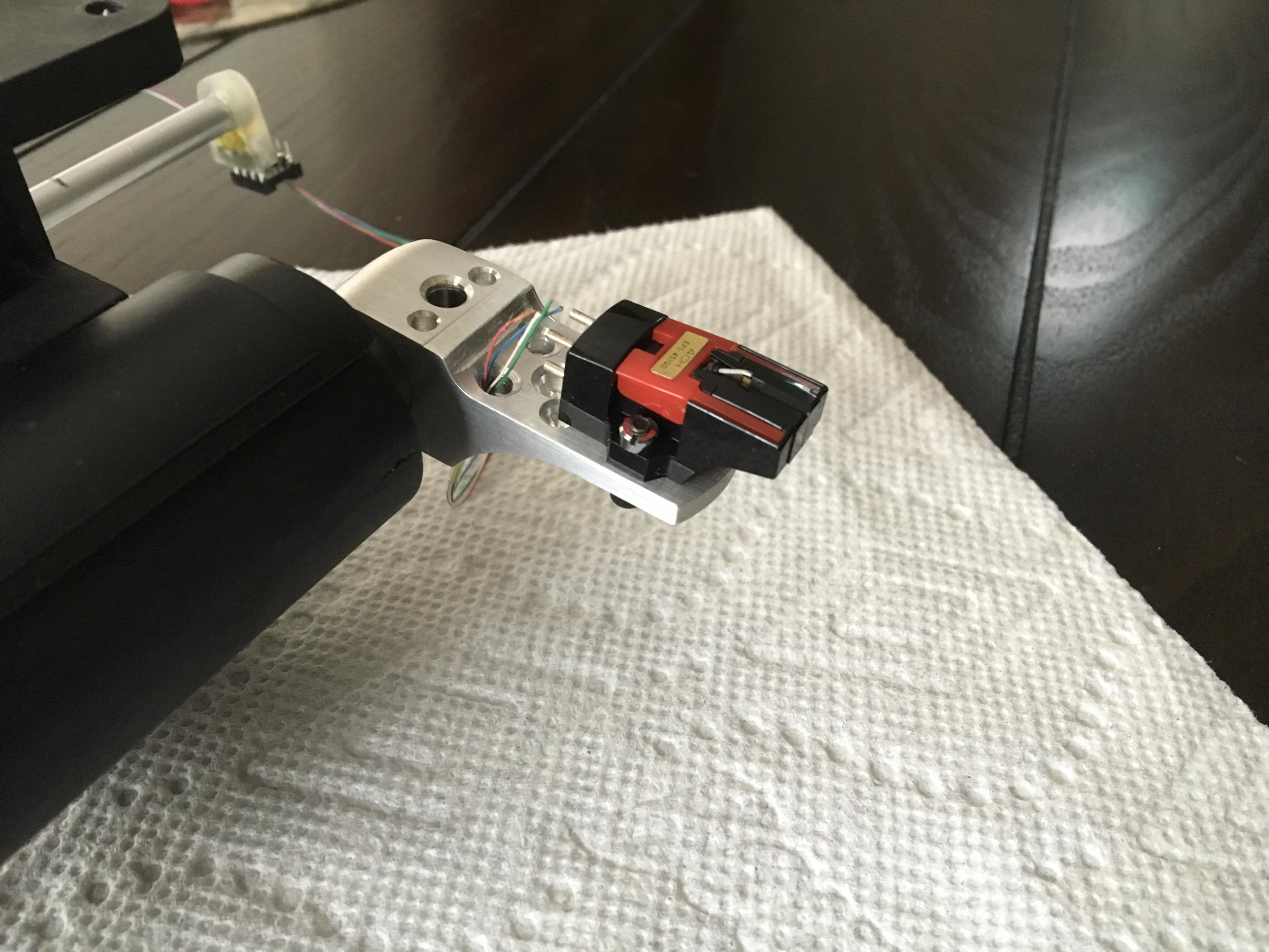

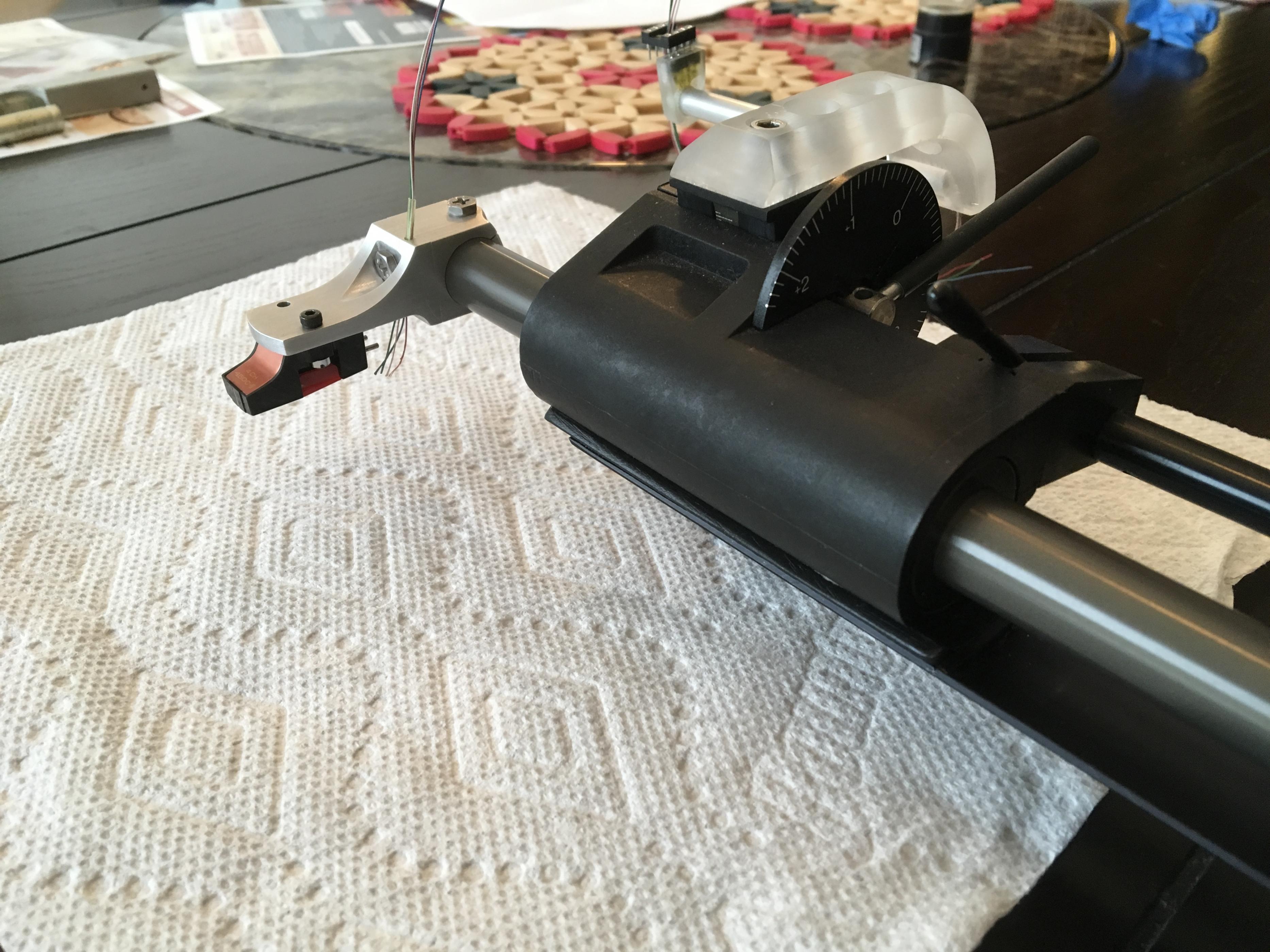

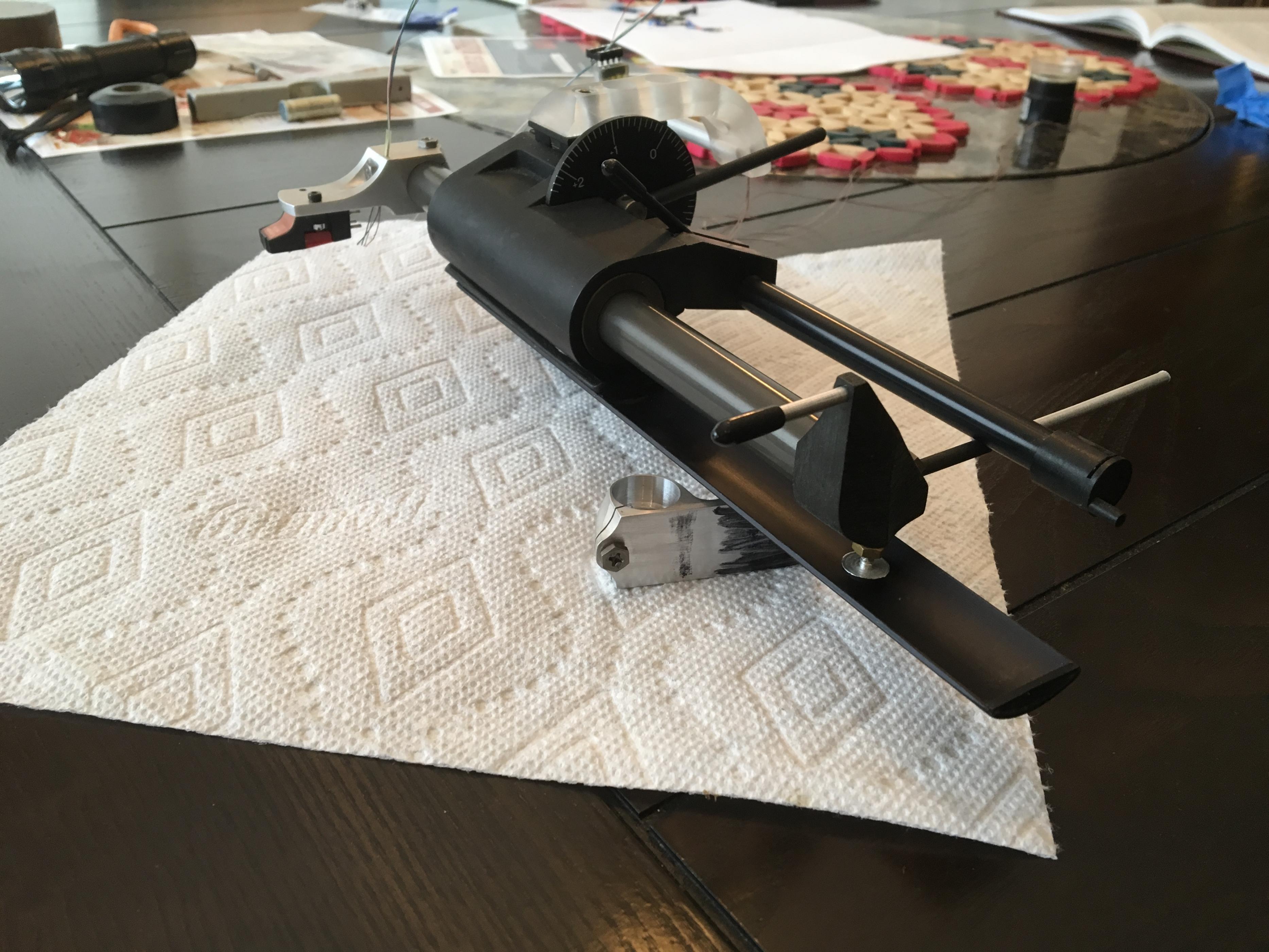

A few pics on a modified ET-2 air arm with silicone trough damping.
I machined a short pivot to needle (1.900") distance with azimuth adjustment to be used with a gutted SOTA vacuum platter/ new plinth design ( mandatory with these dims.) to eliminate warp/ wow issues.
Looking forward to the strain gauge adventure and will be comparing it against another standard ET-2/ 6" arm, Sota vacuum with Spectral reference MC, Sigma Genesis 2000, 1000, Winlabs lomc (2) not sg.., with a Cotter trans or Pearl 2 phono stage for reference sake
Its all good fun
Its all good fun

Interesting modification on your ET II arm, where is the counter weight?
Swapping the pins on the cartridge does not correct the phase issue with the strain gauge.

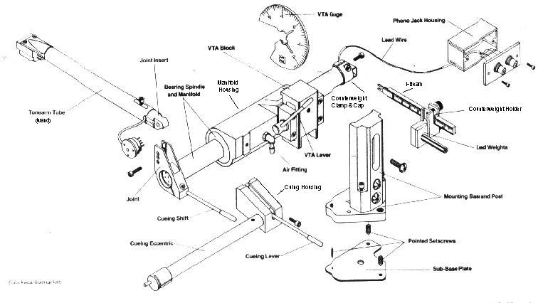

Here is a diagram of the arm. You should check out GTHICMs arm next time you visit. 😀
