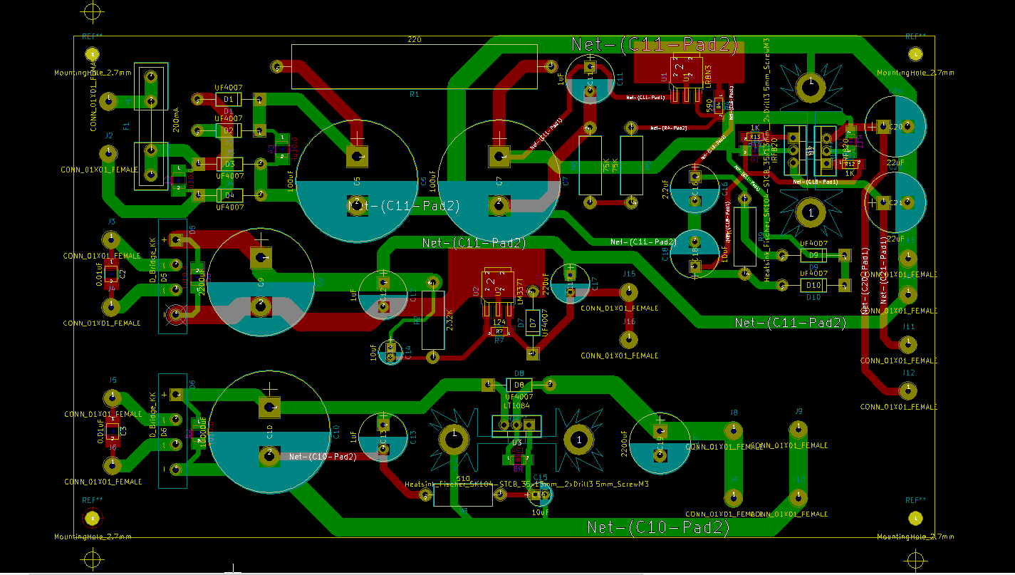

The PSU PCB design is complete. I will send it to PCBCart once I have had a look at my earlier handiwork to make sure it is OK.
A good friend sent me a 451C to experiment with so I will soon know how it differs in terms of performance from the later, lower compliance models I have here.
See a capture of the PSU PCB and the revised schematic for same. (Just a couple of component value changes.)

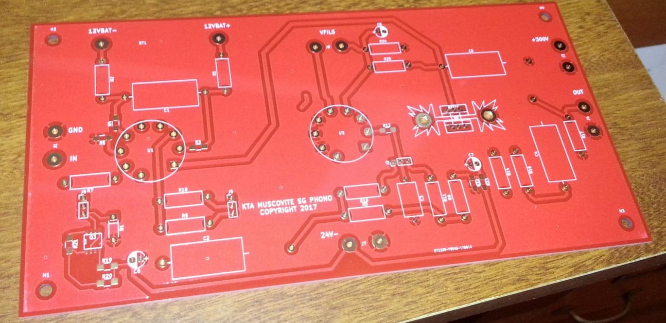

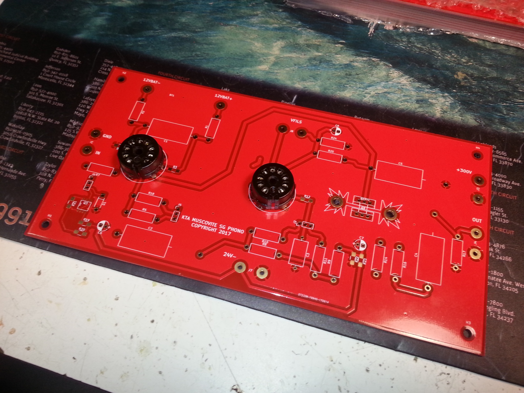

First Batch of PCB
Delighted to report they look really good, and no particular issues. Waiting for the bulk of the parts to arrive and I will start to build up a pair.

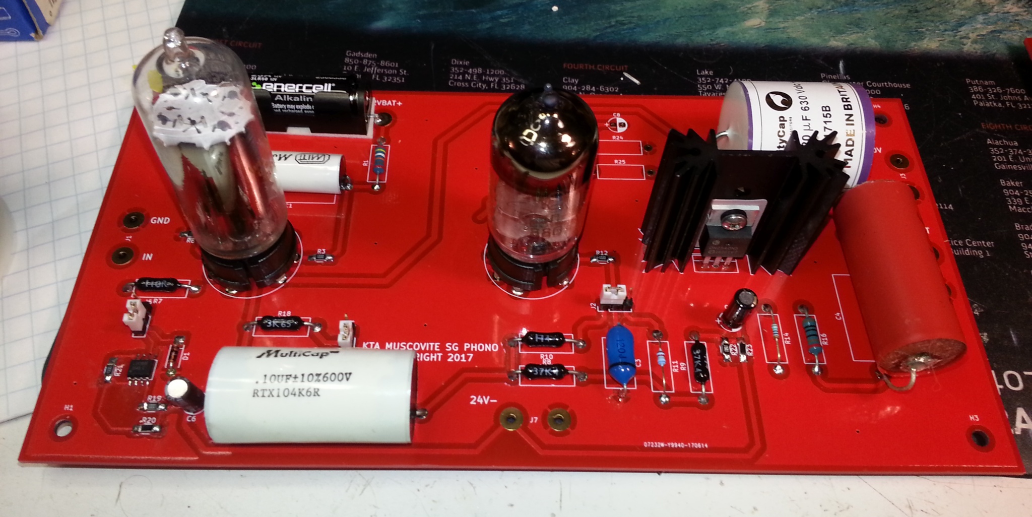

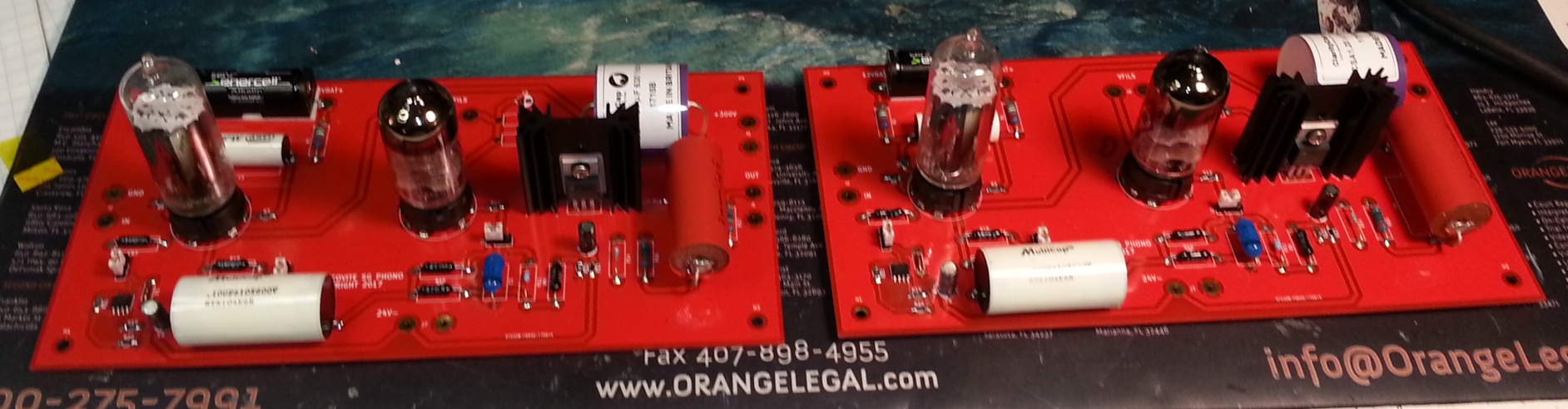

Big Update
I put together the first set of boards last night and this morning. I estimate about 4 hours to assemble a pair if you are experienced.
I started by installing all of the 1206 SMD resistors, there are a couple on the bottom and nine on the topside. Next I installed the two 10uF TH electrolytics on the negative rail, and then the LSK389 (soic package).
Installing the LSK389 was the most difficult SMD component to install and probably took 30 seconds.
Next I installed the sockets, and then all of the through hole resistors, the headers, and then the heat sink for the DN2540s. I used adhesive silpads which I installed on the heat sink first. Once properly soldered into the board I installed the mosfets, bolting them to the heat sink with isolation washers. Finally I soldered them in place.
Finally I installed all of the large film capacitors.
Testing over the next few days, if I do not encounter any significant issues during test/debug I will order the balance of the boards.

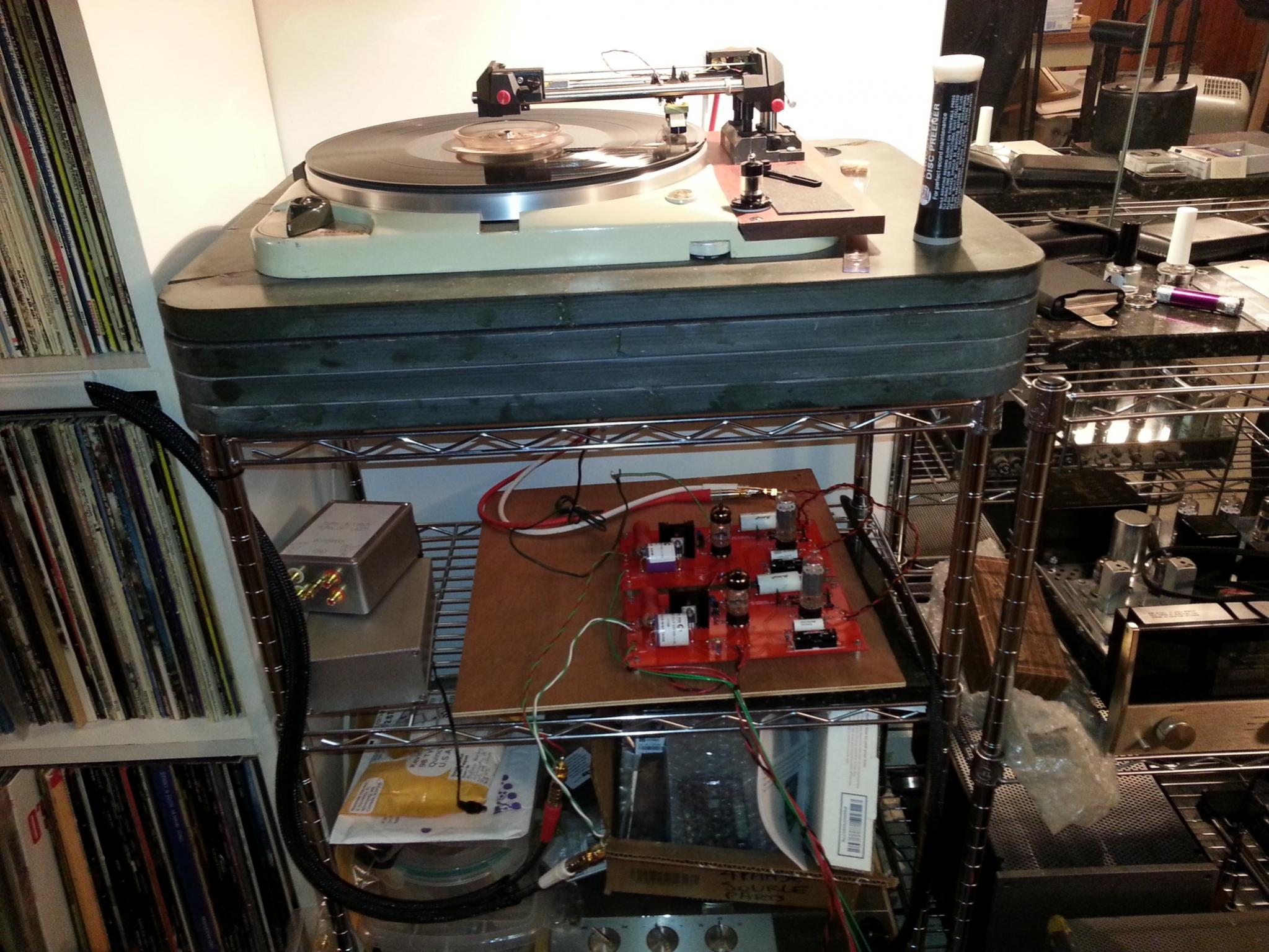

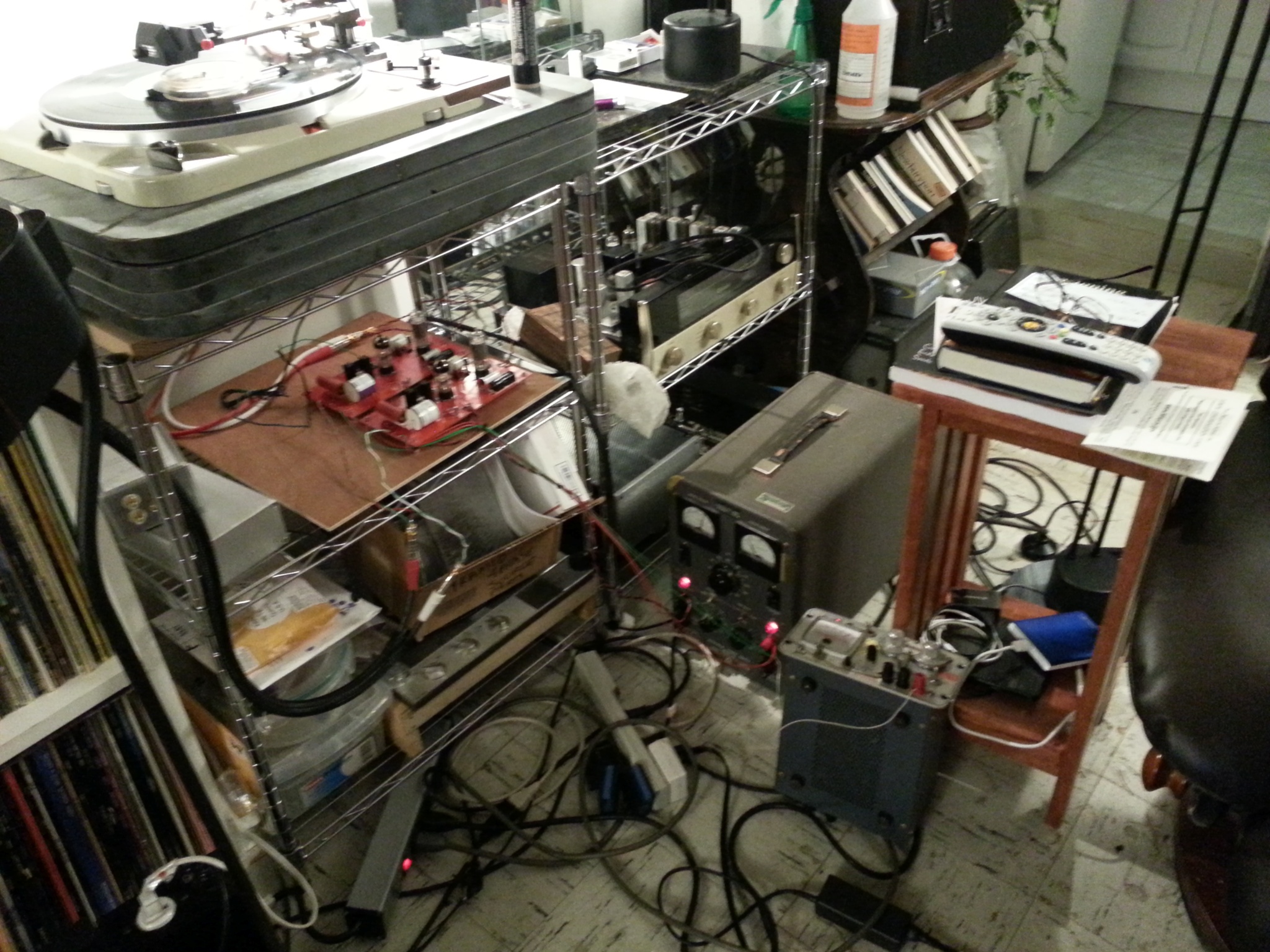

Preliminary Bench Testing / Listening Tests
Some preliminary testing and tweaking on the bench. My one area of concern is the LSK389, I have LSK389C and really should have gotten the D with it's significantly higher pinch off voltage. I am able to achieve a subtraction current maximum of 2.7mA due to the pinch off voltage of the fets which in hindsight might not have been the optimum choice for a cascode CCS. The D should provide the required margin, a potential improvement, umm involves 3V lithium ion button batteries, and then much less dependent on the gate voltage.
58dB of gain, and it's very quiet - surprisingly so considering I am currently heating the filaments with AC because I apparently don't have an appropriate DC supply any more. (Oops, broom swept too clean.. LOL)
The operating bias between the two channels matches to better than 5% with unmatched 6CG7 in my unit. Bias in the cartridge is ~4.8mA and 6CG7 operating current is ~7.5mA so the subtraction circuit is validated. Note that this results in an amplitude error between the two channels of less than 0.5dB.
The cascode DN2540 CCS/follower is operating in the target current range of 10mA and the heat sink with a thermal resistance of 8 degrees C/W in still air is only slightly warm after an hour of operation. No trimming should be necessary. Rise above ambient was calculated at < 15C, and currently running at about 40C. Comfortably conservative.
I'm pleased with the subjective performance as well, the improvements in the design I made over the original prototype seem to have paid off.

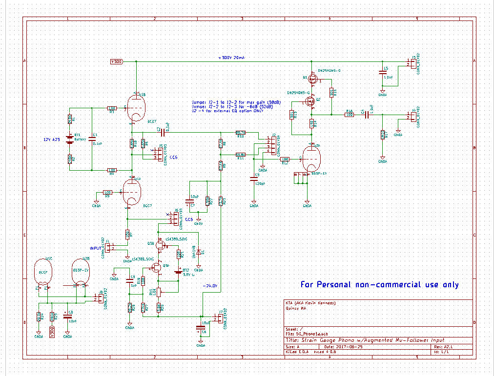

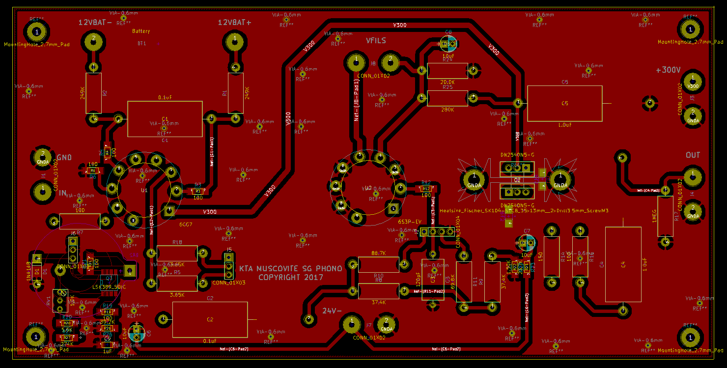

Design Updates
I've made some significant changes to the current subtraction CCS in the front end due to the fact that I failed to account for the low pinch off voltage of the LSK389 which limits the maximum bucking current to 2.7mA with the fets on hand. In addition the circuit could require some trimming of resistor values if B, C, D fets were used. (Type A is NOT suitable) I have added a 3V Li battery to provide bias (sound familiar? I'm going to be notorious) for the upper fet in the cascode which gets around the problem quite nicely. I've also added a pot to allow some adjustment range of the CCS, this will compensate both for the fets and moderate variation in operating point between the 6CG7s.
I was not able to incorporate an option for the through hole version of this part, there just was not enough space for the required pads with the other changes required, and I did not want to significantly change the rest of the layout where no issues have been identified. I did ground the heat sink for the CCS, and changed the routing for the filaments to eliminate a couple of vias. Some other minor tidying and more ground plane stitching as well (since it is free).
The current CCS actually works fine, but I am concerned about lots of people building this thing and having problems with the fets so I have added some additional flexibility. Some tuning may be required even so, but the adjustment range should be there for most fets likely to be encountered. Note I did consider substituting other fets for the LSK389, but the interesting thing is most of them are 6 - 14dB noisier and would probably require selection in addition.
Everyone is slated to get the improved board.
I have attached the new schematic and layout. I have increased the space for some of the film caps to allow the use of bulkier parts in some instances. (I expect most will use their favorites and "make" them fit.) I will provide recommendations based on what is working here.

I've been conferring with Scott W about the issues with the subraction current CCS design, so stay tuned as there will be further updates to this aspect of the design before the board spin.

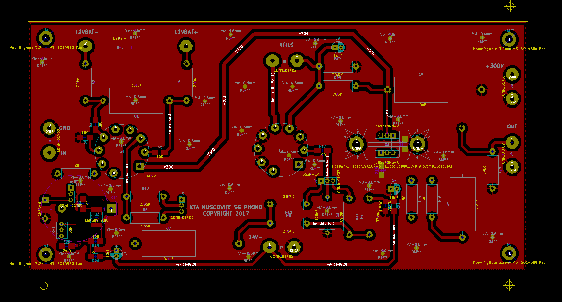

Power supply boards are ordered. Some updates to the audio pcb will be forthcoming, and once vetted I will order those too. Now on to the power transformers.
I have incorporated the design approach Scott suggested for the current subtraction CCS. It now also provides some possibility of compensating for fet and tube variations without necessarily having to swap parts. (It will depend on the fets you get of course, if the are similar to mine no adjustment will be required, if not one resistor will need to be changed.)
J2 now has a 4th pin providing a GND connection in the event that an outboard EQ network is desired for use with some as yet unknown strain gauge cartridge that requires different EQ.
The prototype has been tested with 451C, 460C and 465C - good results with all with the default EQ.
