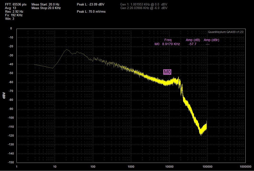

Scott and I did a couple of quick measurements today on the strain gauge, bearing in mind that we could not do synchronized frequency sweeps we elected to use the pink noise bands off of one of his STR test disks.

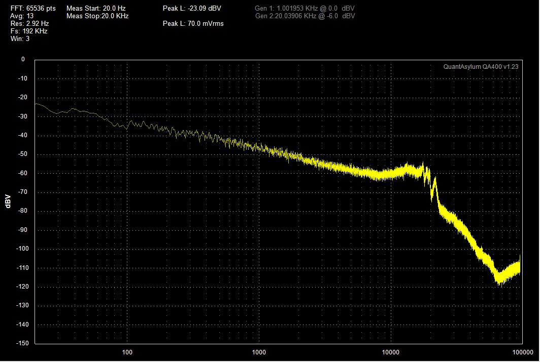

Bearing in mind that the pink noise amplitude falls at a 10dB per decade rate here is a response graph showing the equalized response of the cartridge, considering what we knew about the response of the pre-amplifier we decided this was sufficient.
The equalized response is not flat but is a significant improvement over what the unequalized response would have been. (The equalizer reduces HF response by 4.5dB relative to 1kHz at 10kHz and almost 10dB at 20kHz.
It appears that some additional reduction below 100Hz might be worth considering.
We both agreed that it fell short of the Windfeld's performance to a significant degree which was no real surprise.

Very good, Kevin!
You didn't happen to record those, did you?
Also, in what ways did the Panasonic fall short?
Very good, Kevin!You didn't happen to record those, did you?
Unfortunately the QA400 cannot record and we did not do anything else. I could actually record it at some point with a little bit of work.
It just really can't compete on any level against one Ortofon's best MC cartridges, the Windfeld better in every way you can imagine, but it costs a great deal more. The SG is probably better than anything close to the price however.

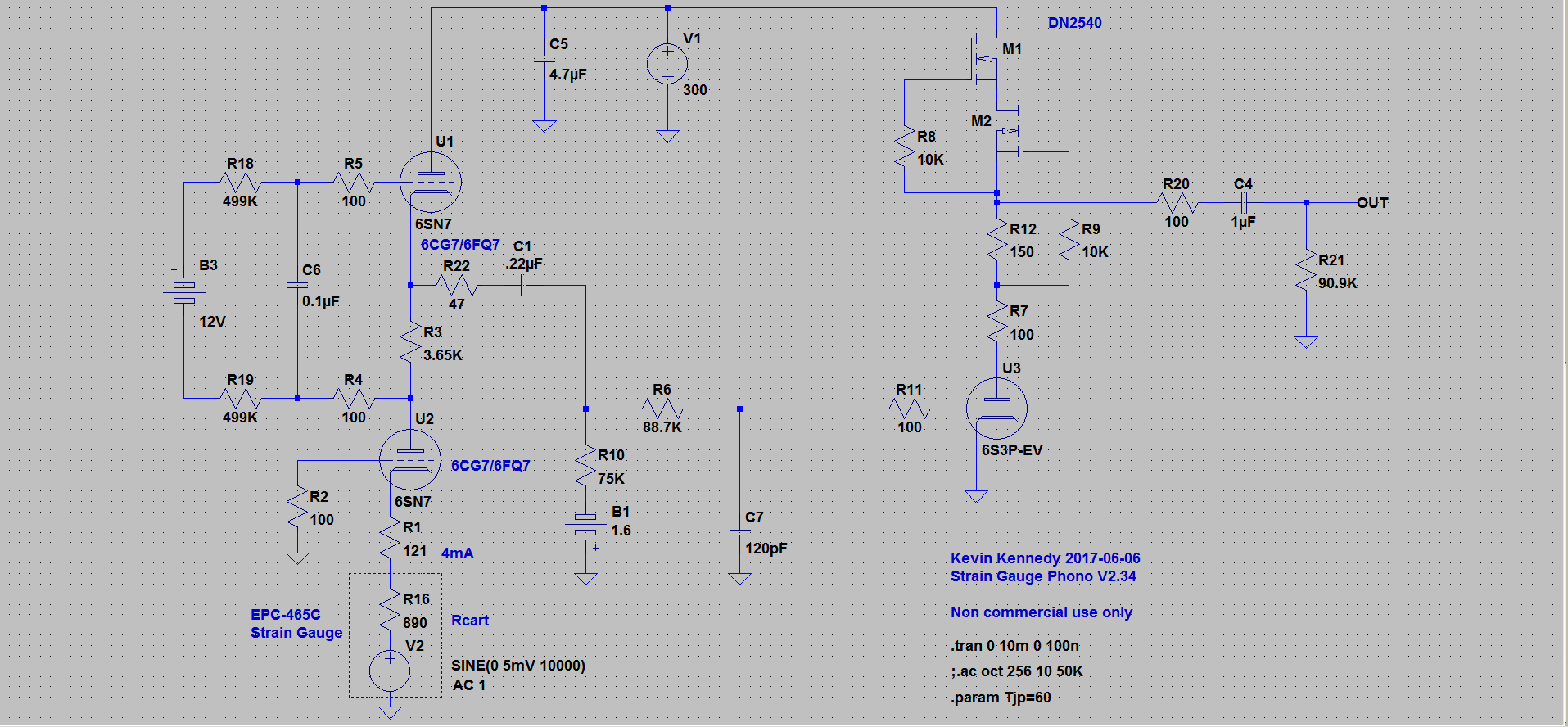

I am working on an improved pre-amplifier design which maybe pushes things a bit further or not.

Here is a post of the direction I am currently going. This eliminates the battery biased DN2540 hybrid mu-follower circuit and replaces it with a standard cascode CCS/follower.
Note that the simulations with improved DN2540 VDMOS model indicate there is some potential for oscillation in the cascode CCS hence the 10K gate resistors. This may or may not be real. Given the signal levels the SNR impact of those resistors is minimal. I have not tested this variant yet, currently designing a PCB that will have it.
Note those who need less gain could sub a lower mu triode for the 6S3P and adjust the bias voltage accordingly. Also 6SN7 can be used directly for first stage, and 6J5 for second stage if desired.. (Adjust bias in second stage to about -6V)
