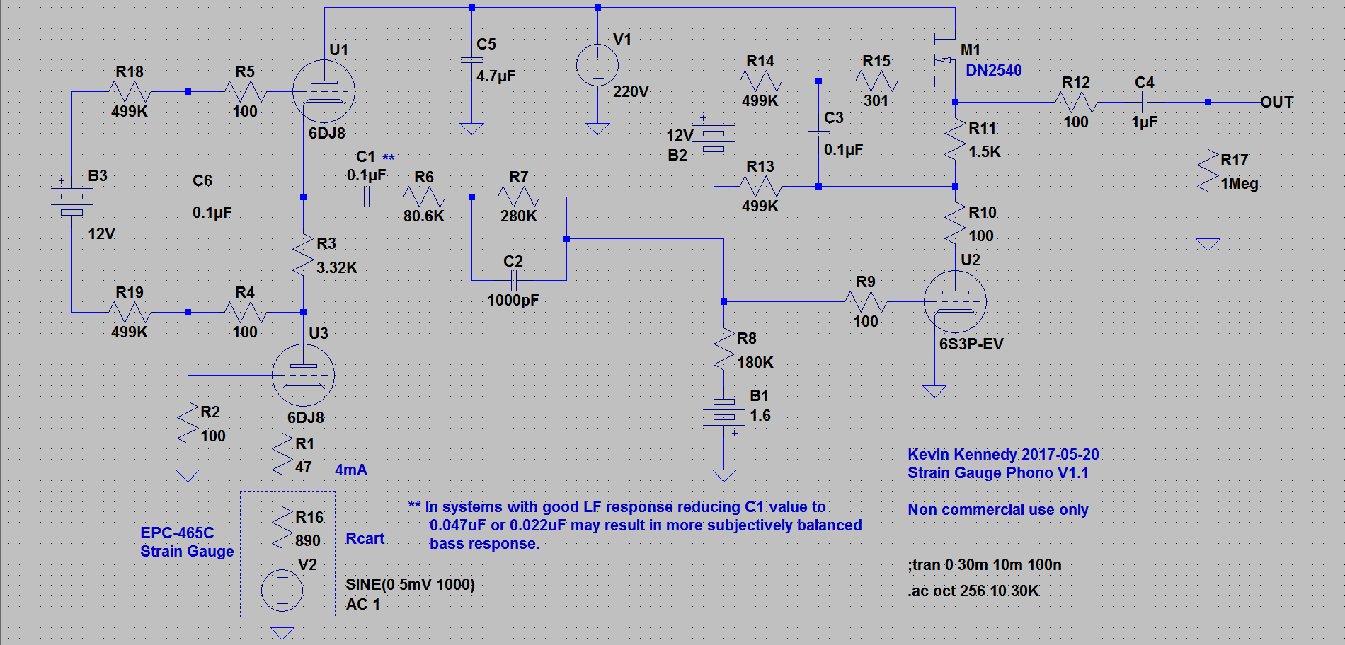

Here's the score (and a new schematic with trivial changes) - I am often reminded that some A23 batteries add an objectionable coloration to the sound which I would characterize as a nasality in the upper mids - most noticeable on female vocals, which as luck would have it is about 20% of what I listen to..
So I've added a little additional circuitry to decouple the battery from the audio path, this is two totally non critical (as to quality) resistors and a capacitor (where quality is important).
Russian surplus 200V teflon are applicable to at least the battery bypass. Type K72P-6 is what I used for battery bypassing in the first stage because it is what I had..
Most of the other caps are TRT Dynamicaps, the EQ cap is a REL PP foil. (tolerance matters - optimum results from about 920p - 1000p)
I am using Telefunken 6DJ8, I've found most Russian 6N23P to frankly not sound that great. I'd recommend modern equivalents from JJ..
I'm listening at the moment, sound is detailed, dynamic and well detailed without being obnoxious. I'm actually pretty impressed with this 45 year old cartridge.

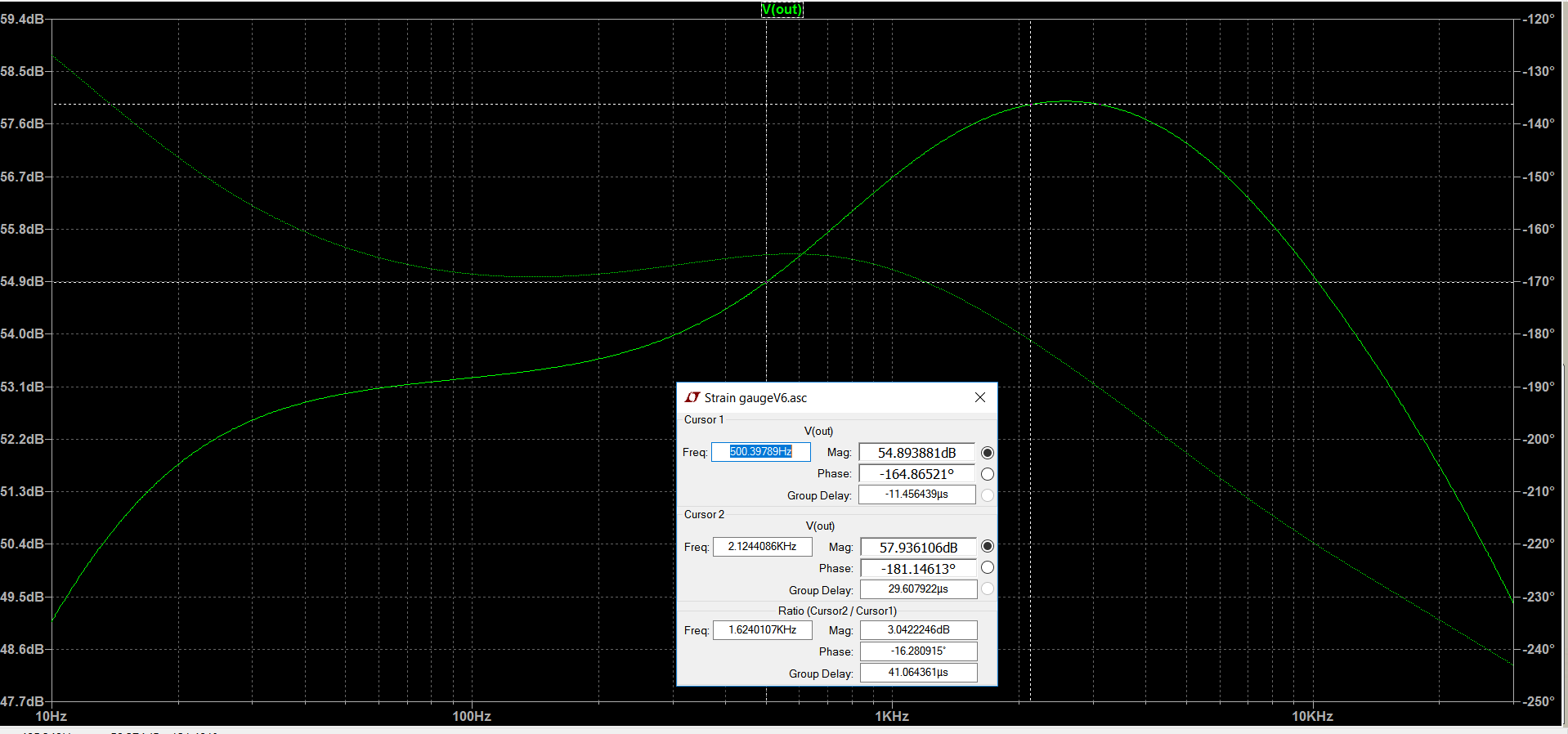

Note: If you have a system with strong bass response below 50Hz you may want to reduce the value of C1 to 0.022uF - 0.047uF to tune the bass response to your system.
Second response plot reflects response where C1 = 0.022uF (I am using this value)
Please see post #73 for current recommended design

Changed out C1 for a 0.022uF/5%/200V K72P-6, interesting while it did reduce
the overall bass response as expected (right for my system) it also resulted in somewhat
darker sound overall than I had expected. Seems in general to be a good compromise.

1. Your eq circuit in post #15 has 3.7 dB lift between 500 and 2.1k. But looking at your graph, in reality you have just a touch over 6dB treble boost from this circuit. I estimate around 4-6dB based on my listening tests, what is your target boost? It appears that we agree that theoretical boost of 12dB is too much.

Ideally I would have a rise of exactly 6dB between 500Hz - 2.12kHz. I've not mastered fractional pole/zero cancellation which would give me the ideal 3dB octave response I need. So I settled for some boost outside of the desired range which ultimately only gives me partial correction of the 6dB hole between the two RIAA time constants of 318us and 75us. Even worse is that the shelving boost adds a significant error above 2.12kHz which is substantial. I have a tentative correction which I will share in a following post.
All of this EQ is a swag based on studying the cartridge response curve and using conventional pole/zero, zero pole pairs to "improve" things. I am also not currently able to directly measure the cartridge/pre response, once some new test hardware arrives later this summer that issue should be at least partially resolved.

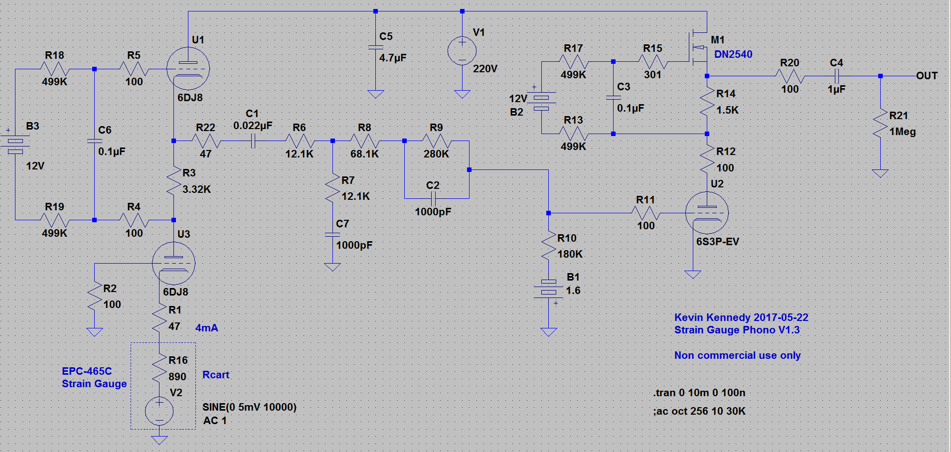

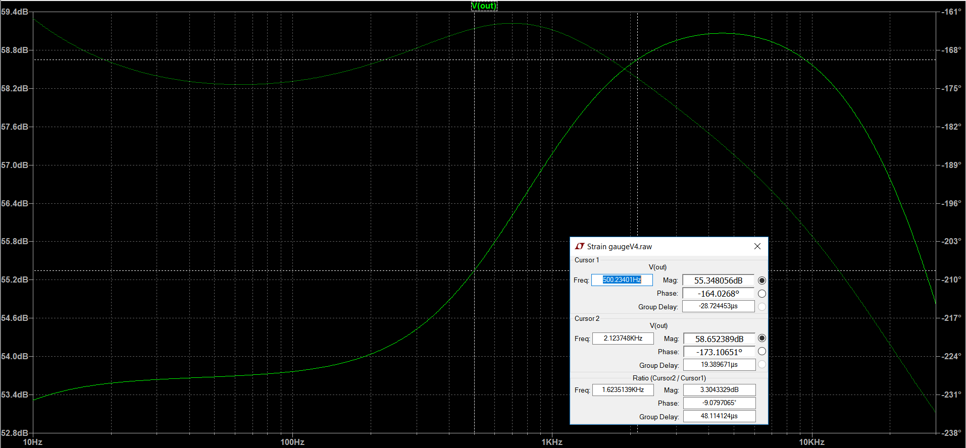

OK, I have to confess that the shelving HPF filter approach bothered me at some level. I kept thinking that this approach results in further boosting the already substantial response above 2.12kHz. Turns out in discussions with several engineer friends that this suspicion was well founded. I have come up with a minor addition that introduces a pole and zero to knock down the response a bit above 2kHz, about 3dB at 9kHz.
All of this is an approximation as noted in the previous post, but sonically seems headed in the right direction.
The danger to those following the thread is that the design will continue to evolve - mostly in the area of the EQ, and I have not got this fully down at this point. I do feel I am moving in the right direction.
Edit: Please see post #73 for an improved version.
