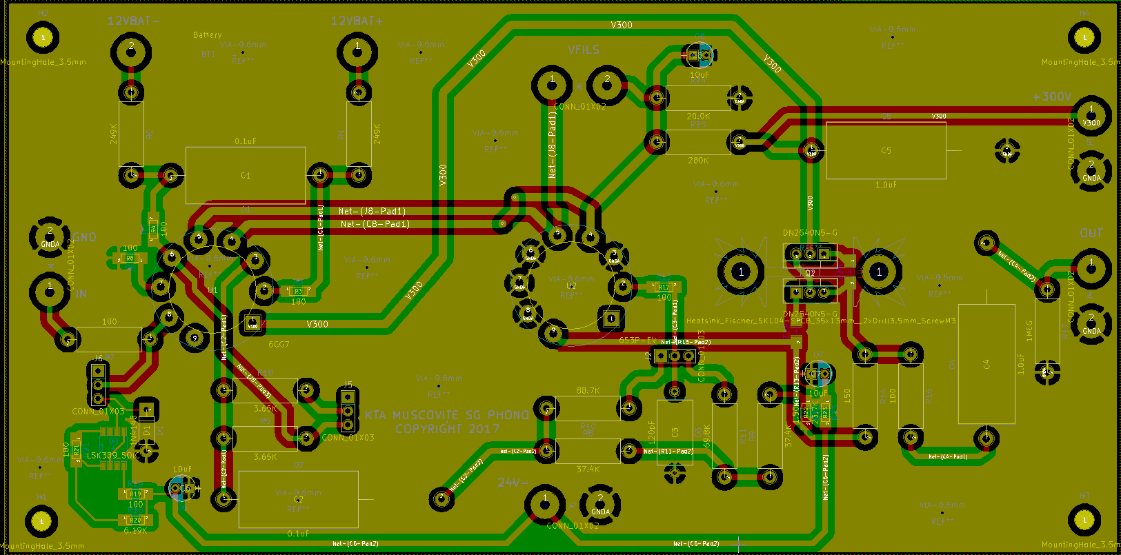

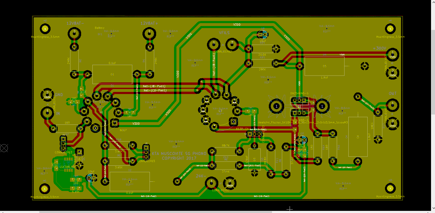

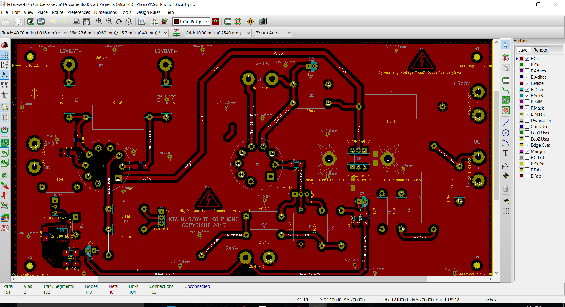

The attached schematic is reflective of the direction I am pursuing.
It eliminates two of the 3 batteries, but fully implemented requires an additional -24V supply which provides power to the input stage cascode CCS which subtracts cathode current allowing the amplifier stage to run at higher current.
In addition I have switched to a cascode based hybrid mu-follower in the second stage.
There may be further revisions, and there will be a PCB, the details of which I will share here.
The non-optimum gain distribution remains, ideally most of the gain would be in the first stage, but because of my disdain for the 6DJ8 I am forced to use a higher mu second stage to get the target gain (and overshoot the mark a bit truth be said).
The 6CG7 is not ideal in the application either due to rather low transconductance and modest mu, but given the cartridge source impedance the dominant noise source when everything is working correctly should still be the cartridge itself.
There are a few things I need to check and fix in the PCB design before I get boards made. If there is sufficient interest I will post the pcb files here once I know they are OK.

That's what we talked about, the values look good and that current source now should add only .7dB noise.
Yes, I was thinking about our discussion re current noise when I added that CCS. Will be very interested in your impressions when I finally get the next iteration built and tested. Planning to order the PCB in the next week once I am reasonably confident that I have not made a stupid mistake in the layout.
