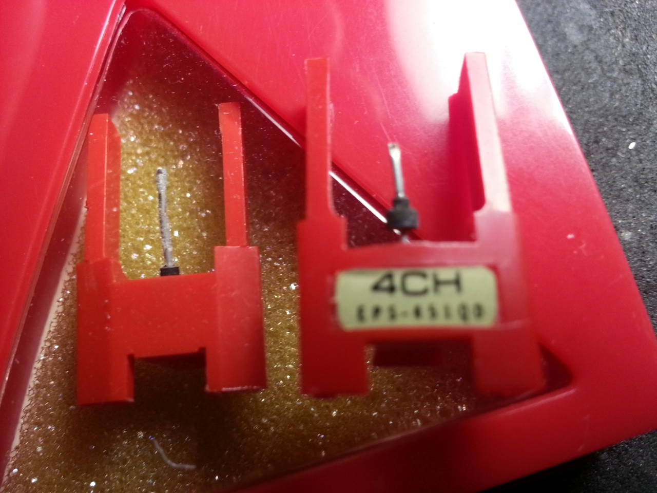

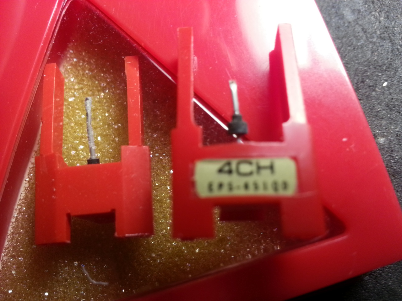

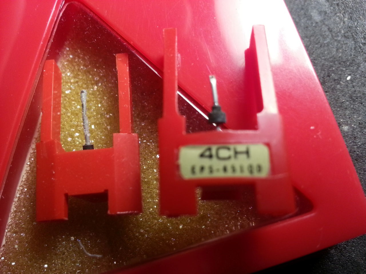

The BBAAADDDD Stylus
This is so bad, it's funny. An aftermarket stylus I bought on eBay. Got a bit less than I bargained for, in addition to lots of corrosion it is clearly missing a critical component.. See if you can figure it out..😀😀😀😀
I have asked the seller to return it, hopefully he will just refund my money and tell me to toss it. The box is pretty, and unopened.
Might just be better to go to turntableneedles.com for yours or your other favorite reseller.
You just can't make up things like this...
Other than the missing rubber donut that pushes against the SG elements, It belongs to another style of cartridge .

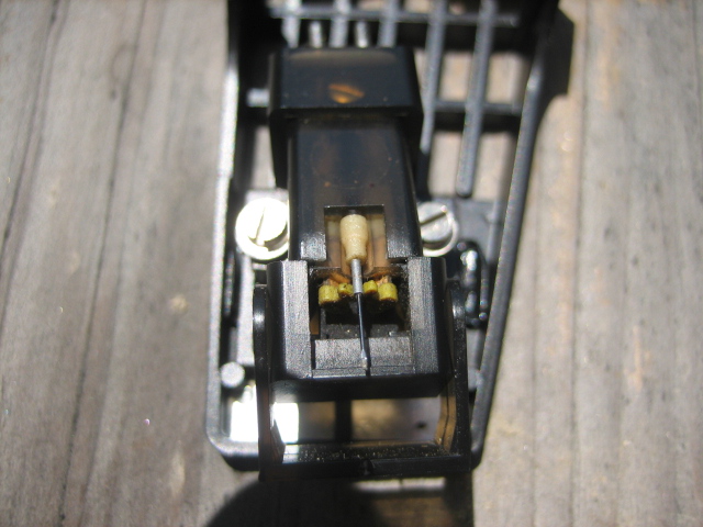

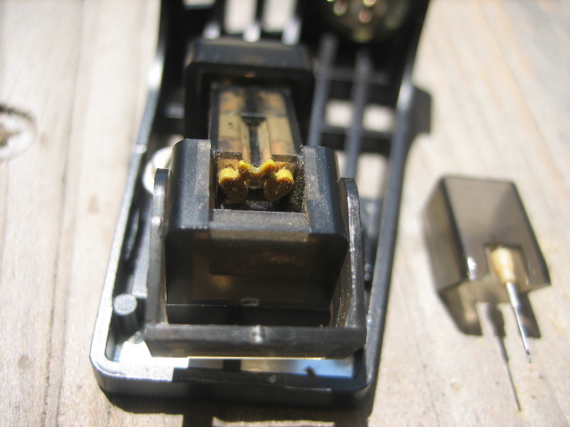

SO, that brings up an interesting point and one that I have been thinking about ever since I learned about strain guage cartridges.
I can visualize at this point what a moving coil cart and a moving magnet cart looks like with regards to the arrangement of parts to generate a current.
But I would really like to know how a strain guage is built. I mean, when I look at the Win Labs cart, I see a fairly generic looking rubber tube surrounding the shaft of the cantilever which then interfaces with a nice looking rubber yoke. The yoke seems to be attached to one end of each strain guage, there being two in total, one each for each channel.
Seems like a lot of rubber that is in between the diamond at the end of the cantilever and the device (strain guage) that actually produces the signal output of the cartridge.
I know its in effect a variable resistor across a bias supply and that is where the signal is derived from.
Anyway, just curious about how all this works and the mechanical arrangement of the parts that make up a strain guage cartridge.

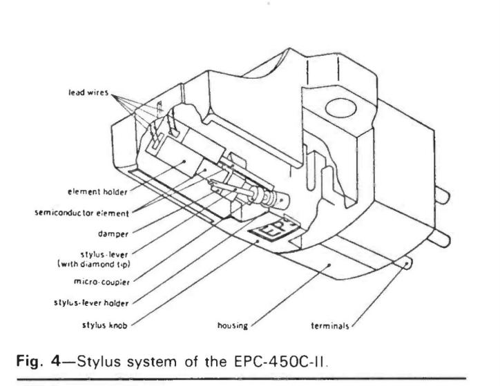

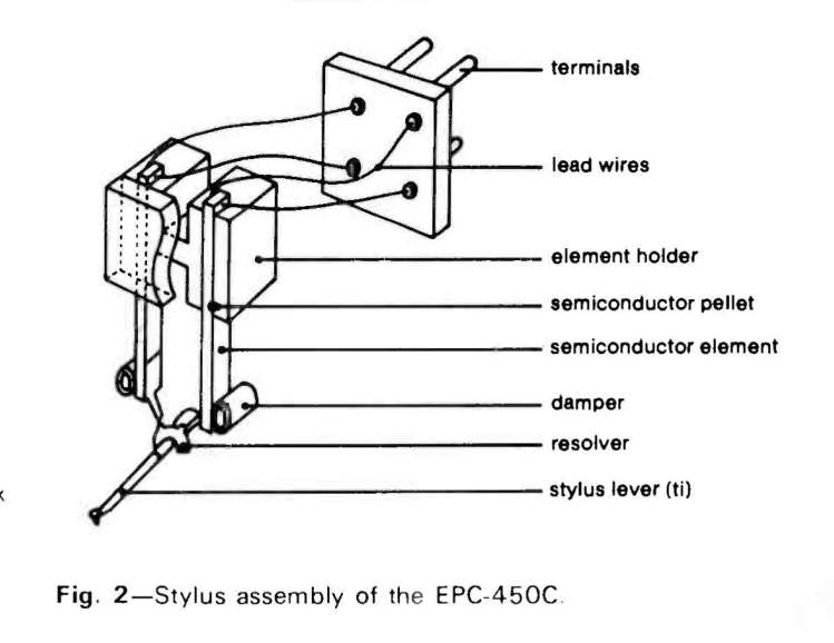

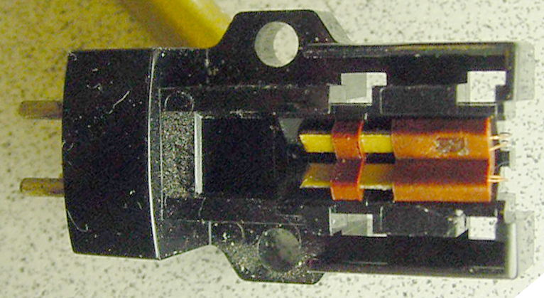

Take a look at earlier posts in the thread as I have posted the mechanical details of the Panasonic SG cartridges. I will repost here.
The 450C is representative of earlier versions of the strain gauge.
The 450CII is representative of the later 451C, 460C and 465C.

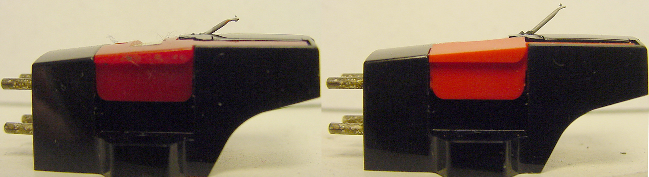

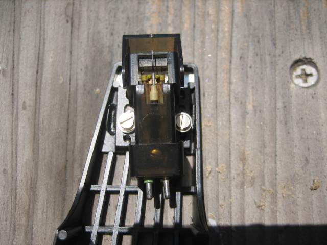

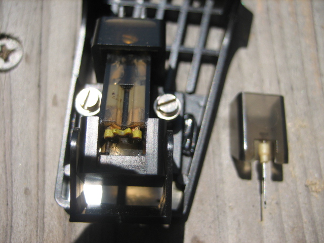

Here is a picture of an original Panasonic stylus next to an aftermarket that has an alignment issue. It is properly centered side to side so it could appear correct to someone who did not have a good reference to go by. How much VTA adjustment does this need?
It is also showing a ring of crusty adhesive around the bonded tip that I was told was the adhesive crystallizing as it was breaking down.
I am not sure what brand this was.
Interesting... The Win differs in some fundamental ways but no more than the early Panasonics differ from the later ones.
The pictures are great!
The Stylus issue is interesting. I don't like the NOS Panasonic ones (sample of 2) I have on hand that much, and the Jico while much better is outperformed by a no name mystery stylus I believe was made by Bliss.
It makes a pretty big difference. The biggest problem with the Jico is that it does not fit tightly enough. (Sample of 1)
The stylus really makes or breaks these cartridges, I don't think many would find that surprising.

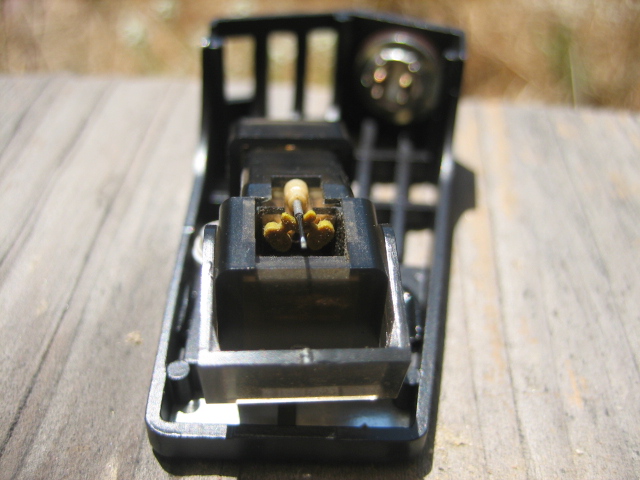

Interesting the Win attaches the rubber to the ends of the SG elements without the cantilever donut.
And the later Panasonics have the donut/cantilever pressing on the middle portion of each element.
Seems there is more mass (rubber) to be moved with the Win, but all things considered, Sao Win was the expert on so many other levels, I would consider it the best version to use considering his reputation.
Seeing how they are quite different in construction, I would image they vary in frequency-response between the design decisions
