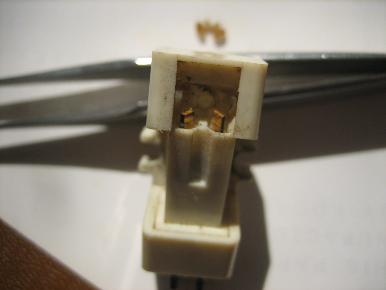

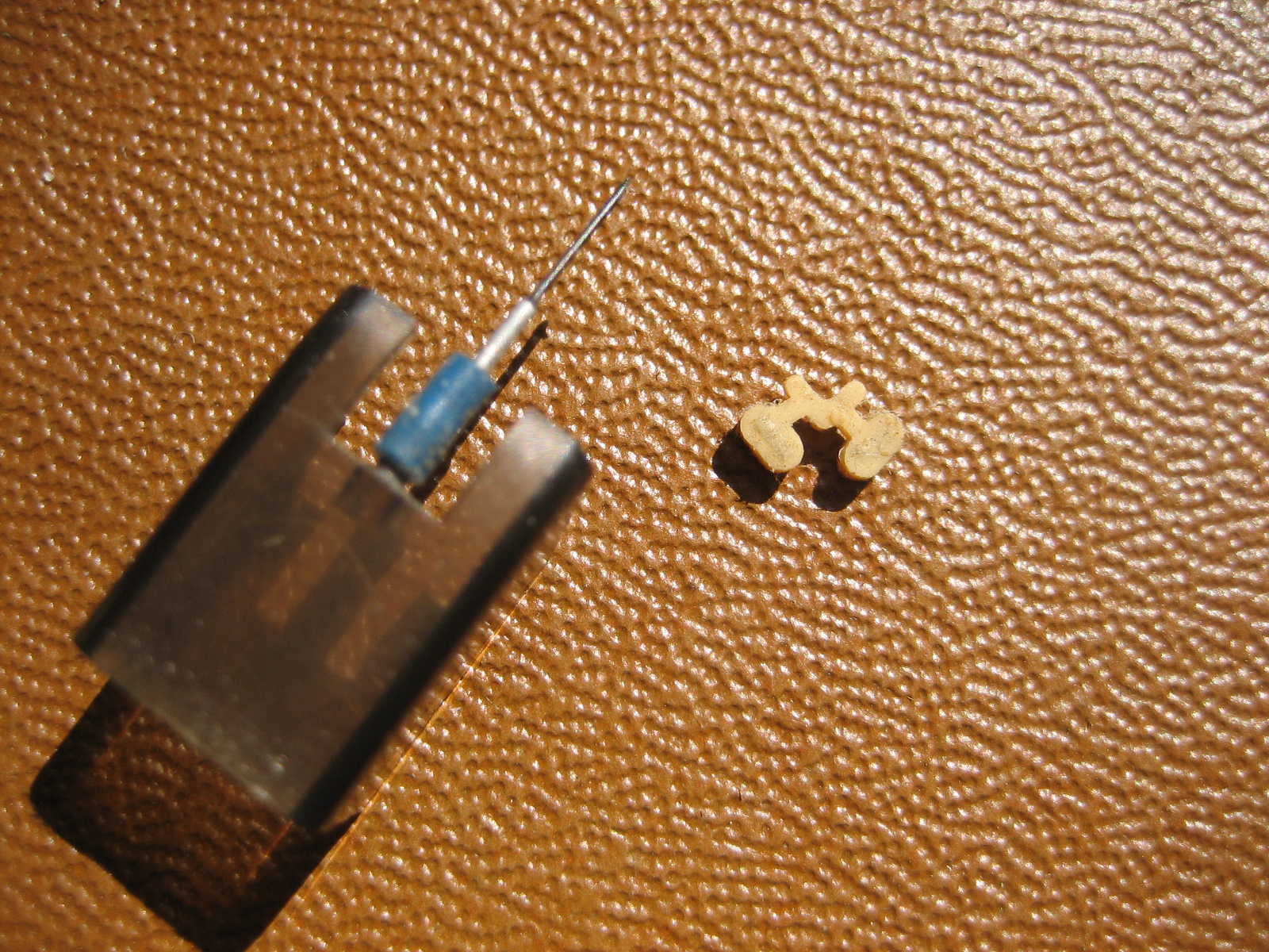

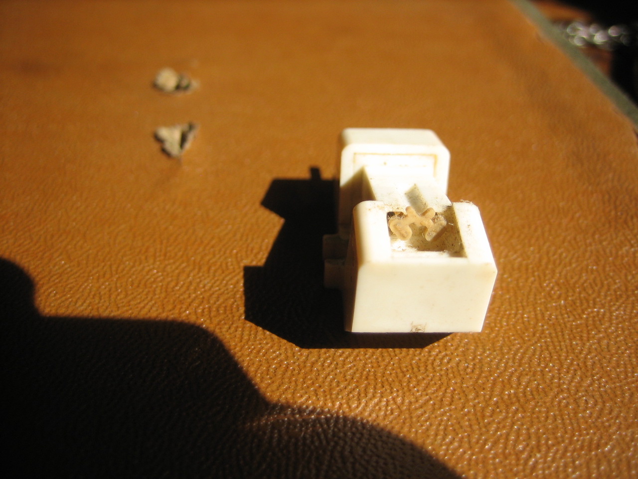

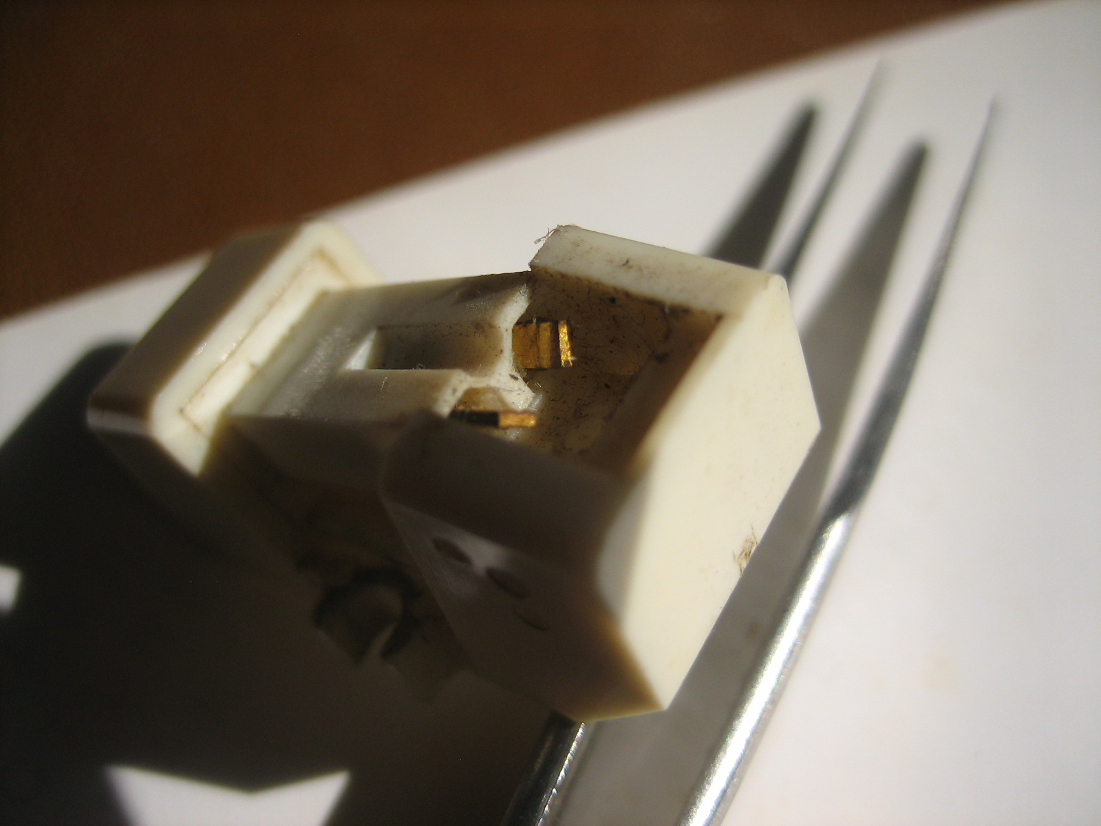

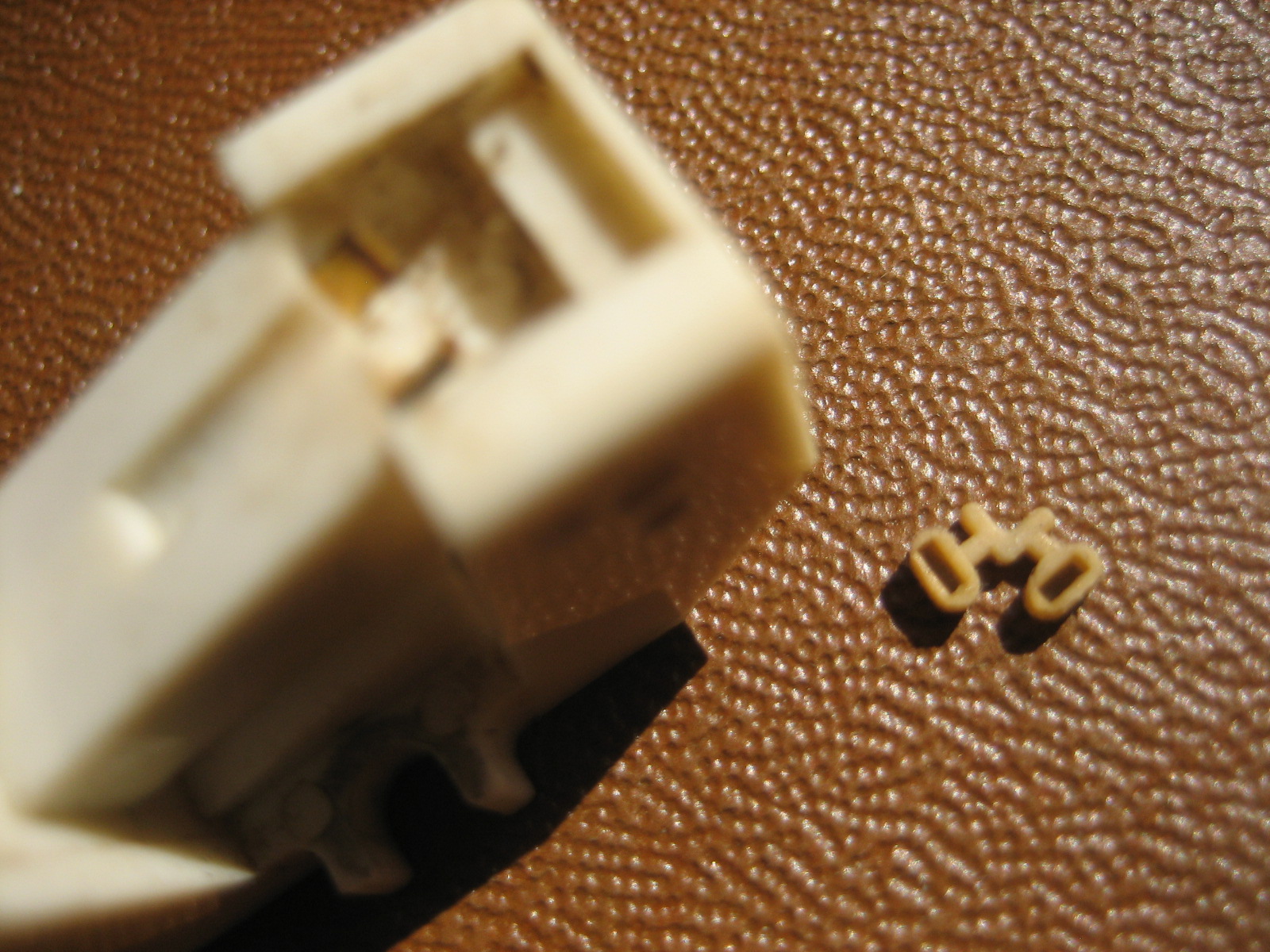

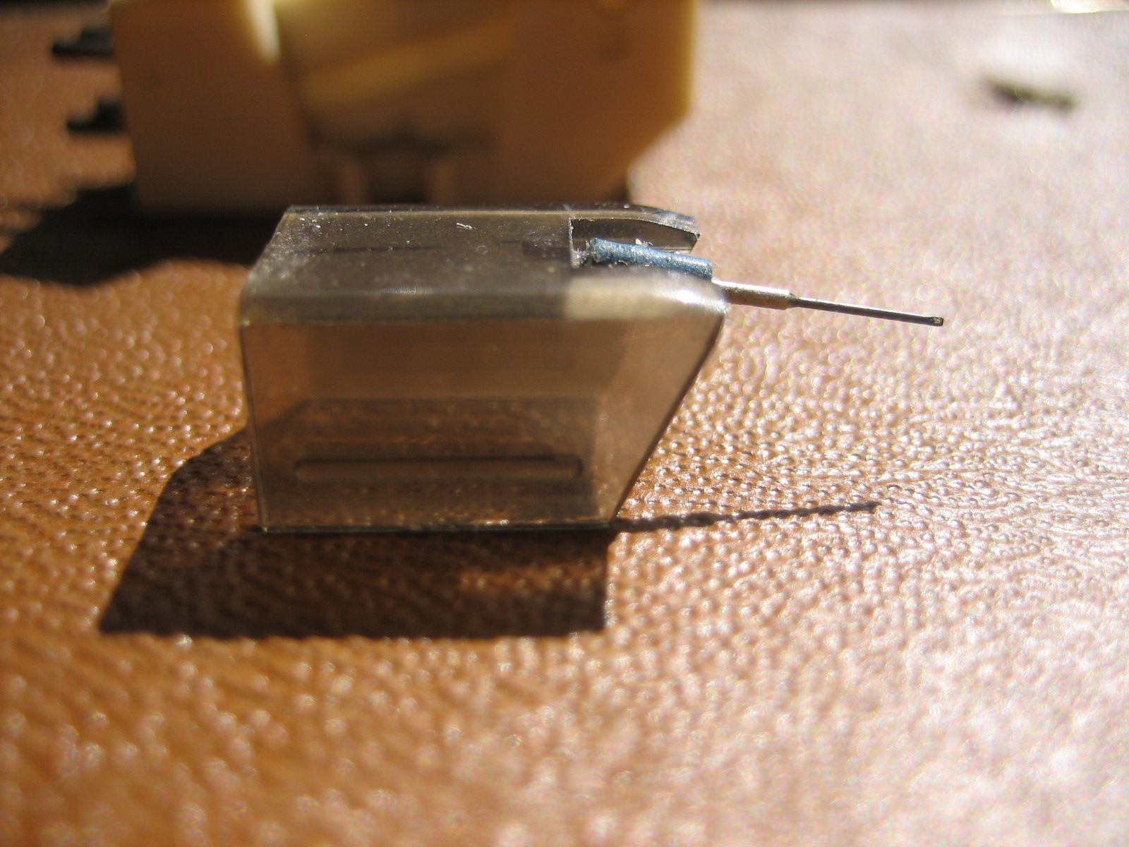

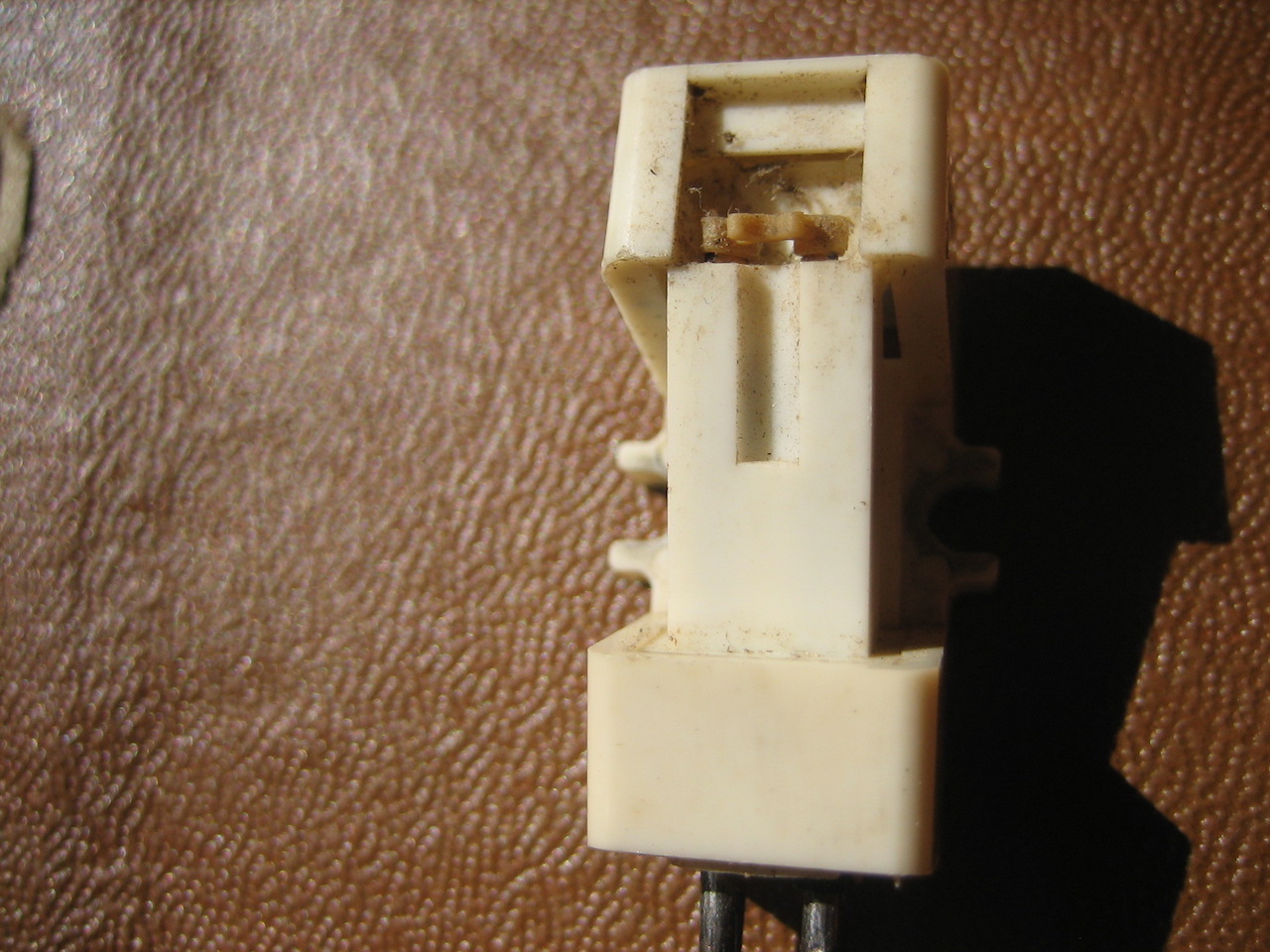

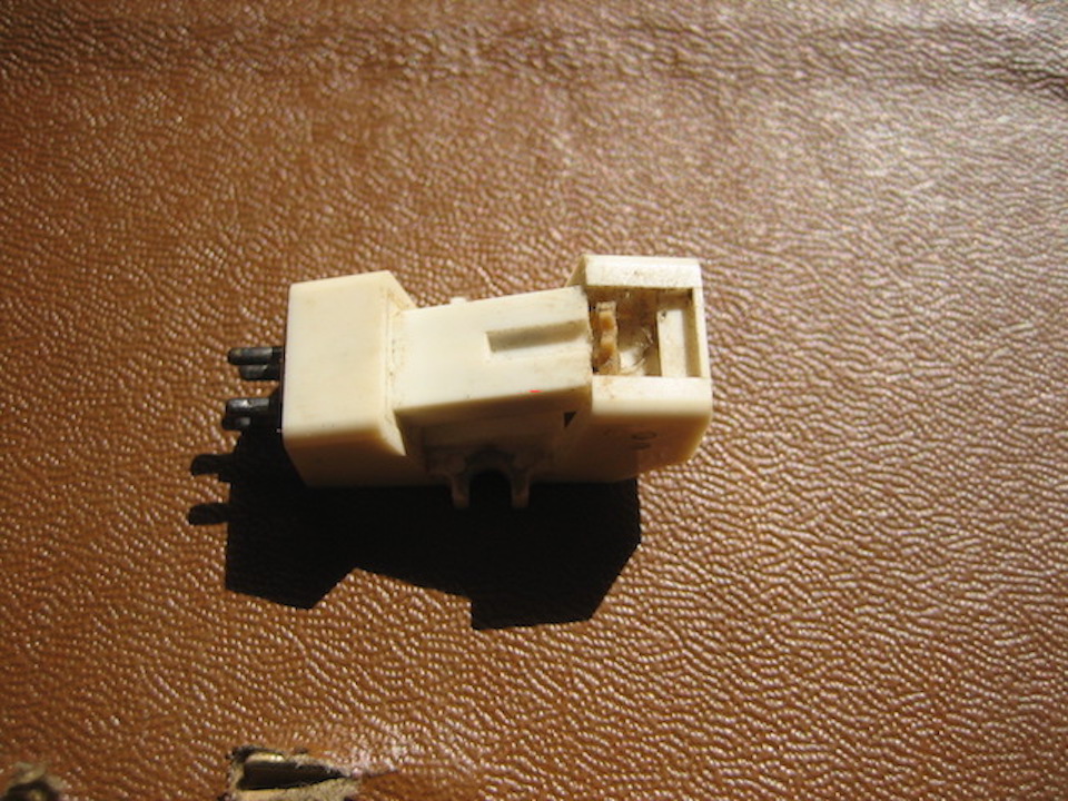

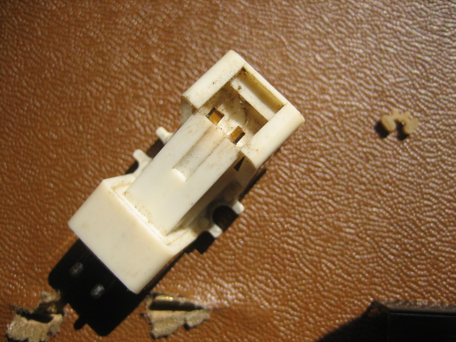

Here are a bunch of closeup photos of another Win Lab Strain Guage I have.
This one is at the moment unusable because the stylus fell out of the blue rubber device that is meant to hold it. Don't know what kind of adhesive to use but more important, don't know how I'm going to align the cantilever in the rubber holder so that it has the precise geometry needed for best performance.
Thats a problem for another day, for the moment, here are some pics.

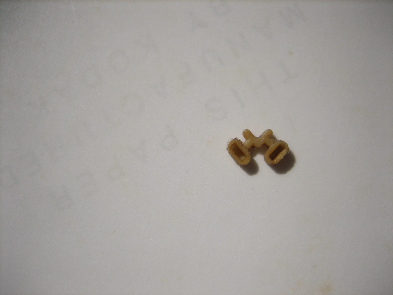

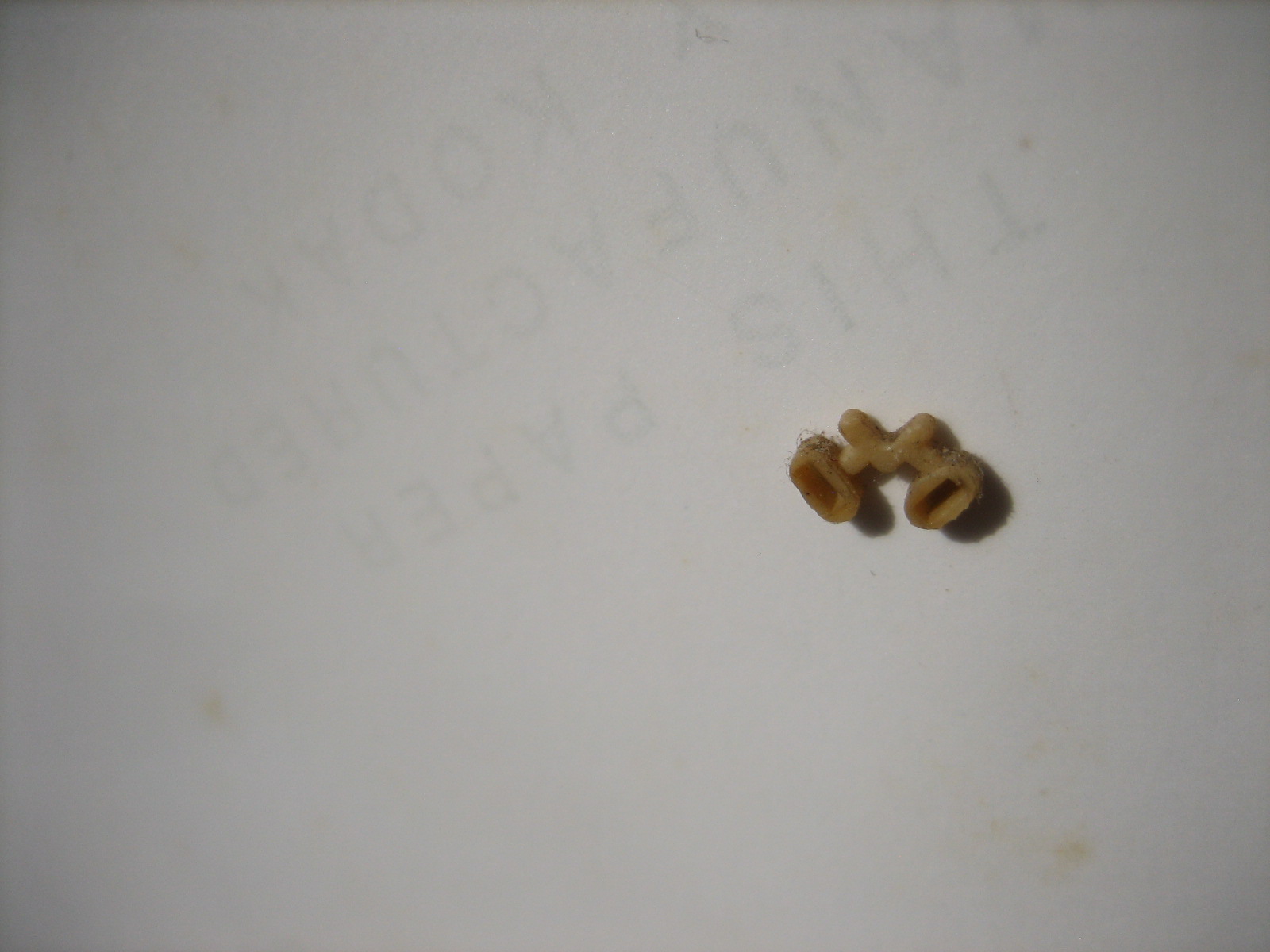

The all important Yoke. I watched Sao Win pull these off with a pair of tweezers when I would visit him in his shop in Goleta. He had a small container filled with thousands of them.

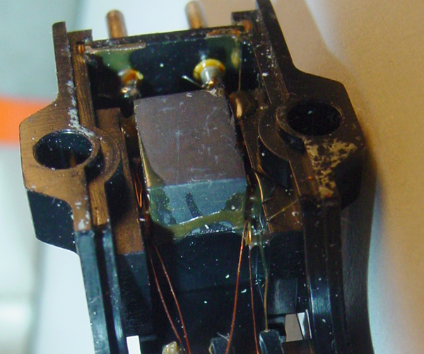

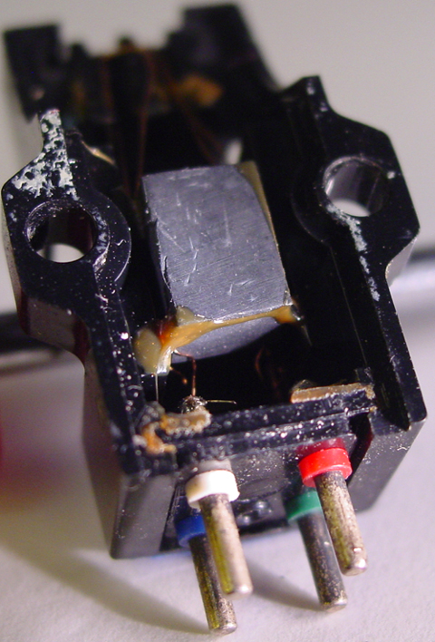

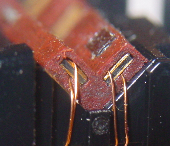

There is something I am calling a dampener block in it. I don't see the dampener block in the patent. At first I thought it was a simple weight.
It feels slightly like rubber boot sole.
The brown strain element mounts are very soft like cured silicone caulk.
Remounting could change things considerably.
