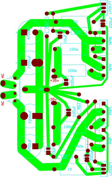

Looks much better.
The caps near the pass transistors don't need to be 220uF, they can be (should be) 0.1uF. The caps near the output can be as big as 1000uF.
MJL21193 said:Looks much better.
Are you talking about the ones that I added that are marked 47uF on the final schematic?
By the way, thanks for the photo!
