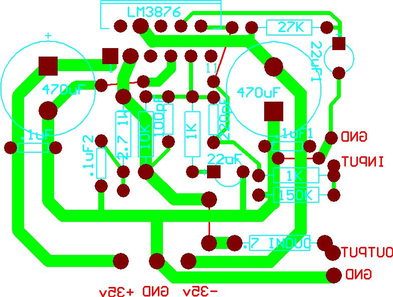

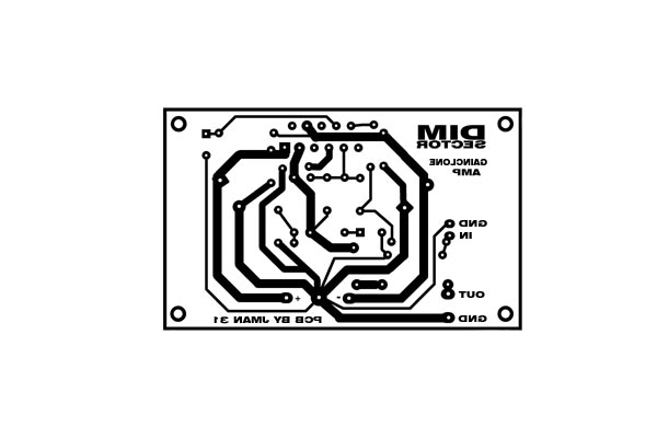

I have been working mostly on trying to get the amp PCB worked out, but I am going to tackle the transformer in just a bit. I will follow your advice and see how it goes.

In the layout keep input and output as wide apart, as you can.
The output traces could use more flesh. The current that flows there is more or less the sum of the current in the supply rails.
The output traces are not consistent with the schematic. The speaker should be connected to the other side of the 2,7 Ohm resistor.
The mute capacitor is connected properly.

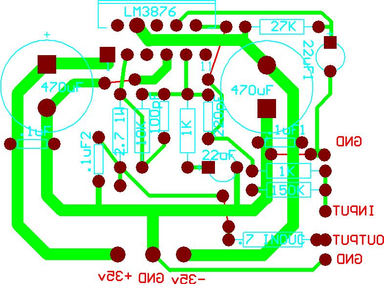

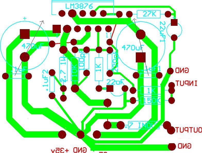

You have shared the rectifier current path to the bulk storage caps with the input ground and output ground. This is likely to cause hum.
You also should move the 100n caps closer to the amplifer there is no point in having them the far side of the bulk decoupling.
See modified layout below (done in Paint so I am sure you can do a much tidier job.)

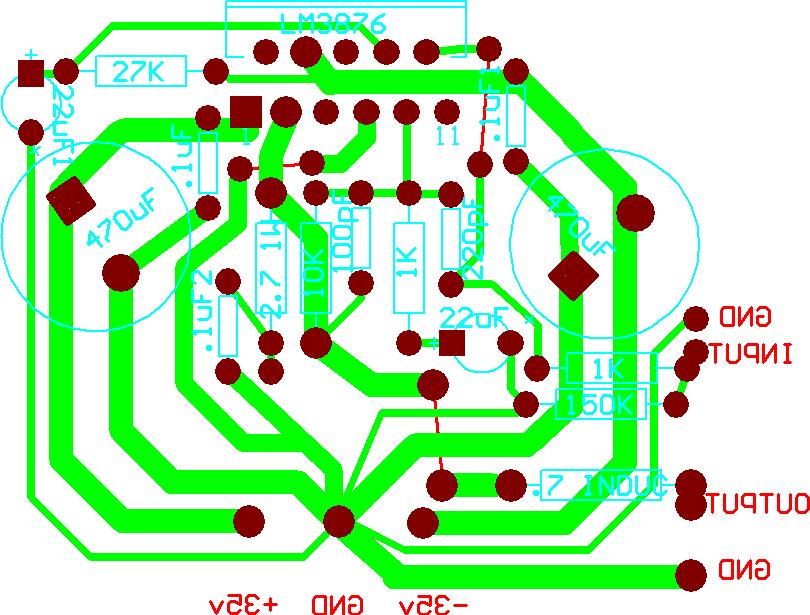

Andrew,
Here is another reworked schematic with almost no grounds using the same path. I moved the .1uF caps so that they are on the other side of the 470uF caps.
I now need to retrace all of the paths and make sure they are correct. Hopefully I've got it this time.

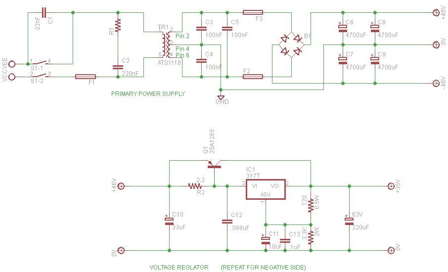

Here is the PSU I came up with based on what I could gather from the ideas that pacificblue was so kind to give me. I think the regulator resistor values will need to be adjusted to get exactly 35v, but I don't know the calculations for it so I will have to play with that some unless someone know right off hand.
Please let me know if i am way out in left field here, and none of this will even work together.😀

the regulator passes ~270mA. Combined with the 11V between input and output it will need a mighty heatsink.
What are the worst case highest and lowest input voltages. These will determine drop out and maximum heat.
The note about repeating for -ve supply cannot be used with the centre tapped transformer shown.
The two fuses between the secondary and the smoothing capacitance need to be so big to survive initial charging that they provide little protection in normal use.
The output fuses should be after the smoothing capacitors and should be F type.
The mains seems very odd.
Vcc =? Vee=? Live and Neutral are the usual names applied to the mains line connections.
Why is the switch suppression on a different line from the mains fuse?
I don't like the unsnubbered capacitors across the transformer secondary.
The mains side capacitor does not need to be snubbered. and that capacitor across the mains must be X rated.
I don't know which web site you found this misinformation on but if the rest is as bad as these examples then wipe it from your memory.

I don't think that the website is the problem. I'm sure it is me! I was trying to use two different ideas and make them work together. I will go back to the drawing board and see if I can come up with a better schematic. thanks for taking the time to look at it.

MJL21193 said:A better regulator circuit.
Add more pass transistors and emitter resistors in parallel to increase current. Adjust output voltage with R1 and R2.
This would hook right to the secondary of the Transformer?
Never mind that was a stupid question.
I got to looking at the first PSU scematic I posted and realized that I forgot to change the polarity on some of the caps. I can understand why it looks like a horrible schematic. DOH!!!
