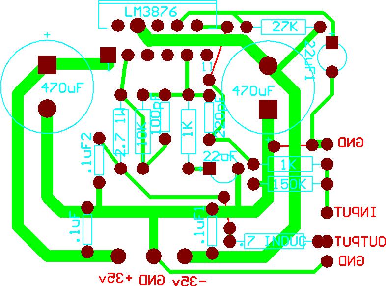

I designed a board for the schematic that pacificblue recommended to me. If you see anything the is glaringly wrong as far as components or traces that shouldn't be routed the way they are I would appreciate any comments. I have traced everything and I'm pretty sure it's all routed correctly.
One more question I had was could the LM3886 chip be substituted without changing anything?
Here is the schematic and the layout.
hello.
have a look at the muting.it looks like the elcap 22uf is built in wrong (reverted).............
shorter lines if you connect the 27k res left side to the supply line and right side to the 22uf elcap...........
the decoupling caps 0,1uf should be near by the opamp built in......
greetings.................
