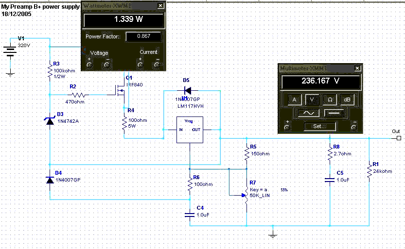

Here's the supply I had in mind. Questions:
- Is the raw supply ok or I need more caps / more decoupling?
- the 1N4742 is a 12V zener, I choosed it just because it was 12V. In reality, I should have in my parts bin some 6.2V zeners, I will series two of them.
- The IRF840 does need a fairly large heatsink. I have some...
- My simulation doesn't start (Multisim is a bad program or I can't use it properly), I wanted to calculate the proper value for the trimmer, to get 200/250 volts out. I would go by temptatives, I guess...
- Do I need that snubber net on the output?
- Do I made some other errors?
Thanks to all!!!
You want to make sure that the ripple is low enough that you don't have regulator dropout on the ripple troughs. Past that, the reg will do a pretty darn good job of ripple attenuation.
In your case, the current draw is pretty low, something like 20mA. So the ripple will be quite low with those big filter caps, no worries. If the input to output voltage is 20V or higher, you've got more than enough margin.
I think you should wire the floating pin on the pot back to the tapper. But I'm not sure. This is usually how a variable resistor is done with a pot.
Also if sim doesn't work there can be something wrong with the schematic and the real circuit may fail. Try to get a good sim before powering up the real thing. That's what I would do anyway.
Dear friends,
the sim didn't work because of the aforementioned error in the schematic. Now it simulates, but I have some problems with it: here it is
(sorry for the psychedelic colours)
well, you can see the dissipation of the mosfet and the output voltage. But if I connect a 33k resistor in place of the trimmer (more or less the same of the setting of the pot), why do I get a slowly ramping voltage that ends up at much more than the previous output voltage? I stopped the simulation when it was about 280V... 😕
