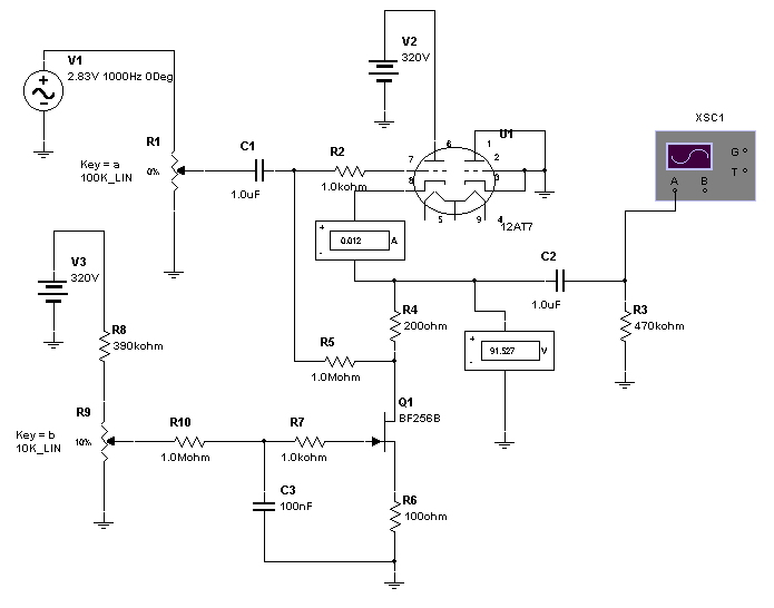

This is what I was looking for.
Simulation says 12mA thought the tube, 91V at the cathode with a BF256B FET (I use it because I have many of them in my parts bin).
So, what about it? I think I will start breadboard it.
Schematics with voltages attached.

Giame, yes, the series resistors drop the voltage to provide 6V at the heaters. This is explained in the article's text.
edit: 12mA is pushing it a bit for an ECC81. The tube is much happier at 2-4mA.
2nd edit: It's also pushing it for those FETs. Look at the Idss spec...
So I will just re-simulate for 2/4mA and see if I can.

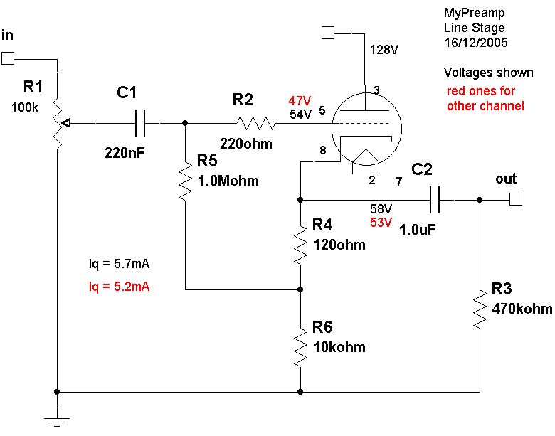

I've entirely rebuilt the line stage following the attached schematics: voltage values are shown. It performs very good up to now, still some crackling in the left channel.
I feel it a little bit more dynamic than before, but that's just a rapid impression...

Giaime,
Measure your resistors with the tube removed from the circuit... 2 volts Cathode to Grid versus 6 volts on the other channel is a very large difference for this tube... something is wrong maybe?
This is the ECC88/6DJ8 right???
No, it's an ECC81. I just measured ALL the resistors in the preamp, they are still within 10% spec.

With only a 120 ohm resistor degeneraring the tube differences, you'll likely see a pretty large variation from tube to tube. Especially so since the 1M grid resistor is a bit large, much larger than it needs to be. Dropping to 100K there will help if some of the variation comes from grid current.
Remember that measurement of the grid voltage to ground can potentially be inaccurate because of the high impedance at the grid compared to the voltmeter.
Would you be allergic to using a current source to simplify the biasing?

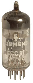

Here's the tubes I've got: attached picture.
The only difference from this photo and my tubes is that mine has also the name "12AT7" under the "ECC81" name, but not all tubes, only some of them.
On others ECC81 I measured 12ohm total cold heater resistance (6ohm per side), it seems that only that one has that funny high heater resistance. But even others, with 12ohm heaters, run very cold at the nominal 6.3V: they measure all about 20V cathode to ground (indicating 2mA of current flowing).
But I have their original cases, they're typical Siemens ones, with clearly marked "ECC81" on them. Also, as stated, some tubes have even the designation "12AT7" on them.
So is the 20ohm tube bad and others are good (indicating that 2mA is the proper current value with that circuit) or all of them are bad?
I also tried plugging in a Sylvania 12AX7A, it measures 16V cathode to ground (so 1.5mA), still not so hot heaters... I'm starting thinking there may be something wrong with my heater supply... but it does measure good!
To obtain the proper current value (4mA or thereabouts) I had to raise my heater supply to 10V (parallel heaters) with the 12ohm heater tubes. That's not normal :bigeyes:
