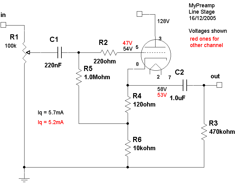

Putting aside the heater question for the moment, your cathode bias resistor looks awfully small. At 2mA, you've only got a quarter of a volt bias. And the plate voltage is much lower than that tube is happy with; you want 150V plate to cathode or a bit more to stay out of grid current trouble.

Hi Chris, very strange things happening.
I've measured the AC component of the heater supply with my DMM (and I don't trust on it) and I get 15.9V with the heater supply set at 7.5V (more on this voltage later). But whitout a scope it's useless...
Let's summarize what's happening on there. Of all my Siemens used tubes:
I have a bad tube: it has 20ohm heater resistance. As SY said, it's out of spec. I've put aside it for the moment.
Other tubes have 12ohm heater: they are happy to conduct about 3mA in my circuit (attached, but now 1M resistors are 100k) with 7.5V on the heaters. This leads me to think that those tubes are PCC81 instead of ECC81, but they are marked ECC81!!! 😕
That's not a big problem, I've got an adjustable heater supply, so I'm ready for strange heater requirements. But I'd like to know what the h*ll is going on! 😱
Btw, SY, what cathode resistor are you refering? the 120ohm one or the 10K one?
edit: now the voltages are obviously different than ones in the attached schematics, now I've got about 30V on the cathodes (32 and 28) and 143V on the plates.

I agree with Stuart that the 120 ohm resistor between the cathode and tap for your grid seems far too low. This sets your grid bias.
-Chris
Thanks Chris, could you suggest a value for that resistor? Or better yet, explain me how to calculate it :cannotbe: You know I'm not too expert :angel:

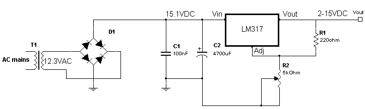

Attached there is the schematic of my heater supply (straight out of the LM317 datasheet):

Hello people, I've tried heating my tubes with a CB 13.8V PSU regulated down to 12V with a 7812. The results are... that obviously the same tube heaten with the same voltage (as my psy) glows the same. 😀
But I think that the problems here are solved, I'm now running my heaters at 12.6V (series connected) on the good tubes (the bad one has been set aside) and I've got 25V on a cathode and 16V on the other. Do these values seems fine or are the heaters
starving?
And an important question: now I hear some high frequency buzz. I think it's related to the fact that my heater psu isn't referenced to anything in respect of the other hi-volt psu. So, what is the best way to reference them togheter? Should I reference the heaters to audio ground or to an elevated voltage? Same as cathodes? Directly to cathodes? Higher?

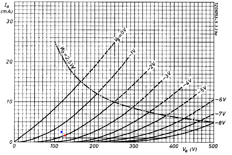

Do you have the plate curves for your tube?
http://www.pentalaboratories.com/pdfs/ECC81.pdf
Mark your Plate to Cathode voltage (about 70) and your Plate current (about 0.005). Your "Q" point , Q = quiet or steady (DC) is very close to the zero grid voltage curve.
You want to move your Q point to the right: more plate to cathode voltage. Operating so close to 0 grid voltage is a problem...
Try 330 Ohm for R4. 9100 Ohm for R6. Your volatge at Cathode should 28 volts. Your voltage at the grid should 27 volts (1 volt negative grid bias) but this can be a false reading. You must have high impedance meter. Otherwise If the cathode voltage is right... you are good!

Apart from the big differences between the 2 sections, I can see that my q points are these in the image attached (blu = triode 1, red = triode 2). They are sufficiently far from the Vg=0V line, but I understand they're a bit on the low side of current. I think a point like this, Va = 200V Iq = 7mA would be better... So I have to raise the B+ or could I go with a more friendly (for me) point of maybe Va = 150V Iq = 5mA?
Giaime,
You should really have 175 to 200 for B+. This would allow 150 to 175 for Plate to Cathode voltage. This would allow the Q points to move UP (resistors would change too).
This is a move in the good direction... getting away form zero grid bias... how does it sound?

But now I'm looking toward another direction: since it is almost impossible to me to obtain higher B+ voltages (how I would? I've got a 117VAC tranny, I can only go like this or voltage double, which leads to 320V... a bit too much) I've connected some trimpots in place of the 10K and 120ohm resistors. I've tweaked them to get at least Iq = 2.5mA, and I'm at Va-k = about 110V. I think that's a prettier bias point: farther from the Vg = 0V line. Btw resistor values for this are 220ohm and, still, 10k.
I was going to suggest a 220 ohm for R4. that moves your Q point up. You are the right track now... just be sure to stay away from low grid bias and low Va-k. They cause grid problems.
If you can get more B+... you can see now this is the center of the problem. Get a knife and take turns from the tranny primary! It is crazy... but it is DIY! 😱
