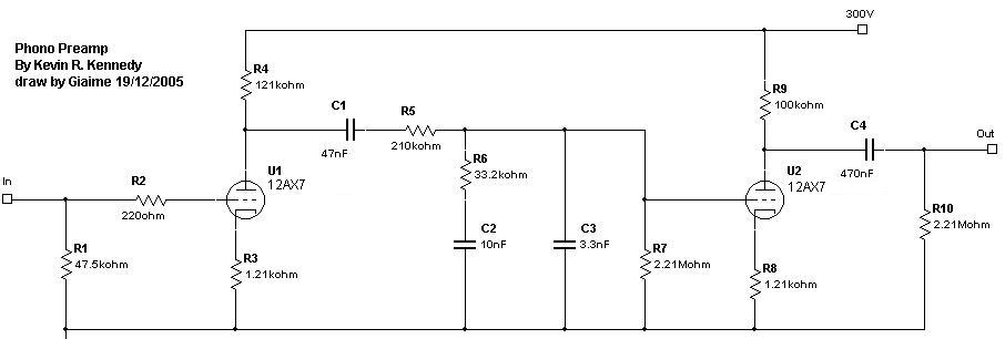

...ok, I've drawn the Simple One Tube Phono Pre by Kevin, aka kevinkr.
Any guru's comment on it? 😀
To adapt it to my 220V B+ I guess I've got to draw the Q points of the two stages (which luckily seem to be the same), and tweak the plate / cathode resistor to get the same gain and the same Vg-k...
And another question: those strange resistor values are those 1% metal ones? Because they aren't standard...

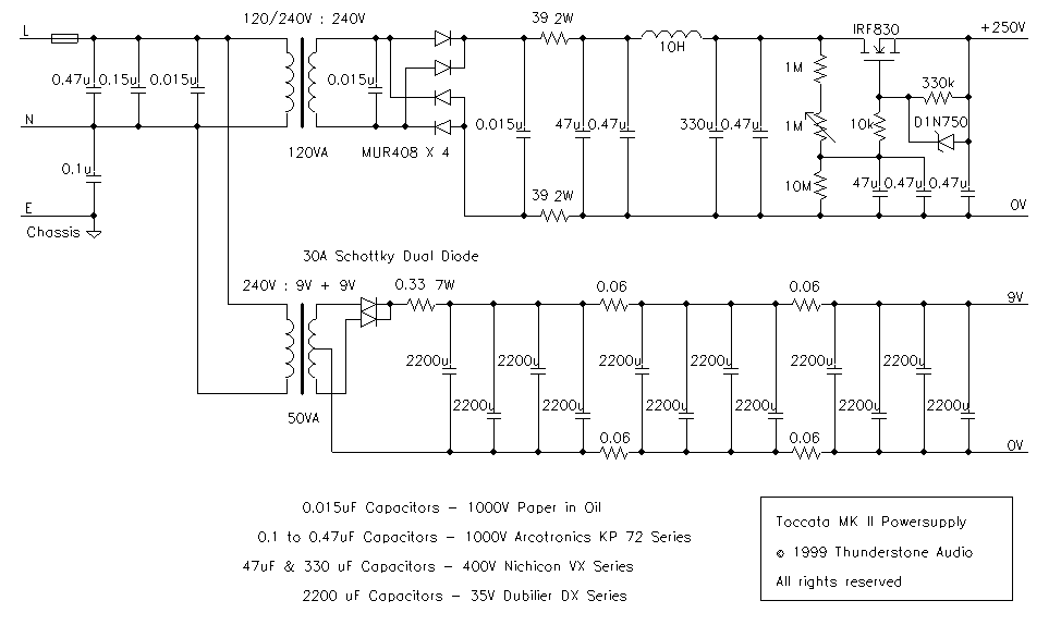

no, I don't have a B+ relay. Can you show me a simple way to implement a time delay to power up the relay coil? I was planning to switch the mains to the hi-volt PT instead of switching the B+ (because normal relays aren't rated for that), since my hi-volt PT is phisically separated from the filament one.
So, you have a regulated 12.6 volt and you have to make a 15second delay circuit to power up a relay. How would you do it? 😉
Aside from that, the noise now has totally disappeared (since I built the B+ regulator), but I'd like to know what was the cause before. Too high B+ (320V) maybe?

Giaime,
There is a capacitor (small) "hiding" between the PRI & SEC of your heater tranformer. There is another capacitor between the heater filament and the cathode. If your heater circuit is "floating" these capacitors carry signal into audio. When you ground or "anchor" the heater supply, the energy from the transformer cap is shorted to "AC ground" and the coupling is broken.
I guess (don't know for sure) this situation may become worse when you have asymmetry from rectification and filtering of the heater AC... have to think about that one!

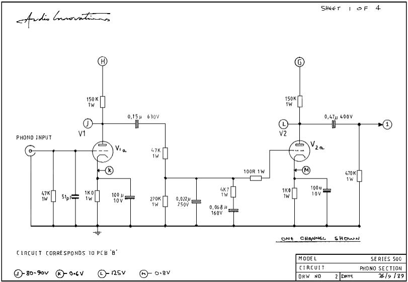

Now I have a serious question. Attached this post there's the phono stage I'm building. It's from an Audio Innovations preamp, a trusty and tested design.
The questions are related to the grounding: I've never built a phono stage before, so please be patient 😉
1) I have a regulated B+. It's also powering the CF. Do I have to bypass the B+ locally in the phono stage with let's say 1K/33uF?
2) Where do I put the ground wire that comes with the turntable?
3) I want to run semi-balanced shielded wire to the input of the phono stage. They consist in wire with 2 conductors and a shield: one conductor takes the RCA hot, another one the RCA cold, and on only one side of the wire the shield connects to the RCA cold. But what side? The side on the input connector or the side near the tubes?
Other suggestions are welcome!

Hi Giaime,
With such small signals, you want to connect each input ground to the cathode ground near the tube. Keep them separate. The thought is you are amplifying the difference between grid and cathode. You would rather not include common mode signals. (noise, hum)
Then ground the circuit as you normally would.
