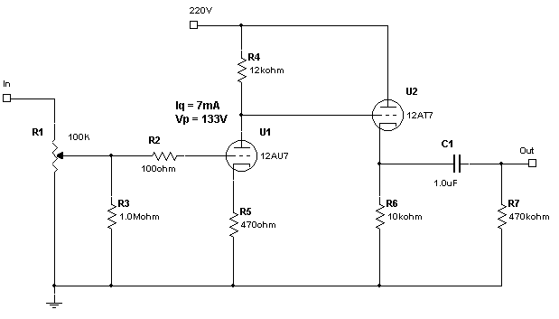

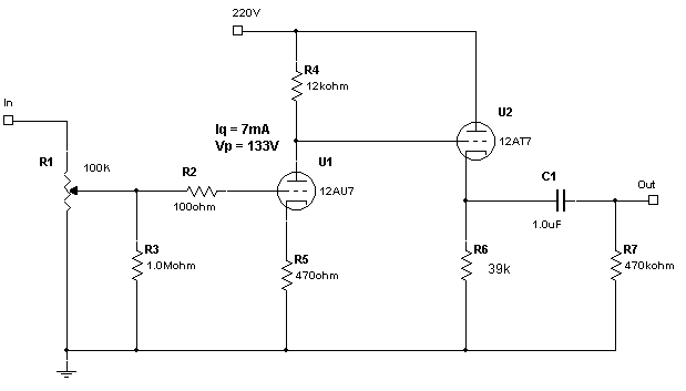

Hello to everyone! I thought I had to up this thread instead of making a new one 😉
I realized that I really need some gain in my line stage. Actually, it's a cathode follower with a 12AT7, but I would like some little gain, at least 3 or more.
I thought of using the 12AU7 (for its low mu) as a grounded cathode stage DC coupled to the grid of the 12AT7 cathode follower.
The problem is, obviously, to determine the values of the various resistors needed.
So I purchased TubeCAD: I tried it and found the way to design a grounded cathode/CF direct coupled, but you can calculate it with just one tube type. I mean, the tube of the grounded cathode stage must be the same of the CF stage: instead, I'd like to use a 12AU7 for the grounded cathode and a 12AT7 for the cathode follower.
How should I proceed?
1) draw a generic grounded cathode circuit with the 12AU7 (schematic included below) and then, given the plate voltage (the same dc voltage of the CF grid), I can calculate the CF cathode resistor value (how?)

And another question: will the grounded cathode stage I calculated in TubeCAD accept full 2Vrms input without clipping? How to verify this? I think I have to look at Vbias, or am I wrong? I figure I need about 6V of bias to accept 2Vrms without clipping...
The cathode follower won't change the gain or the operating point of the previous stage. So you can design the voltage amp in isolation. Then when you're happy with that, the CF is a slam dunk, designable on the back of a small envelope.
But do reconsider using a 12AU7 unless you want the preamp to have a sound of its own. As a voltage amp, it has a relatively high third and fifth harmonic distortion. That's useful for guitar amps, not desirable in a hifi amp.

Thank you so much Stuart, so I'll have to avoid 12AU7. So, is there some possibility to use 12AT7 as both voltage amp and CF? How to reduce that big gain that I get? maybe with a more vertical load line, this implies lower plate resistor, isn't it? But I have another fear: the plate voltage will be around 100-120V, what about the avabile B+ headroom to make a CF? Because the CF will have the grid sitting at 100V, the cathode at some volts more, so only 100V cathode to plate... is this too little to give the CF proper headroom? Or to stay away from non-linear zones?

Here's the problem- you don't want very much gain. Even the 12AU7 gave you far too much. You have several choices:
Change topologies and use feedback to set gain and lower output impedance.
Use just the CF, but use a 2:1 stepup transformer on the input (that will get you 6dB or so of gain).
Use a very low mu tube like 12B4.
Do some really weird biasing and local degeneration to knock down the mu of the voltage amplifier section.
What about this? Schematic attached.
I just don't know how to calculate the second stage cathode resistor.
I've got 133V on the grid, so I want the cathode let's say at 140V. How to calculate? I can't just make R = 140/I because I don't know I :xeye:
Aside from that, first stage looks good. TubeCAD says I've got almost 7x gain, which is too high but I don't care too much, I guess I have to keep the potentiometer on low positions (an anti-log pot should help here, but hard to find...). About -3V bias, which should be good given the max input of 2Vrms.
Any comments?
That part is easy. The second stage grid voltage is equal to the first stage plate voltage, right? So at any reasonable current, the second stage cathode will have to be just a couple of volts higher.
The grid voltage at the CF is 133V, according to your sim. OK, so the cathode will be at 135. Maybe 136. Maybe 134. Doesn't much matter. Call it 135. We choose a standing current that we want to CF to run. This will be based on what we want it to drive (see the first part of the Heretical article). I'll use 3mA as an example here.
We have 135V on the cathode, we want 3mA, now all we have to do is use Ohm's Law to see that the cathode resistor should be 135/3 = 42K. We can run a little richer and use a 39K or a little leaner and use 45K. Either way, the local feedback ensures that the tube will be running at the chosen current.
Thank you very much Stuart, I figured that out. But the question that was blocking my mind was: if I get a gain of 7x, I'd like to use all this gain (let's hypotize an extremely unsensible power amp), so I have to have headroom. If I put the CF cathode just a couple of volts above the grid, will I have headroom for a 20V signal (about 2Vrms * 1.41 * 7)? Or will the local feedback take care of that?
Thanks so much anyway 😉
Why in the world would you need a 20V signal? There's not a power amp I've ever seen that needs more than 4 or 5 V, and even that is exceptional. 2V is pretty much standard. Don't design for the unlikely at the expense of the normal.
If you nonetheless want to swing 20V cleanly at a gain of 15-20dB, you need something like a 6SN7. A 12AU7 will be running close to a percent distortion at that level.

Oh yes SY, I understand 😉 I didn't mean that I would like to have 20V at the output (btw I intended 20 as a peak value, not rms), but I would like to have some headroom on normal 2Vrms signals. I think that 2Vrms can be fully handled by the grounded cathode stage, I was just not sure if the CF stage could do the same job.

Edit: here's the updated version of the schematics. I'm starting to breadboard it now, I can't wait 😀 It will be hard, I have to fully reconstruct the line stage zone... I will have to remove completely the old CF.
