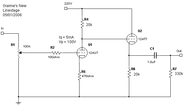

I'm breadboarding the new linestage on my preamp, and I fear that noise will be great, even if I use only 7x gain.

Schematics attached.
But... I have big problems. BIG, VERY BIG noise in the line stage, even with the volume down to zero (thus grounding the input). It's like an hissing, but very wide in frequency range (think white or pink noise). Could be the heater to catode voltage? It's over the limit now, 155V... I will try to elevate filaments.
Also, the ECC82 makes a very noticeable sound when tapped, in fact the line stage (with a gain of 10/15dB) is FAR MORE NOISIER than the phono stage (with a gain of 50dB), both in hiss and microphonics!!! That's incredibile!!!!
Let's try this heater trick... also it's possible that I got a bad tube, since the only one ECC82 that I have is salvaged from an old amp, and that's a Siemens silver-plate ECC82. Will an ECC81 or 83 "work" in the circuit just to see if it's the tube defective or the whole circuit? Just to hear if the noise increases or decreases... I know their mu is higher, so I'll hear more noise anyway...
And it can be that I'm using old salvaged resistor for the plate ones in the voltage amp stage. They're 10K since I don't have a 12K 1W in my parts bin...
Some help?![smash :smash: :smash:](https://files.diyaudio.com/forums/images/smilies/smash.gif)

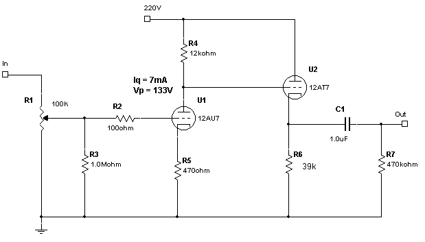

But, under suggestions of some italian fellows on another board, I've revised the schematic (attached), and now I'm getting much lower noise and have lost some gain. I just changed the plate and cathode resistors (I can't understand why I'm getting lower gain with higher plate resistor
I also added an elevated reference for the heaters, about 50V. This cured some noise.
Now I've got 3 problems:
- my only ECC82 is very noisy. It's also fairly microphonic. Must replace.
- the preamp is making really weird sounds until the tubes start to conduct at turn-on: I guess I need to delay the B+. Maybe I'll go with a simple solution, 2 switch to activate the B+ and heaters separately.
- I'm hearing some high-pitched whistle, but I'm not sure (it's really high, almost a whine). You know when you're sitting too near the TV set and you hear that kind of noise? That's it... Maybe oscillation? I haven't that damned scope yet... (sorry for the bad words but I can't go without a scope!!!!).
