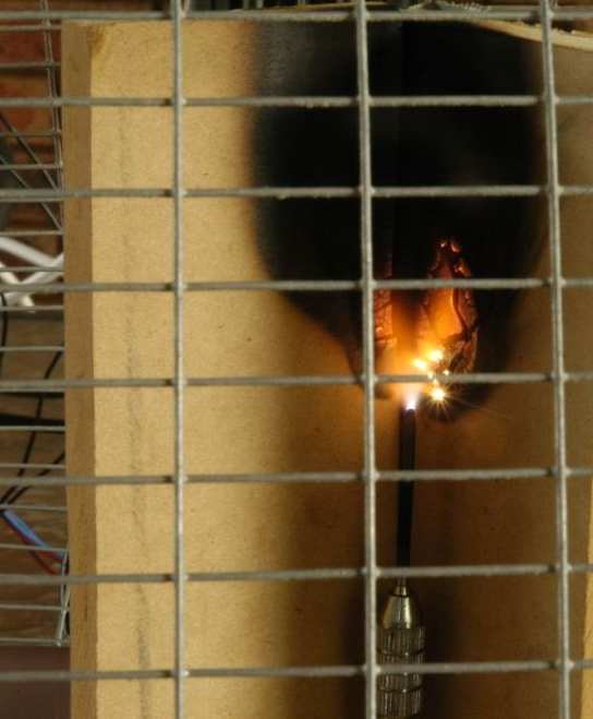

Some tests with my friend's plasma tweeter. The electrode is tungsten. The driver stage of this one is all vacuum tube. output circuit is similar to yours with a capacitor added to stop the 700Vdc from going through the output coil.
We tried a quick corner reflector from MDF, the heat from the plasma is incredible, the corner reflector helped the volume.
The sound got louder when it was arcing to the carbon (the white sparks)
I wonder how it would sound with a tube for the electrode with a small gas flame like a cigarette lighter. It should make starting easier.

You can see the output coil is very large, it doesn't get hot at all. It needs to be shortened, it is running at 21MHz here.
With a constant tone from the signal generator this was uncomfortably loud to be near. We were only putting 125mA at 700V through the tube. As it is here it was much Louder than it needed to be for a tweeter at normal listening volume.
