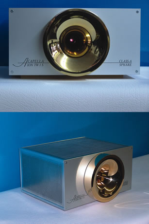

Hi, George,
Is this tweeter has the same operating principle with Acapella ion tweeter?
