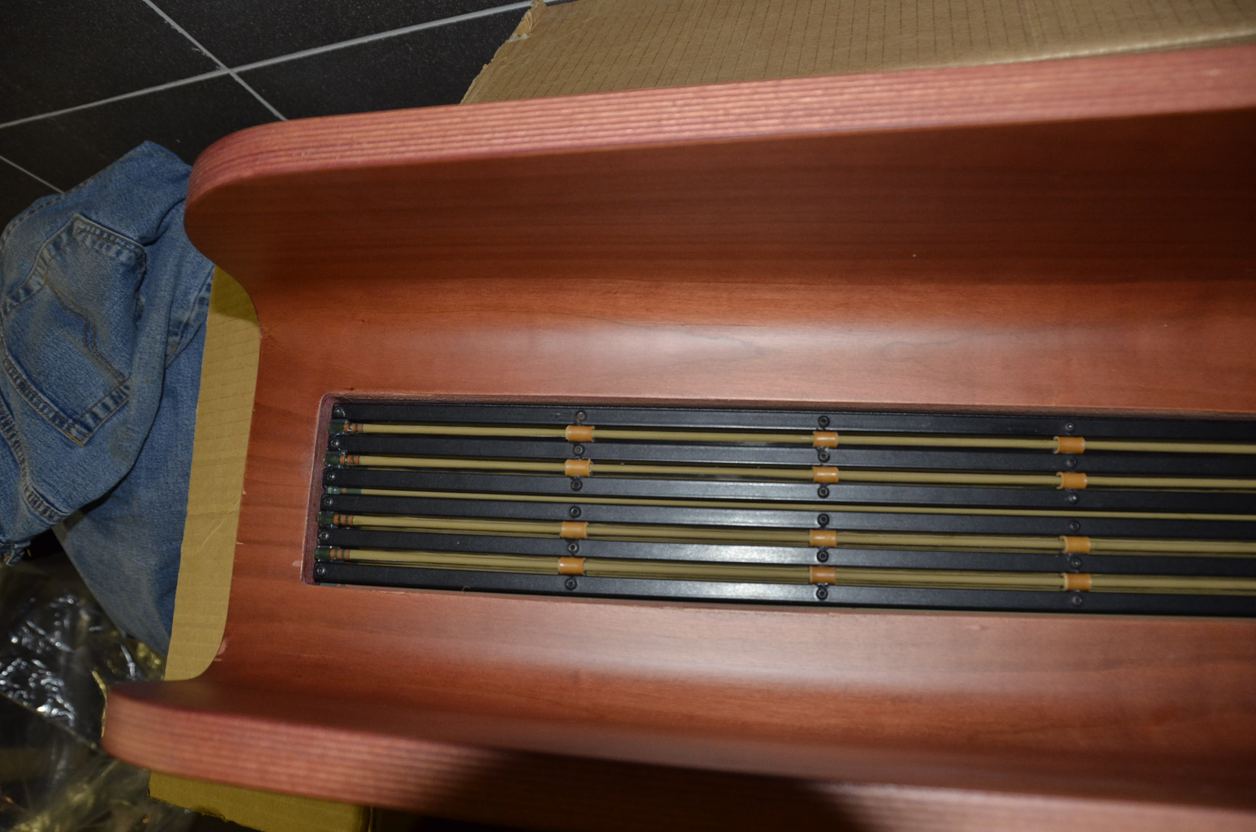

I didn't know this existed but I thought of a similar design myself in order to get more moving surface and a small width.
Like to hear from your experience.
Is there something done to prevent the membrane slapping onto the magnets?

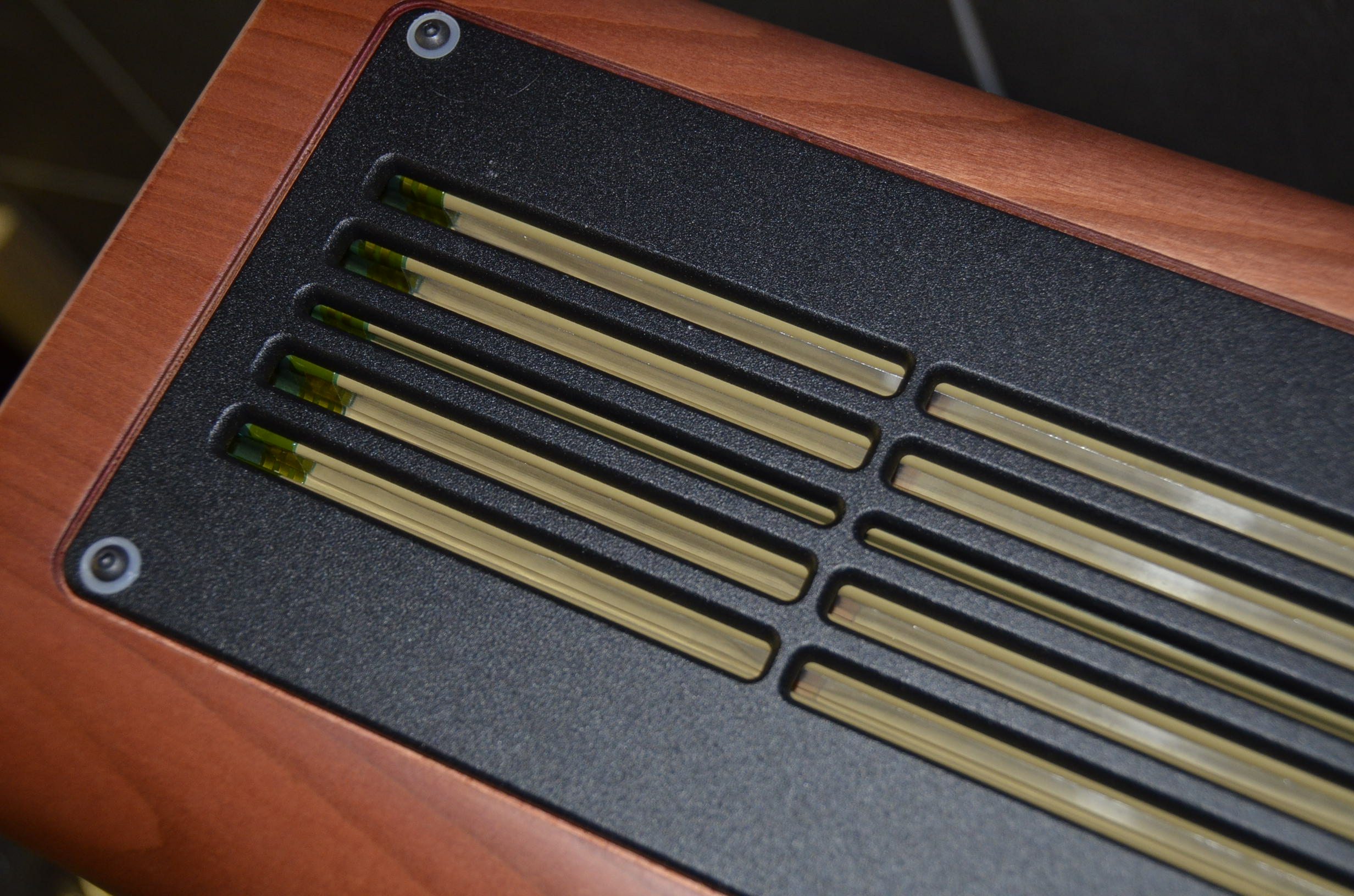

This i a clever design. But this statement from 6moons isn´t true
"By folding their midrange diaphragm faintly reminiscent of Heil"
The folds is exactly the same as the Oskar Heil idea. 1 fold will move like 10 folds. If it plays well, it dosn´t really matter. But the idea is Oskar Heils.

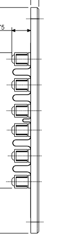

to get back to the topic i plan on making a sort of membrane like this _/\/\/\/\/\_ sort of amt but more easy to construct, since i dont need a JIG , another thing is that i could place magnets like this [ M ] stands for magnet
[ M ]_/\/\/\/\/\_[ M ]_/\/\/\_[ M ]_/\/\/\/\/\_[ M ] or
[ M ]_/\/\/\/\/\/\/\/\_[ M ]_/\/\/\_[ M ] second option only cost a third row of magnets to be able to another option is to decrease pleat depth on the side of one membrane or in the middle to be smaller to not create a dip in the highs.
Side would be best since magnet strength is greatest near the sides so you can keep the High frequency width small. it could be one trace or 2 seperate traces with a simple filter. in the last way you could get away with smaller traces for the highs
WrineX:
Which way are the magnets' poles oriented in your diagrams? In the plane of the diaphragm (left and right) or perpendicular to the plane (up and down)?

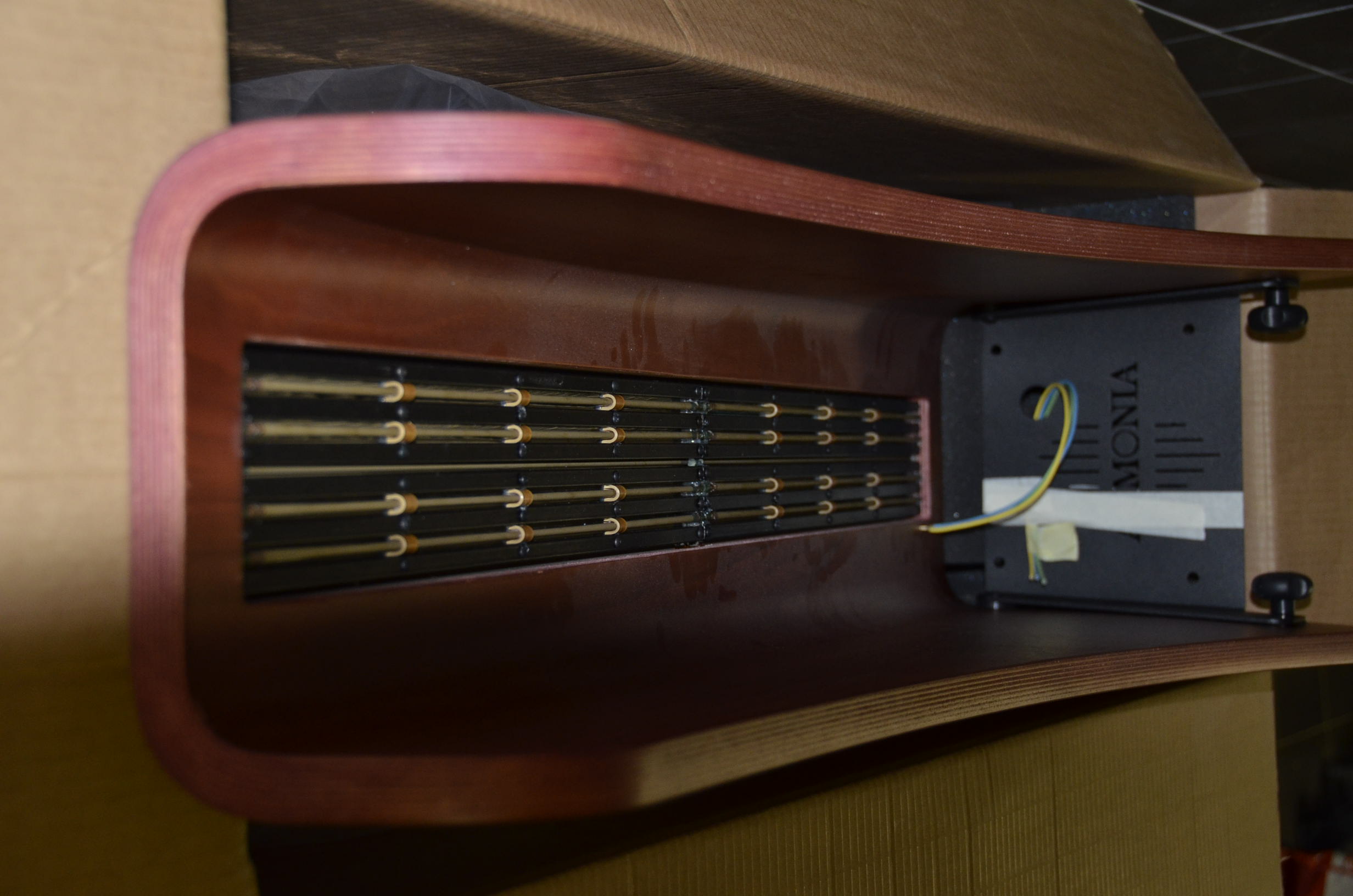

OOooh nice, this design is soooo simple 🙂 its nice 🙂 i see they used rubber bands to keep the folds from touching the magnets. if i remember correct they where not there in the first picture, the reason i said they where a bit to close. are they refurbished ?
looking out for some measurements 🙂
btw from how low should they be crossed ? since the rubber band are thicker then 2 mm, if your crossing around 400hz or so they could be thinner depending on the slope. with higher spl as a result
