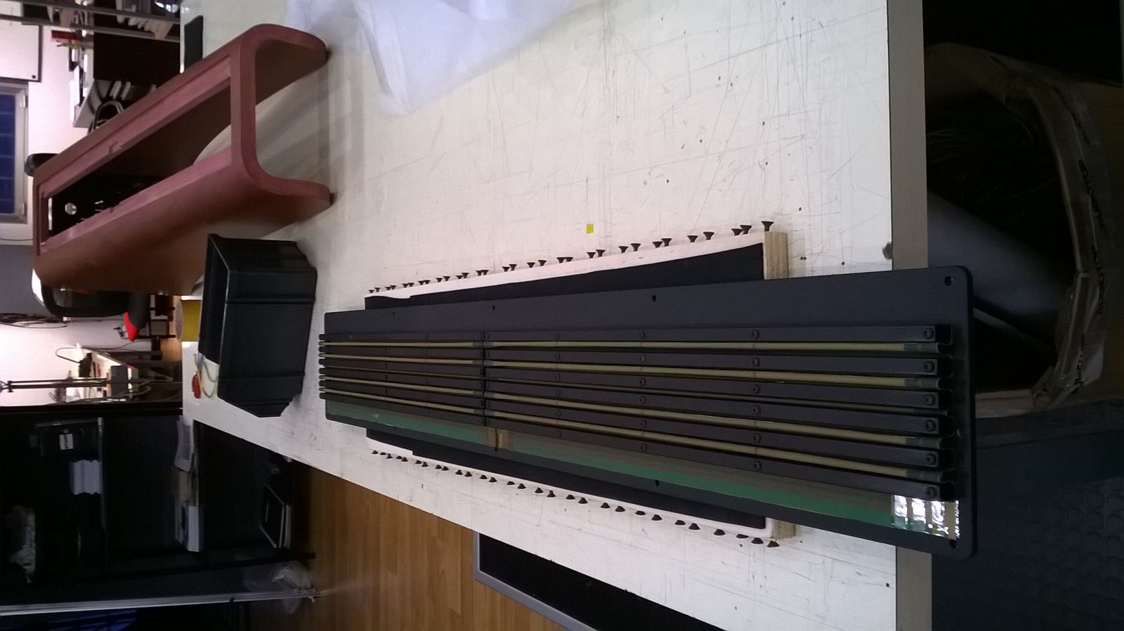

These drivers will be delivered to my next week:
attachment.php
attachment.php
not sure what i am looking at. looks like some folded membrane in between magnet rows. but there is hardly any room to move ? can you enlighten me how it works or do you have more pictures ? or a brand of some sort?
i do notice the smaller fold in the middle. probably for high frequency only, and is les wide and less deep to prevent phase issues and low roll off. but still i wonder how this apparatus works 🙂
same question here is has it forward movement or side ways like an AMT ?
Thx Jensen, well this is in fact sort of a AMT, although its not a perfect dipole(like an ESL or an amt comes close depending on the maagnet structure), since the back is considerable different to the front, at the front the airs gets squeezed by the 2 ribbons that move in opposite directions. but at the back it is the 2 ribbons than move towards or away from the magnet structure(so it has 2 cavity's compared to 1 bigger at the front). so if you would measure both sides they ought to be different. i like the fact they decreases dept of fould for the tweeters section since this a cullpit for high frequency's. another funny thing is that the ribbons are in the highest field possible close to the magnets. unlike normal ribbons in a big gap there is usually a weaker field in the middle compared to the edges of the ribbon. here they are almost at the strongest field possible. but when pushed it will get uneven. when at a loud positive peak the ribbon will find itself in a weaker field then a loud negative peak(closer to the magnet)
