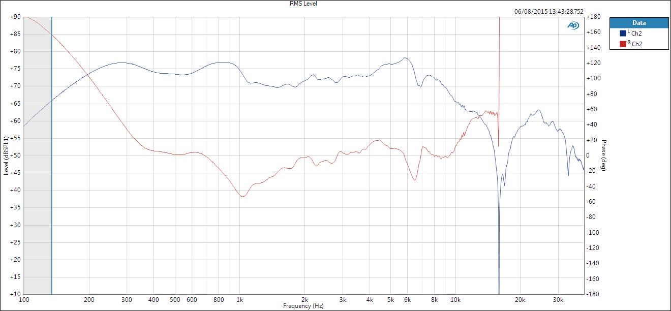

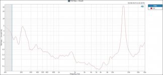

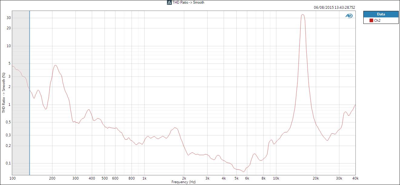

Interesting ds23man. Can u give us the spl level and distance mic is from driver for that distort measurment?
If al is true pretty good the huge peak won't be there since it is crossed before I guess. Not bad at all ,wonder what the efficiency is. They say the used copper traces. That's weird.

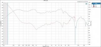

The peak in the top end is normal because the freq. drops down:
Tecnomotive - Equipments for Science
Only the midrange.
Ok it explains the dip. probably exactly the distance between left and right transducer.
It is the phase curve.
aaaaaaaaaahhhh 🙂 ok thought hmmm does not comply with the % distortion you shown early. well i hope you get them soon and let us know how they sound 🙂, its an interesting design

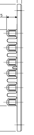

well it seems to be an elegant twist on the AMT principal in that it has a unique magnet arraingment. The thickness of the Kapton is about 2 to 3 times what would often be used in ribbons so a bit heavy BUT if well damped, as this method tends to be due partly to the magnified air load, then maybe a non issue.
The statment that its a dipole unlike AMTs ? Im sure you can make an amt as a dipole. As well im sure an amt could be made with a seperate tweeter section in the middle just as this one is.
Interesting and clever design. Please let us know how it goes with the only judge that trully matters, your ears 😉
My claim is if the magnets are numbert 1-2-3-4-5-6. you could make the same with only magnet 1-3-4-6 then it would be a normal AMT with a tweeter sektion with only one fold ?.
hmm i think i did not explain myself clearly 🙂 ofcourse an amt is a dipole(not all of them but most are). just this speaker does not measure the same on both sides since they are different. (physically)
yes you could, i guess efficiency would be a tad lower maybe 🙂

I'm still on the right side of the turf, as the old saying goes. I don't have a drawing handy (I can make one later if it turns out to be necessary). It's been awhile, but I think the point was that I could use closely spaced magnets with a single conductor in the magnet gap, or use a wider magnet gap that would accommodate two conductors. The magnetic field strength is smaller in the wide-gap case but you make up for it by having a BL product (field strength times length of conductor) that is twice as large. In fact, I had concluded you more than make up for it for the two cases I was comparing.
In general the driving force depends on the product B x L as described above. Using parallel rows of magnets, widely spaced, reduces B (the magnetic field) but makes room for more runs of the conductor, which increases L. You have to look at both parameters to decide where the sweet spot is for your application.
