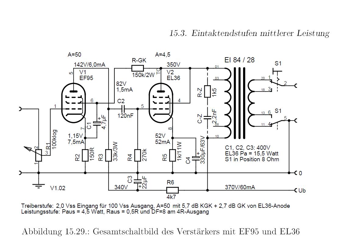

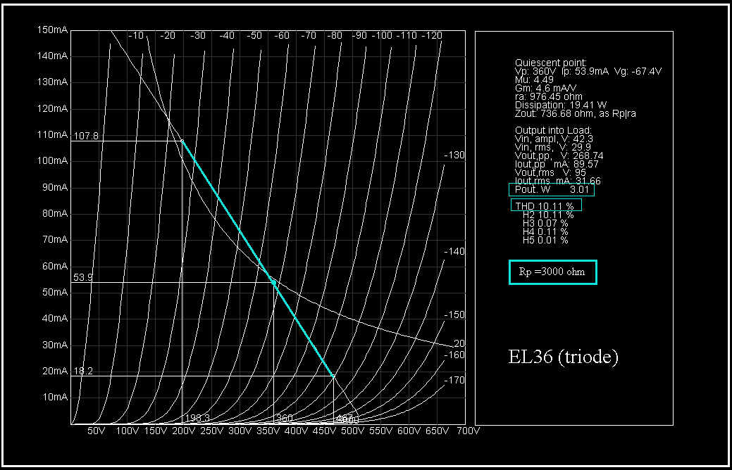

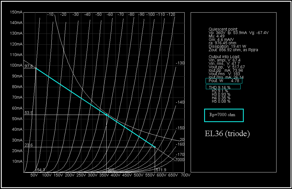

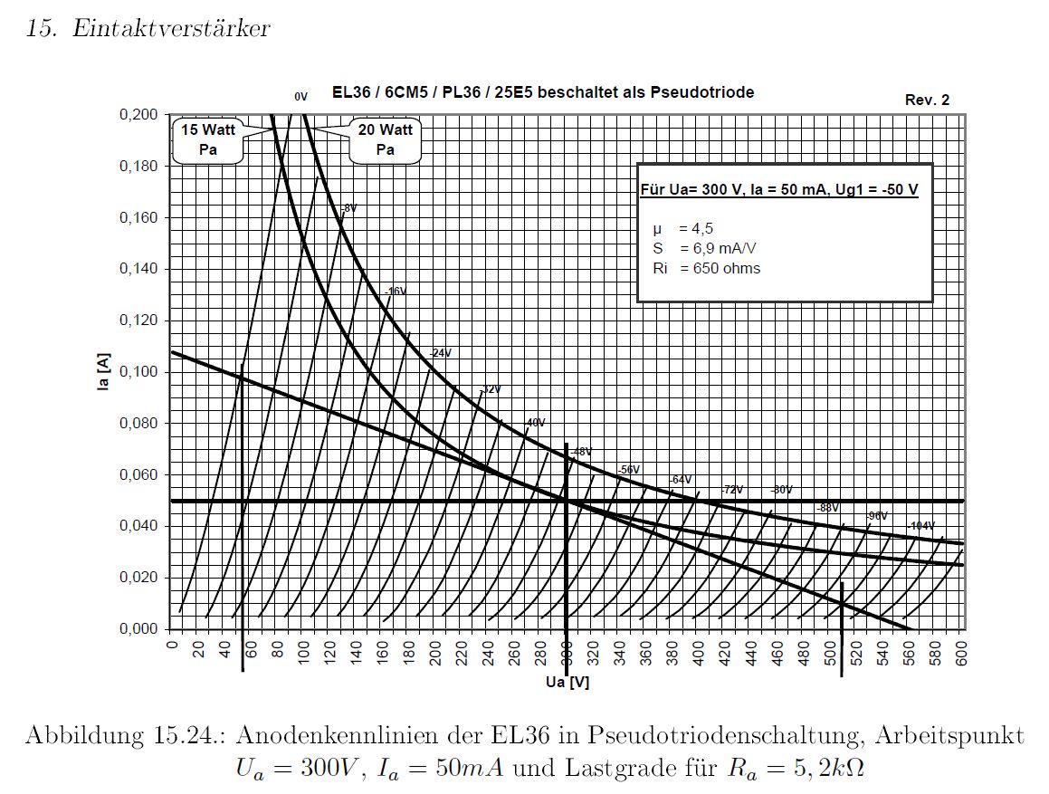

for sure you can get excellent results with triode strapped single ended EL36 / PL36 / 6CM5 / 25E5 and you can expect about 5 Watt Po using a decent OPT. I used a really cheap OPT and got about 4,5W Po 🙂
Loadline and schematic are excerpts from my (not yet published) book.
Kind regards, Tom

this is a working amplifier build exactly as as illustrated in the diagram...still on breadboard though.
The negative bias is generated by a voltage doubler circuit and stabilized with Z-diodes.
cheers
Peter
Hmm, just my opinion....
Shouldnt voltage stabilise the bias supply unless +B is also stabilised...
Line voltage variations will make bias drift if you have the bias supply stabilised, and not +B as well...

Hi Tom,
I have been running my MTA SE PL36 connected in pentode at 20W since the EFT16.
330@60mA over the PL36, g2 is 150V regulated. OPT 5,2k
The setup is very stable and sounds great on Tannoy Berkeley.
btw looks like the PL36 glass tube is larger than the EL36? both quite low rated 12W

Hi folks,
Kind regards, Tom

Isnt 360V in triode mode exceeding the maximum screen grid voltage on the EL36?
By the way, i think the E235L was a repacked EL36 sold as a SQ tube. The telefunken datasheet shows triode curves, and pentode curves that show a striking resemblance to those of the EL36

Bumping an old thread
Questions for Tom (or anyone else who can answer) regarding post #23
  • On your schematic, you show feedback from the output tube plate to the G2 on the driver. What are the benefits of this method for this schematic?
  • zoebel network on OPT; what are the benefits? How to calculate?
  • Was this amplifier built? Or just modeled?
  • Is your book available? I did a quick search but I was not able to find it.
thanks

The feedback to the screen grid is not what it looks.The screen is decoupled to the cathode so it's feedback to the cathode, the voltage screen-cathode doesn't change.
