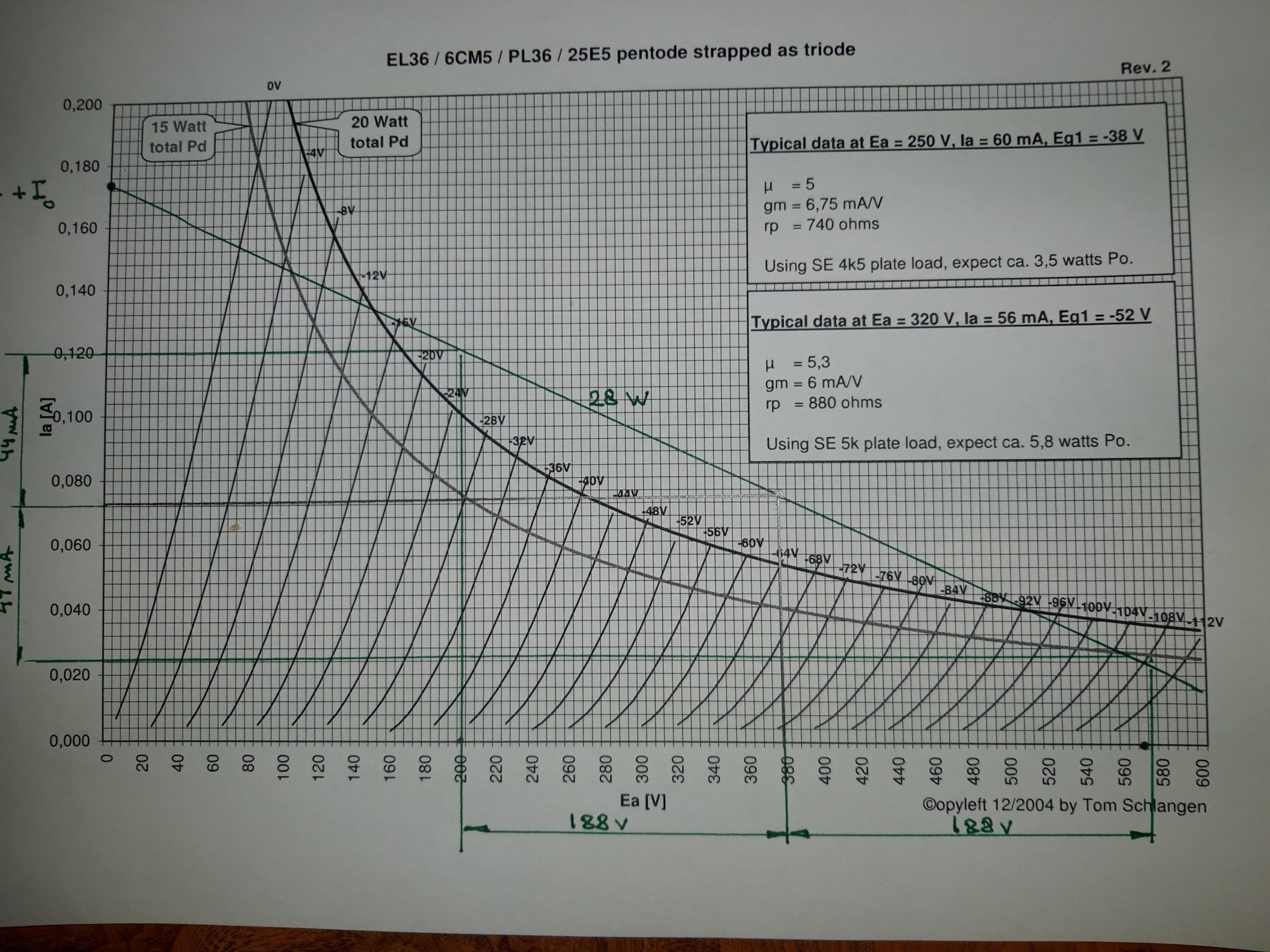

the EF184/EL36 schematic from the ETF 06 lecture you are referring to is courtesy of Gregg van der Sluys - I didn´t design, build or measure through it. Gregg used to read & post here, too, but I am not sure he still does. If so, he certainly can elaborate. I showed his schematic because it used "cheap TV tubes" like EF184 and EL36, strapped as triodes. Okay, EF184 / 6EJ7 is not cheap anymore. So, some years later, I used EF95 / 6AK5 as driver instead, and, in general, a different approach, except also using triode stapped EL36. The point of my amp shown above is to show how cheap one can go with a two stage SET using cheap tubes and a rather cheap OPT, by using an uncritical feedback scheme and "hammering flat" its frequency response deficiencies by the very low trioded EL36 plate impedance.

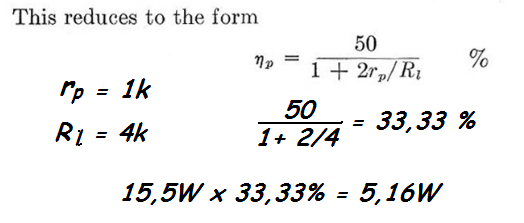

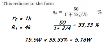

In Post #23 I see two gross errors in the schematic. The 150K FB resistor needs to go P-P. The screen of the driver then needs a source of B+. 4.5W of audio when the power tube dissipates only 15.5 Watts defies gravity, And the theoretical limits of a Class A triode.
Better be sure to get a professional to do the proofing on your book before publication.
If you do the 150k to the B+ there is an extra resistor+capacitor needed for feedback.
And with an S=5mA/V of the EF95 the feedback to the cathode is rather small.
There is no problem with gravity here. The Rp of the EL36 triode is less then 1kΩ and I suspect a OPT of 4kΩ. So, accoding to the formula you showed 5W out is possible.

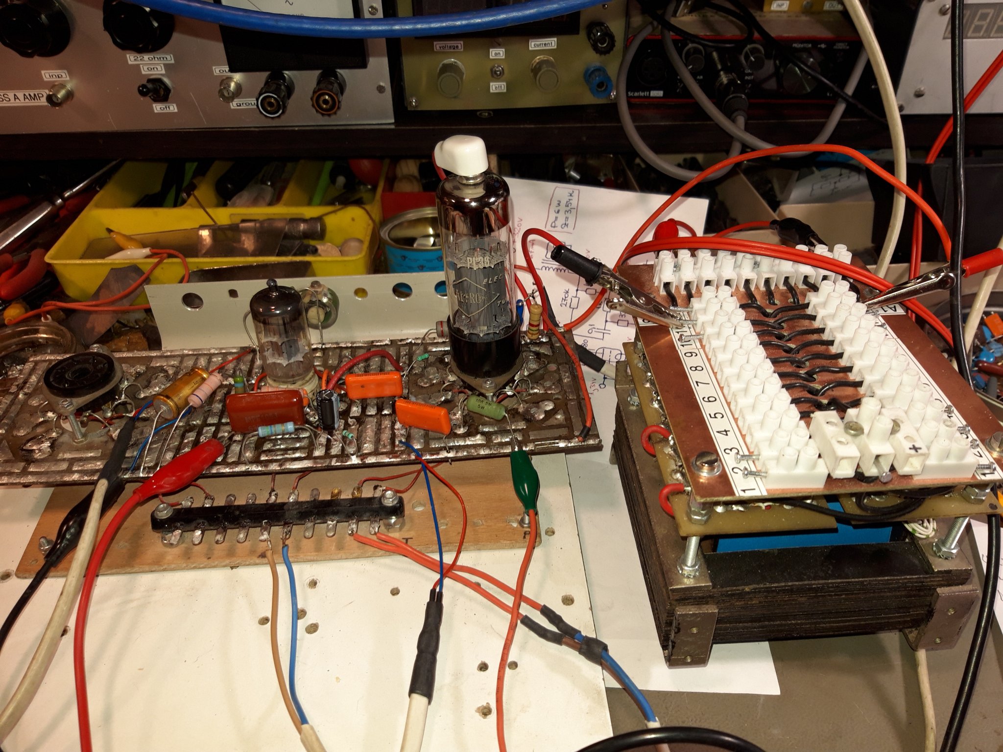

Hi Ketje,
measured rp is somewhat less than 900 Ohms at the operation point shown, reflected impedance is about 4500 Ohms. Even assuming an unusually bad efficiency factor of the cheap OPT it is possible to get there, indeed.
Kind regards, Tom

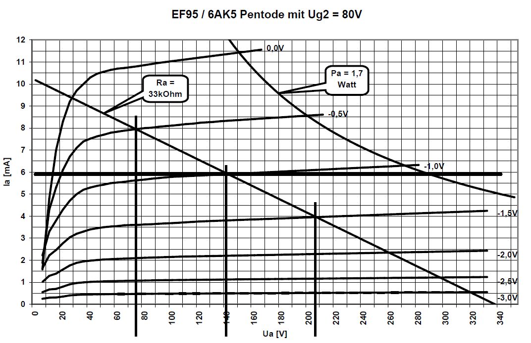

EF95/6AK5 pentode driver stage operation point of the schematic shown above. Don´t underestimate these sh*tty & cheap RF and IF strip tubes, although you most likely will have to select them for microphony. Another interesting candidate is EF80 / 6BX6, used in gazillions of European TV and radio IF strips.

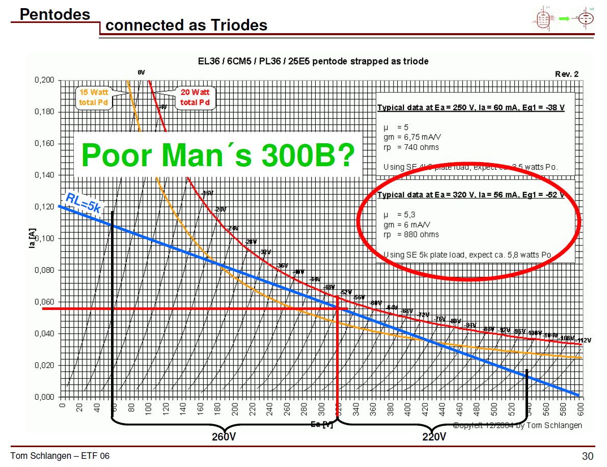

Seely's power output formula assumes better than 5% distortion for the triode SE power amp.
Looking at the very long loadline in the 'poor man's 300B' we can see a large difference in the grid spacing
at the extremes, a sure sign of distortion.

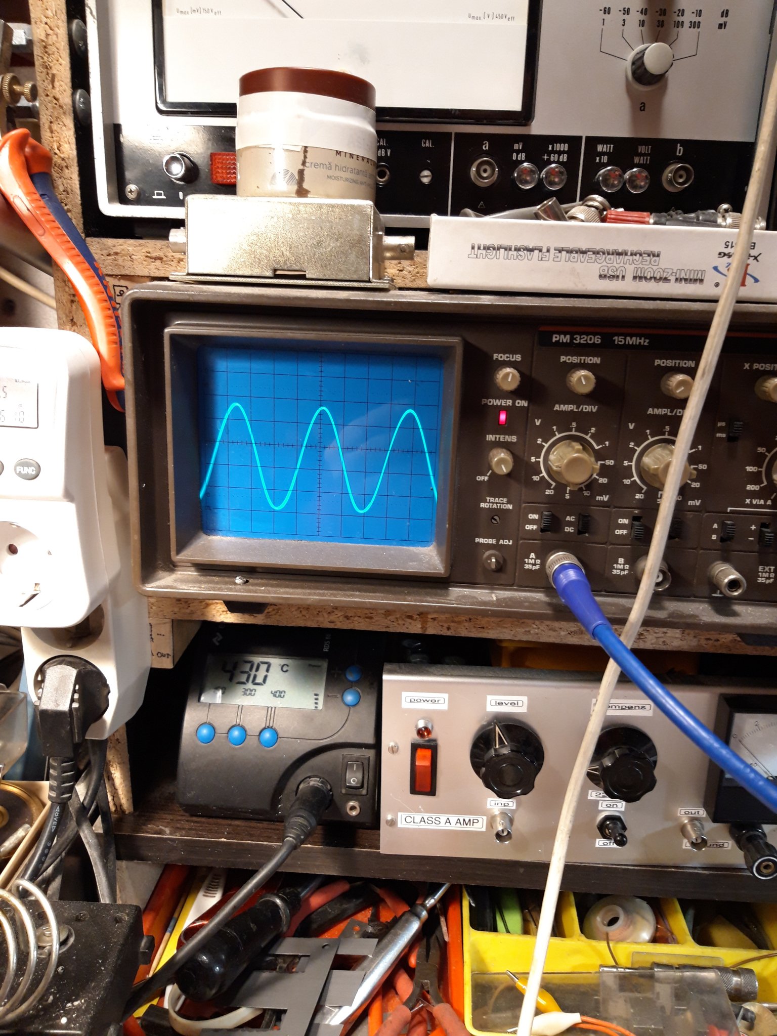

Hi ToddD,
sure this amp was built - I use it almost daily. Regarding the Zobel, please have a look at the plots. The book is still under work, about 700 pages done and still growing. Sorry for the short answer, I have to get some sleep.
Regards, Tom
View attachment 1025530View attachment 1025531View attachment 1025532View attachment 1025528View attachment 1025529

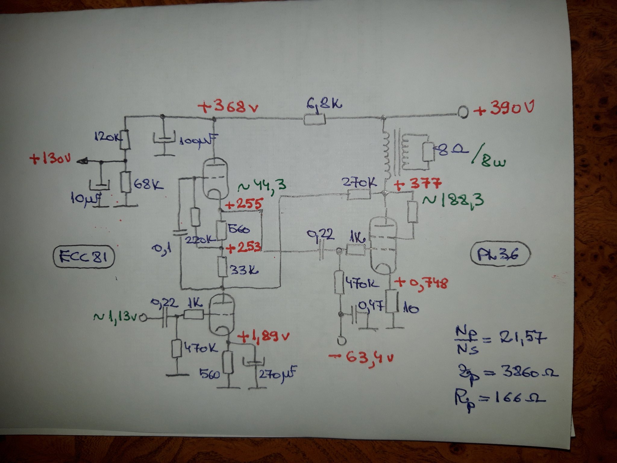

I am planning to build an el 36 se amp. Your amp looks great. Found a couple of schematics on the internett. Is it this one you have built your amp after? https://www.diyaudio.com/community/threads/pl36-triode-se.276028/page-2
I start from the premise that the television tubes allow an excess of dissipated power without affecting them too much so i set a working point over the dissipation hyperbola with 8w situation in which i managed to get 8w with1% THD and only at 9,4w the distortions suddenly increase. It probably be useful to simulate this scheme for which i think the data is sufficient. My experience with these tubes makes me belive that they last a few years in operation and are very cheap anyway
this looks promising, thanks for sharing!

popa marius:
Your findings are in line with my experience, EL/PL 36 can take some abuse. What is the primary impedance of the output transformer you are using?
I will try the feedback scheme (Anode of PL36 to G2 of EL183) in my amplifier.

popa marius:

Hi Peter,because I have an OT with multiple sockets in the secondary and primary I can accurately determine the impendance of the optimal OT depending on the static point of operation of the tube so for the variant tested by me it resulted 4 Kohm . The Schade type reaction is very useful but I recommend using ARTA software for optimization

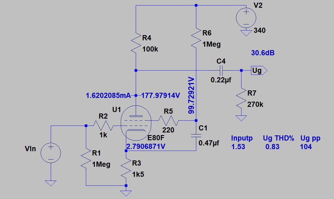

Dear Tom,
I am going to build up a PL36 based SE amplifier. I did like very much your one, which diagram is shown in Post #23, especially for the anode feedback. For reason of availability, I would like to use another driver tube, the E80F (very similar to EF86) instead of the EF95.
My problem is that I am not so good in designing. Could you please suggest which changes should I do for adopting that tube?
And could yo please provide the type of the output transformer, or at least its primary winding impedance?
And, did you make some modification in the meantime?
Thank you very much in advance for your help.
Kind regards
Giovanni

  • EF86 and similar tubes usually are operated at much lower currents (and much higher anode resistor values) than f.e EF95. One should at least check if the output impedance of an EF86 driver stage is low enough to drive the Miller capacitance of the power stage to the rather wide swing required without slewing by triode strapped EL36. EF95 at the given operation point certainly does.
  • To start with, EF95/ 6AK5 is extremely linear at the given operation point and required wide swing even before application of any FB (see post #67). Also, designed and used in millions as an RF / IF strip tube it still is cheap and plenty

Hi euro21,
please add about 75 pF (estimated CMiller of the trioded EL36)) in parallel to R7 and have a look if the simulation can drive 100 V peak-peak swing with acceptable slewing in the expected audio range, thank you!
Kind regards, Tom
