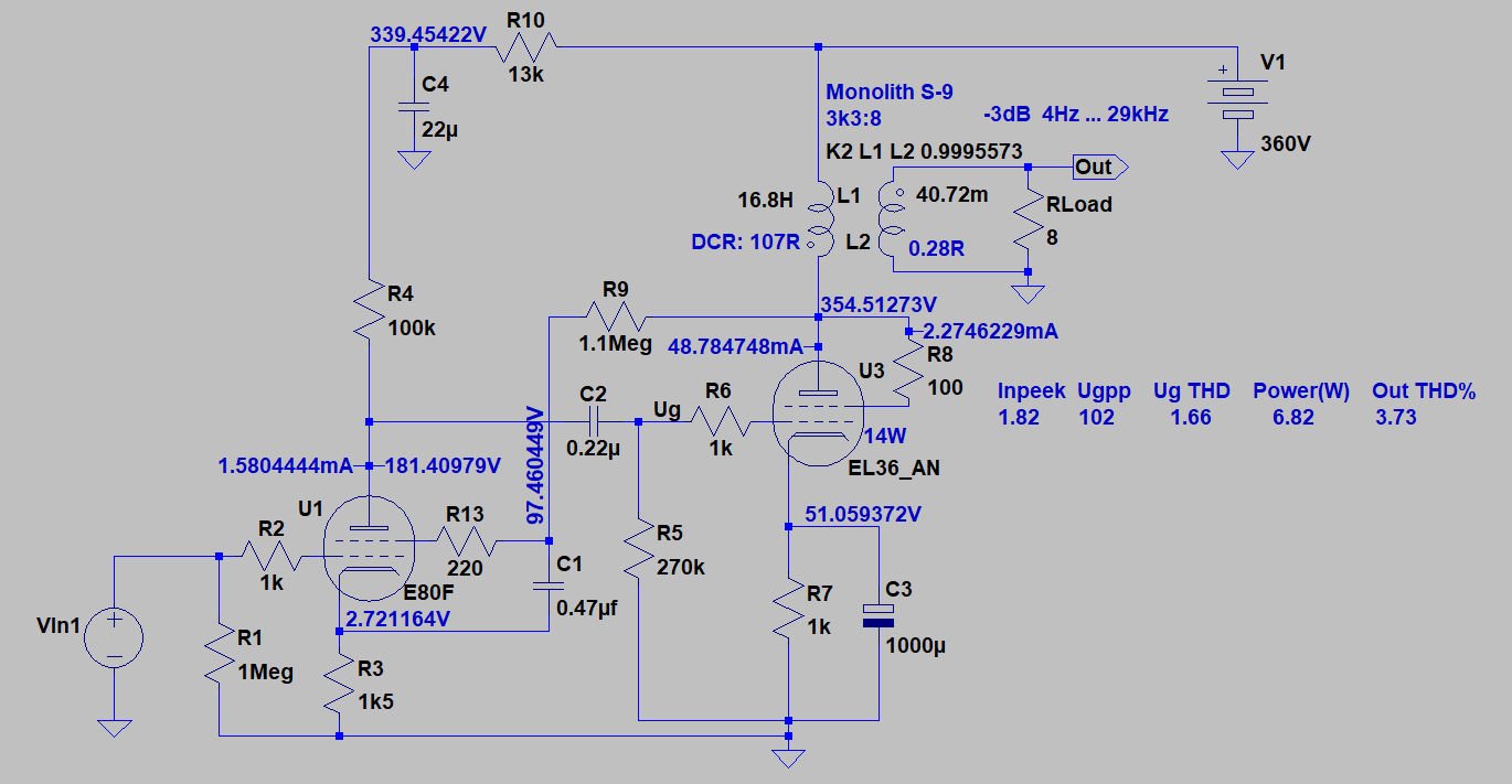

Dear euro21, I see now that you have posted a complete simulation while I was writing my answer. Is there a reason for not having inputed all the same values of original Tom's wiring diagram?
The e80f tube is not really suitable for driving Pl36, with a mu folower ecc81 driver you can get superior peerformants as we showed in a previous post

It shows how the E80F VAS stage can connect to EL36 output stage.Is there a reason for not having inputed all the same values of original Tom's wiring diagram?
The actual values depends on several parameters (B+ voltage, OPT parameters, EL36 operating point /depends on B+/ etc.).
For example possible LF behaviour (mostly bump at few Hz due to the OPT) determine the C1, C2, C3 values.
Tom tested its, his values applies to for the tools he uses (tubes, transformer, PSU).
If you change something (for example another VAS stage), need to rethink other values too.
Hi Giovanni, as popa marius has already noted, the E80F (hi quality EF86) is not an ideal candidate at this point. The circuits presented by him and mine from the beginning of this post will probably deliver better results. Both EL183 and 6E6P, 6E5P are dirt cheap. Fixed bias of the PL36 reduces the thermal load (cathode resistor) and increases output power.

Hi Giovanni, just try it out. When not satisfied you can easily change the driver tube and the few resistors around. I will try Tom's feedback scheme (Anode of PL36 to G2 of the driver) in my amplifier.
