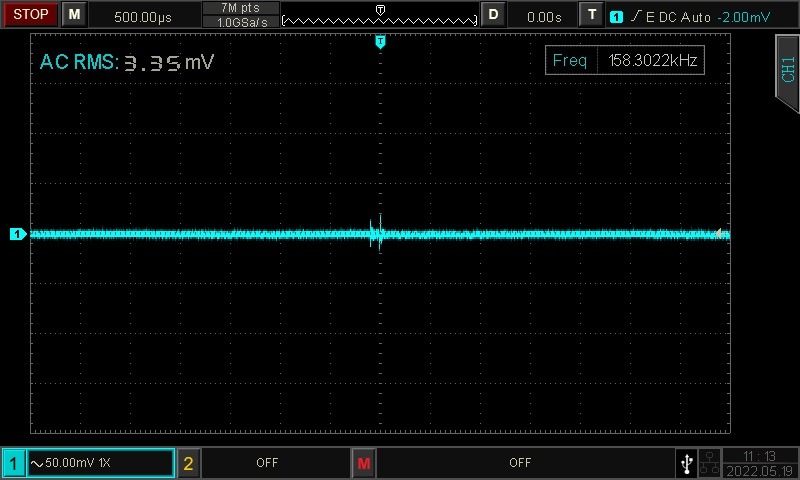

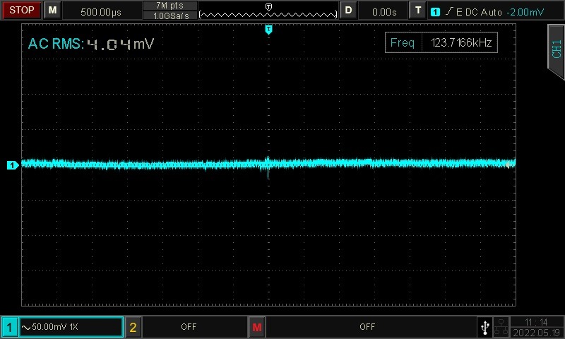

As illustration - noise caused by two transistors Q1 and Q3 (compare this to the traces in earlier posts):

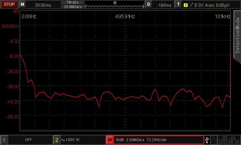

The clearest indications of big improvements are the RMAA tabel.

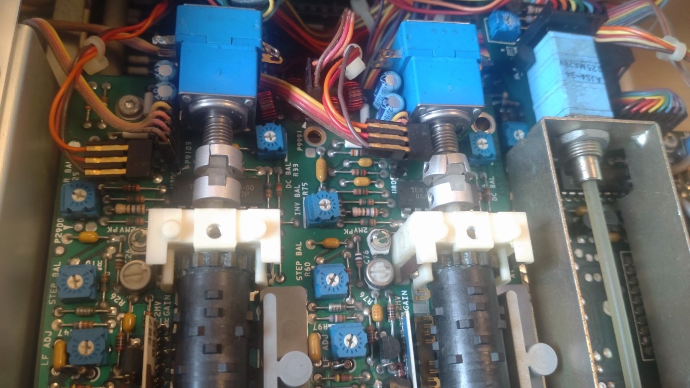

Must have been a well done repair. It’s been worked on before. red wima caps, ecaps are not original.
I replaced them in "phase 1" 😉It’s been worked on before. red wima caps, ecaps are not original.
