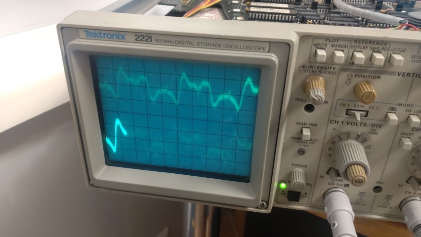

In other words - pull out a shielded signal cable of ca 3 cm makes a substantial difference.
Seems like the world of tube amplifiers...
I will play around with cable throws during the weekend...
vs that:

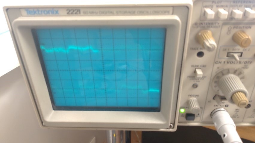

I've posted scope pictures above.

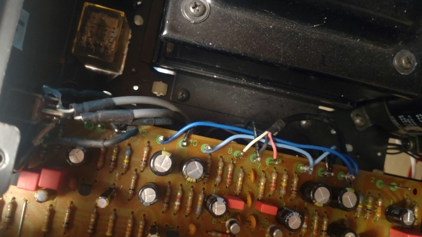

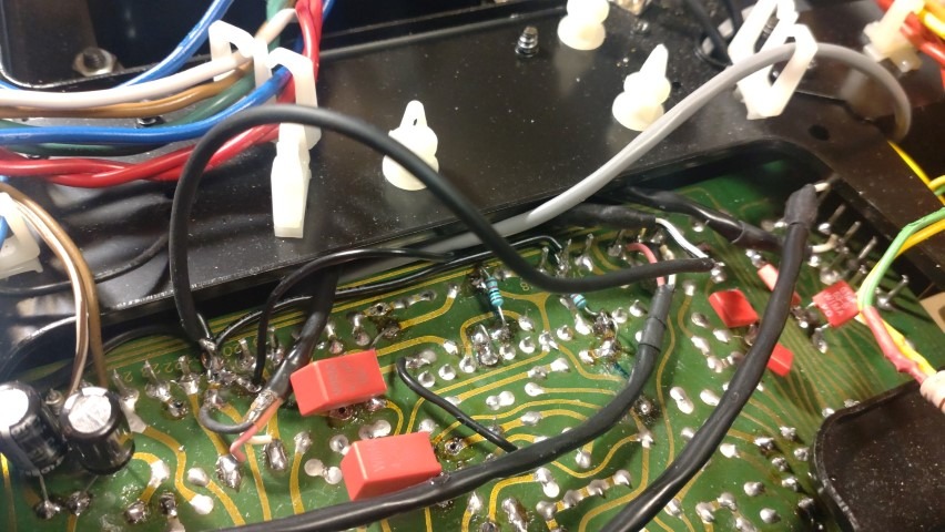

Today's startingg point (signal cable (into the Normal/Separated switch) is the topmost grey one on the left):

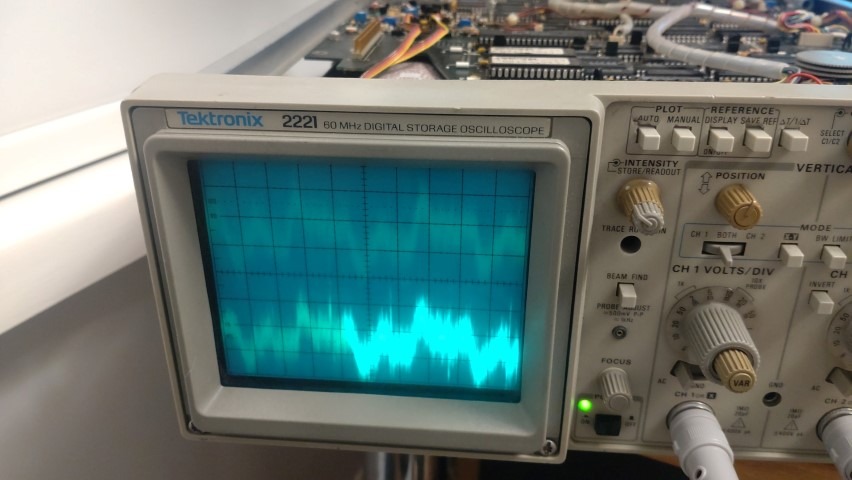

To get increase in picked up noise the only thing that I need to do is to increase the horizontal run of the cable along the transformer:

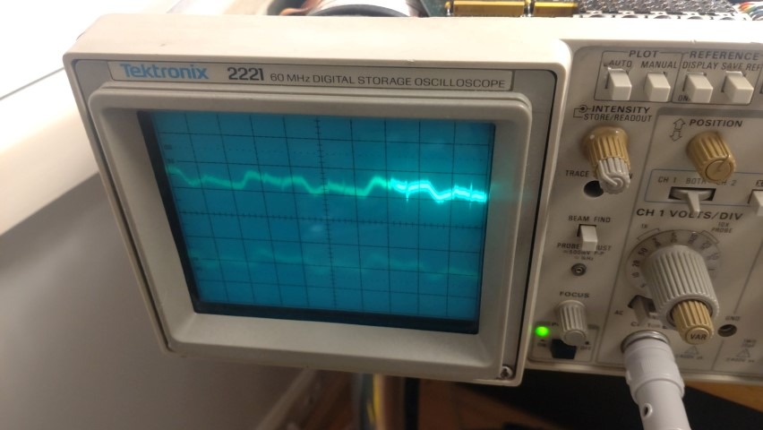

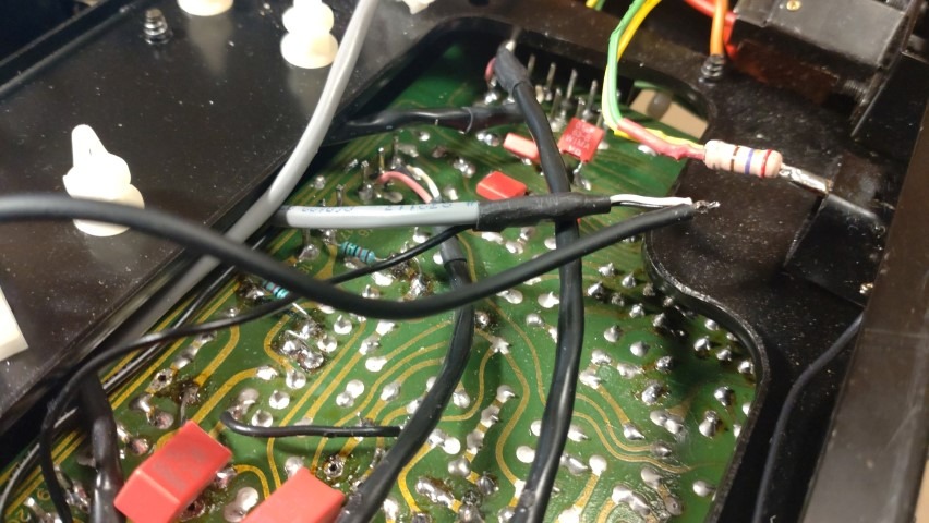

Ok, horizontal run along the transforemer (actually - distance 1 or 3 cm apart does not matter) is a no-no, pull the cable straight downwards from the switch:
and clean(er) we are:
And why was the hum not noticed before - probably the noise of the buffer amplifiers' transistors masked it - how it looks when connecting Tone switch to ON (i.e. passing signal through tone amplifier with regulators in neutral position):
One more thing I noticed - the bottom plate and top covers do not change almost anything - noise source seems to be dinitely inside.
Problem is - the transformer is located in the middle of the amplifiear and sihnal cabling runs around it for almost 360 degrees...

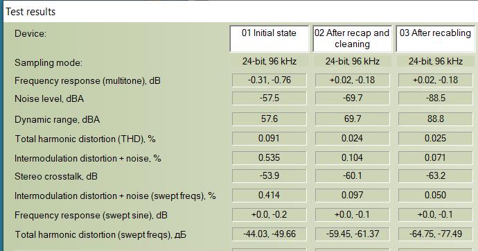

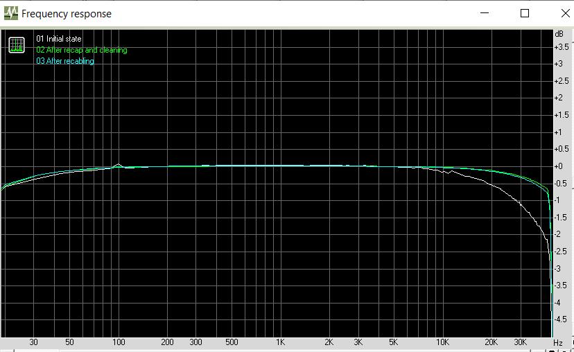

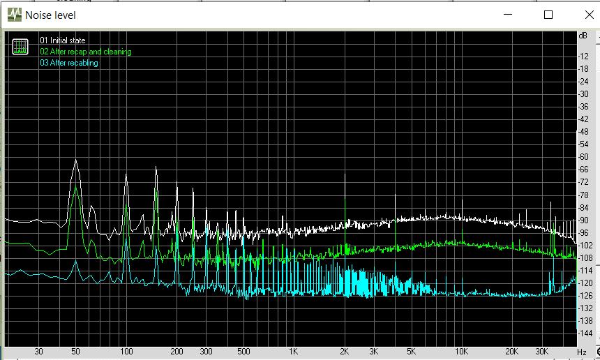

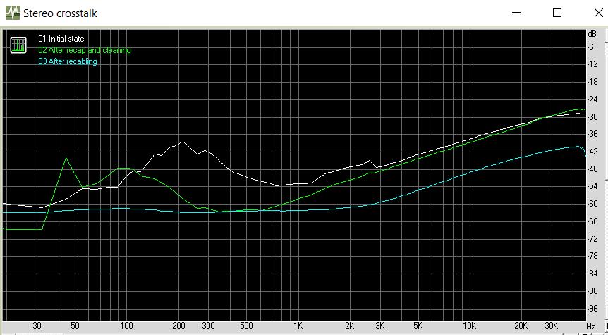

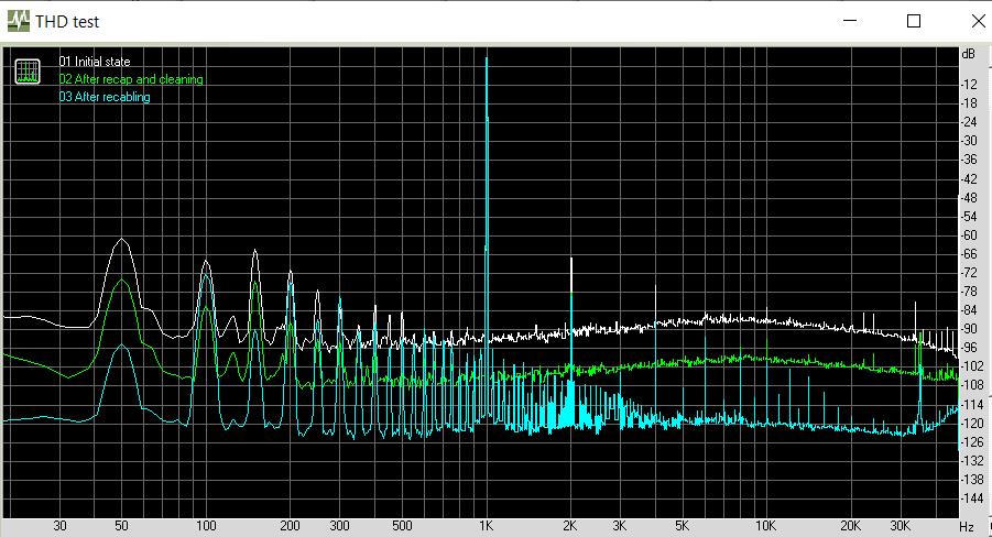

OK, wrapped this project up.
Some before-after comparison (RMAA measurements):
- step 1 is its initial state
- step 2 is after recap and cleaning the switches
- step 3 is after internal recabling.
That looks like a huge improvement on all counts. Very nice!
Do the peaks from the blue graph hide the green peaks or are there more blue peaks in the THD test?
Hugo
Hugo
I would suppose that there are more peaks in the blue graph (especially above 1kHz) and they may hide some of the green graph ones.
They seem to be related to the input signal level and vol pot position. If I turn the vol pot downwards then the higher harmonics are reduced.
In its current state I was more looking at the level of the 2kHz peak (and certainly the 50Hz one that I managed to get below the level of 100Hz one).
I guess it could be still improved when jumping the control amplifier (two transistors, 22dB gain) making the input path in Tone OFF mode completely passive but that would mean attenuating the tone amplifier output signal to the same level.
