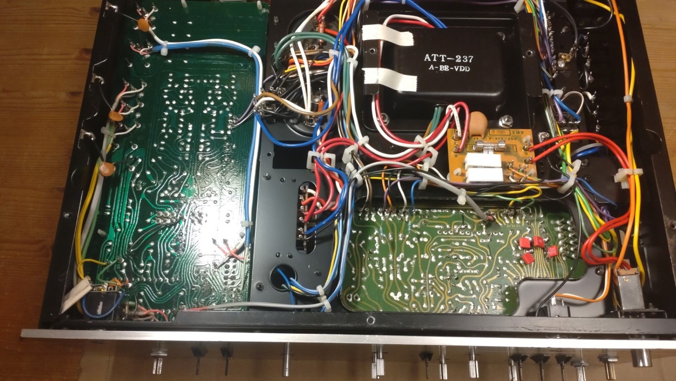

I wonder if the mains wiring inside the amplifer - on the right side of the photo, yellow, red and orange wires would be useful to replace with shielded ones?
Just as a precaution.
I also have a +/- 60V adjustable power supply but disconnecting the rectifier wirings (the transformer has two secondary windings) in order to provide external power (at two voltages) is a bit more than I would like to do as first step.
The photo is from the amplifier in its initial condition (the red Wima caps are from a previous technician).

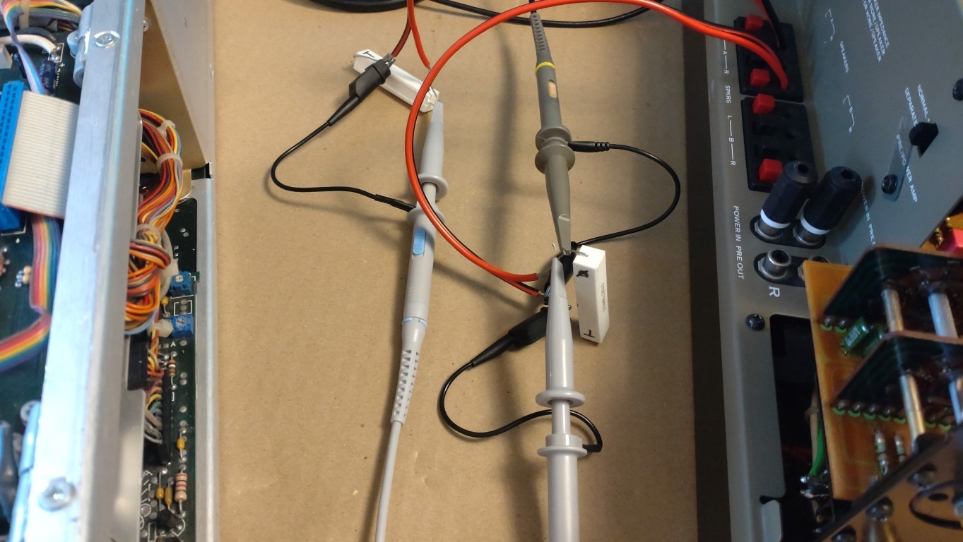

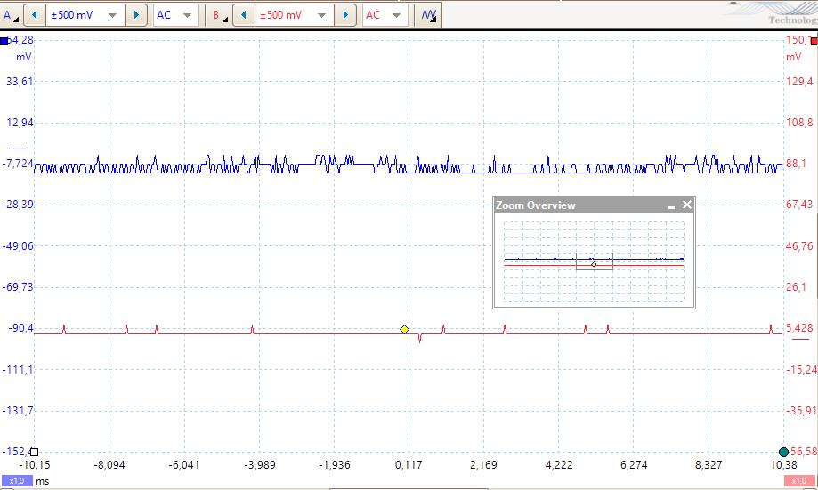

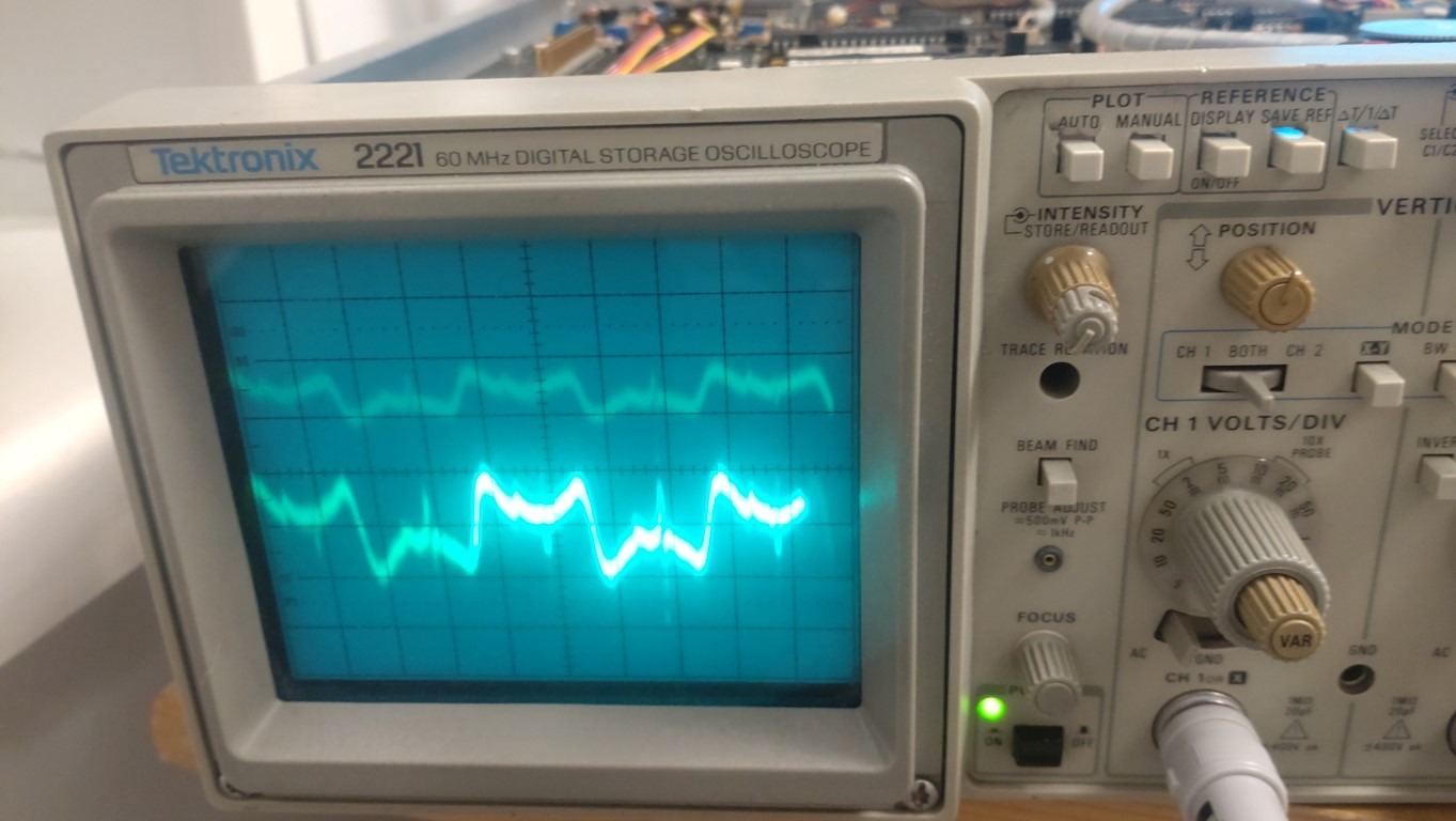

Warmed up the gear, yes noise is still visible:

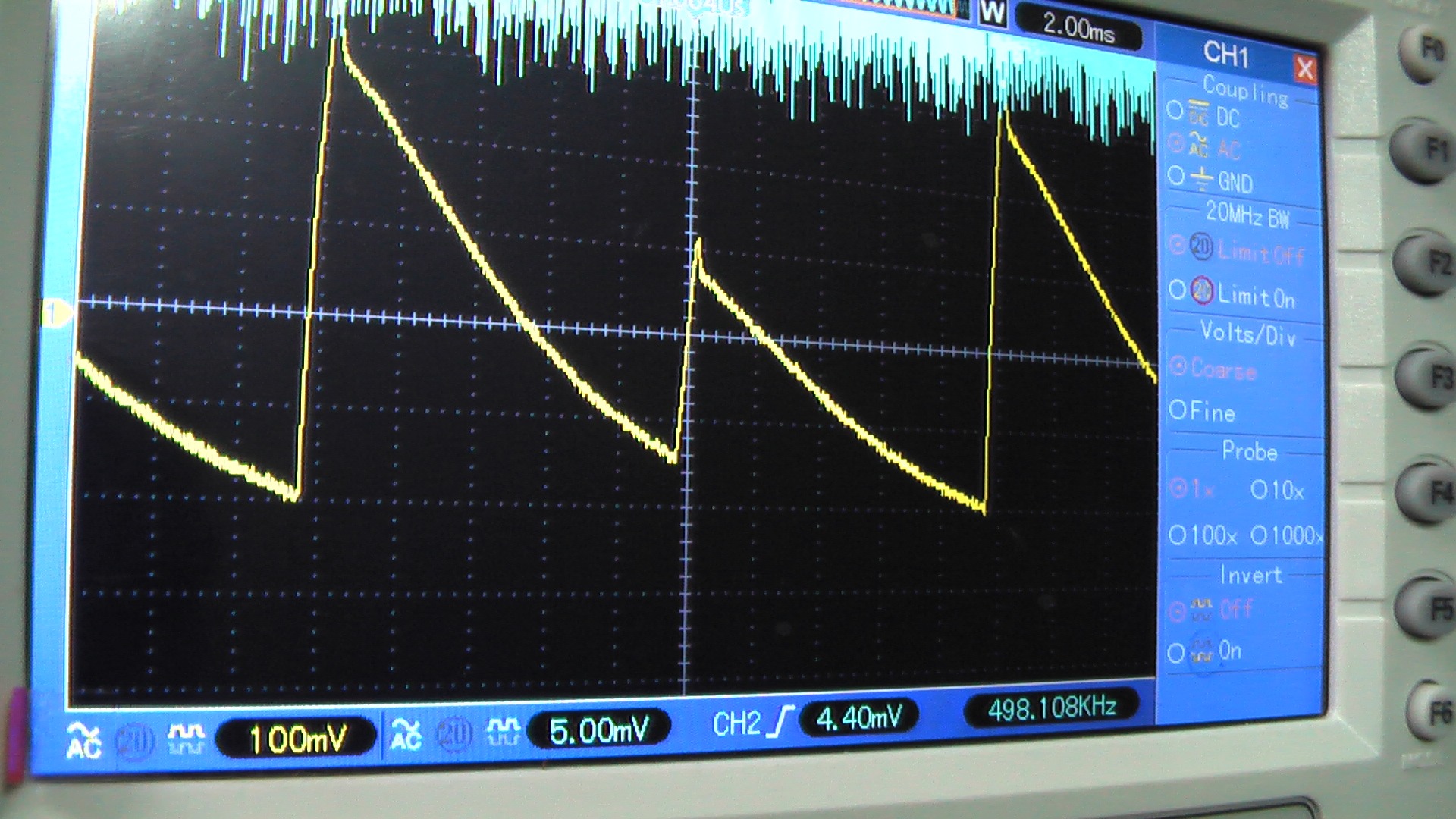

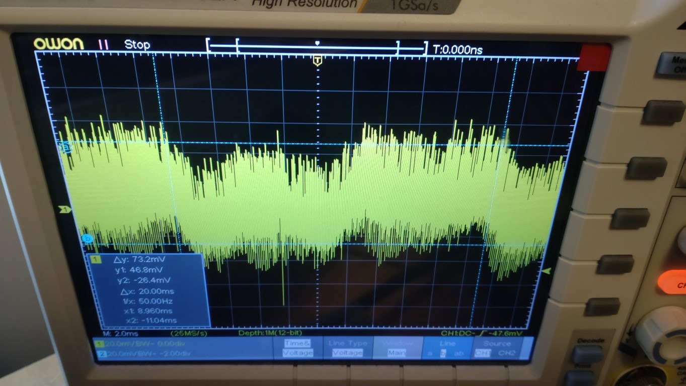

Should I use digital scopes?
Tried it out:
Picoscope:
Owon XDS2102:
Back to Tektronix then, vannot make much out from the digital ones.

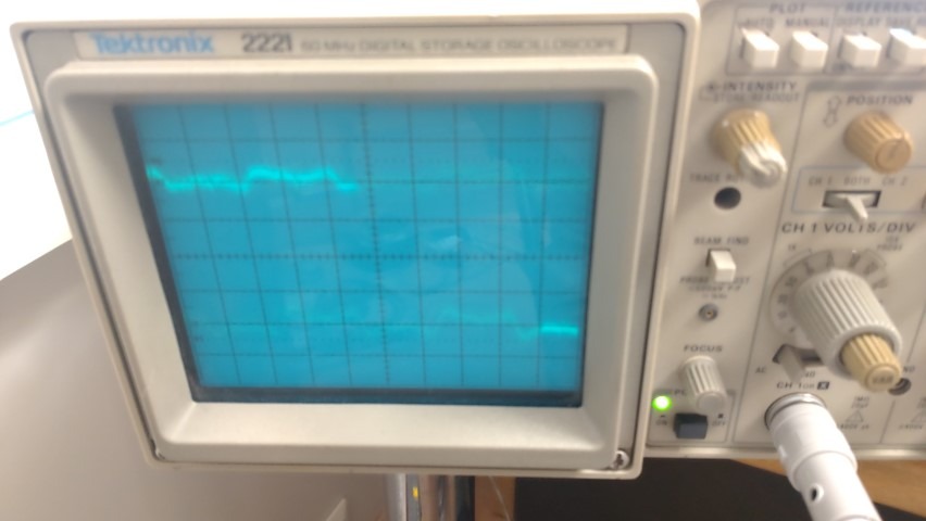

Left (upper channel) probe tip against my finger to capture ambient noise, right channel (lower) on speaker output.
Signals in opposite phase with slight shift?

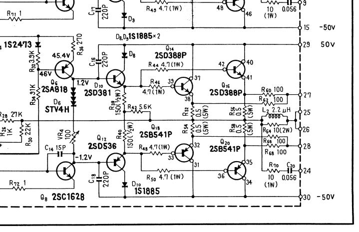

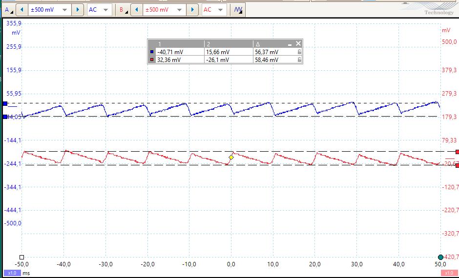

OK, B+ and B- on power amplifier pins 29 and 30 - nominal value should be 50V, DMM shows +50,4V and -50,7V.
AC wise there seems to be ca 50mV P2P pulsation on both rails:
Should I look at the rectifier?

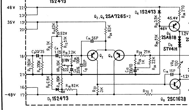

48V regulated rails (pins 16/17 and 22/23):
Measured values (DMM) +49,2V and -49,7V.
Looks clean on Picoscope
and also on Tektronix.
+35V (regulated) on pins 19/20 is also clean (as +/-48V).

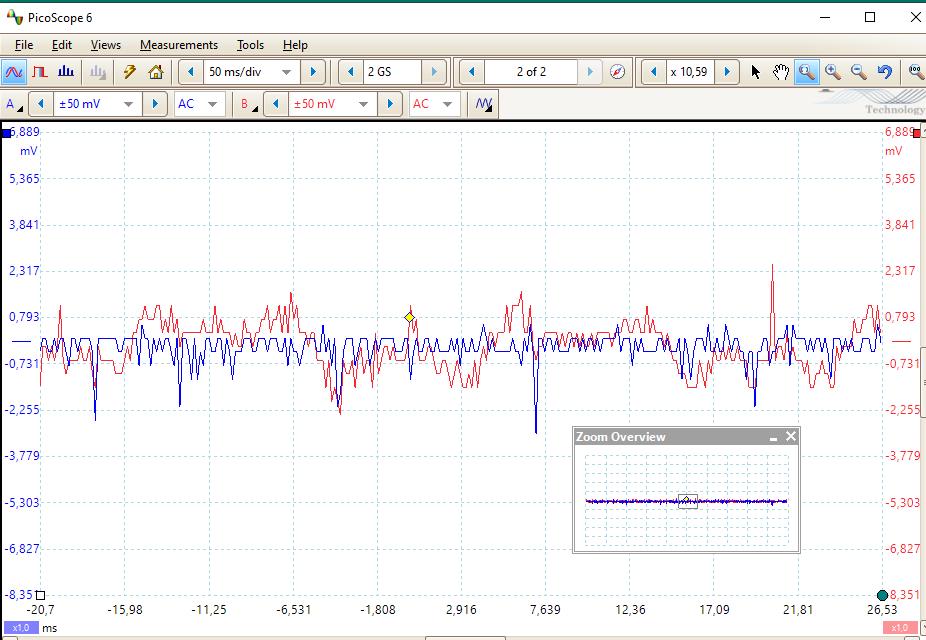

Post #26:
What is the vertical scale on the Tektronix?
The noise measured with the picoscope looks decent to me, +/- 0.062mVPP.
Hard to understand that there is so much difference between Tektronix and picoscope.
The Owon I don't get... 🙂
Nah, looks like normal ripple from unregulated supply. At 50mV p2p it's not to shabby/bad at all.Should I look at the rectifier?
Since hum is 50Hz I'd be looking before rectification.
I would conclude, looking at the noise figure from the picoscope that this amp is pretty OK.
I got the impression the Tektronix is fooling you. (Open case?)

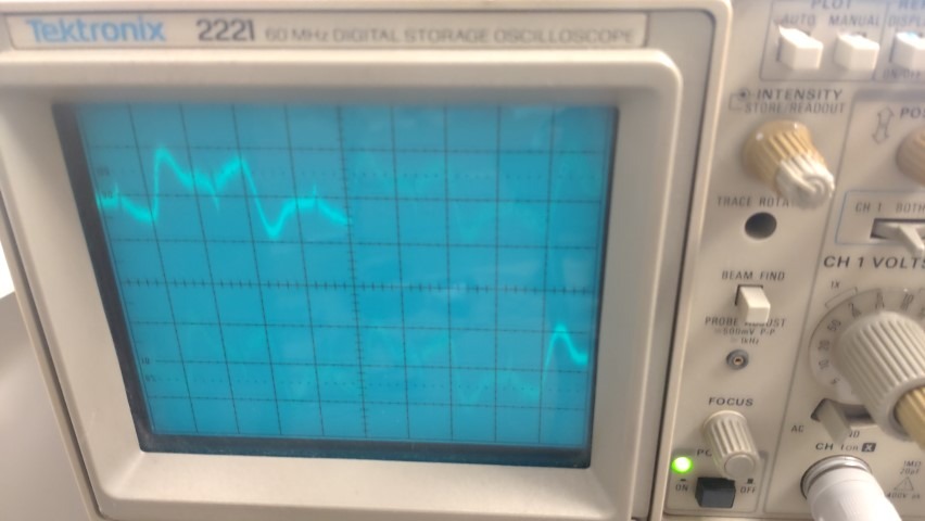

2mV per division.Post #26:
I kind of do not right now buy this 😉I got the impression the Tektronix is fooling you.

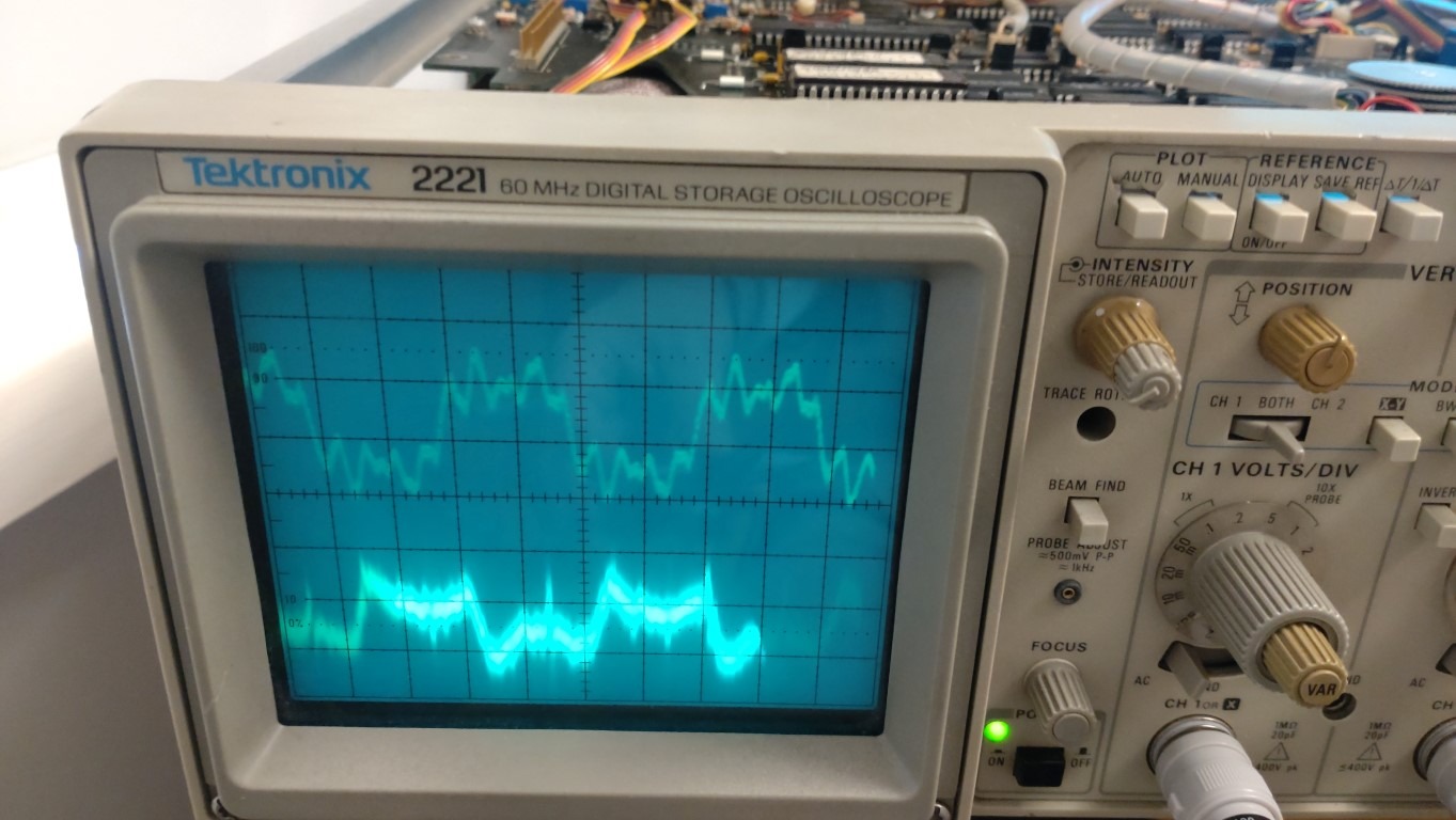

Brief update - I started shorting the signal path wires to ground and reached a spot where noise does not disappear.
Basically located at "two short cable flights with switch contacts between them upstream from Normal/separated switch".
I will do some more testing/eliminating and then post photos and more detailed results.
Another challenge has been to take photos of the slowly passing signal on scope screen with a mobile phone camera (max "shutter speed" only 1 second does not capture two channels too nicely on one photo)...
Midweek update:
I think I nailed something...
Now it is this:
