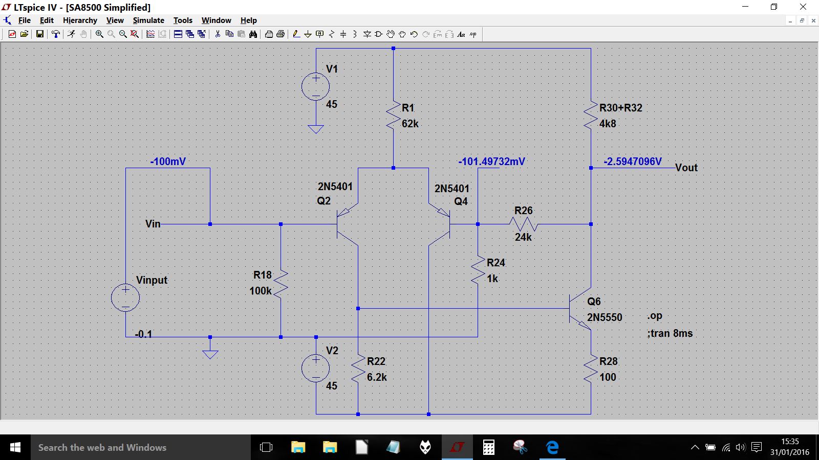

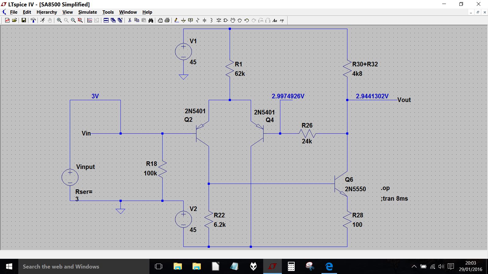

As you're obviously interested in this I might post a little diagram or two a bit later on to help you understand what is going on.
First and most important, don't feel you have to get heavy with this... its just for information on the basics of the input stage, but it should hopefully give a bit of insight into how it all works and how it comes together to make the complete amplifier.
The whole circuit splits neatly into 3 parts. First the differential stage around Q2 and Q4. Secondly the VAS (voltage amplifier stage) around Q6, and thirdly the output stage and their drivers.
We are looking just at the input stage and the VAS stage. (The output stage is like a 'bolt on extra' to give it lots of ability to deliver large currents into the speaker. We don't need that to explain how it works at this stage)
Now Q2 and Q4 are a bit like a balance or a set of scales.
Whatever input voltage we apply to the base of Q2, the differential pair as we call them will try and drive the output node of the amplifier to such a voltage that the base of Q4 equals that of Q2.
That's a bit of a mouthful so lets just break that down a little. Q4 has its base connected to the output node via R24. (R24 is what we would call the main feedback resistor). This means that whatever voltage the output node is at, the base of Q4 will be similar.
So the point the feedback resistor connects to is the point that is 'sampled' and used to balance the scales.
If we unbalance the scales by applying an input voltage to amplifier at Q2, then the output node is automatically driven so that it reaches a voltage that brings the scales back into balance.
For example, if we apply + 3 volts to the input, then the output responds by also assuming the voltage of +3. If we drive the input to say 5 volts negative then the output node does the same. All the time, the output is trying to bring Q2 and Q4 back into a state of balance.

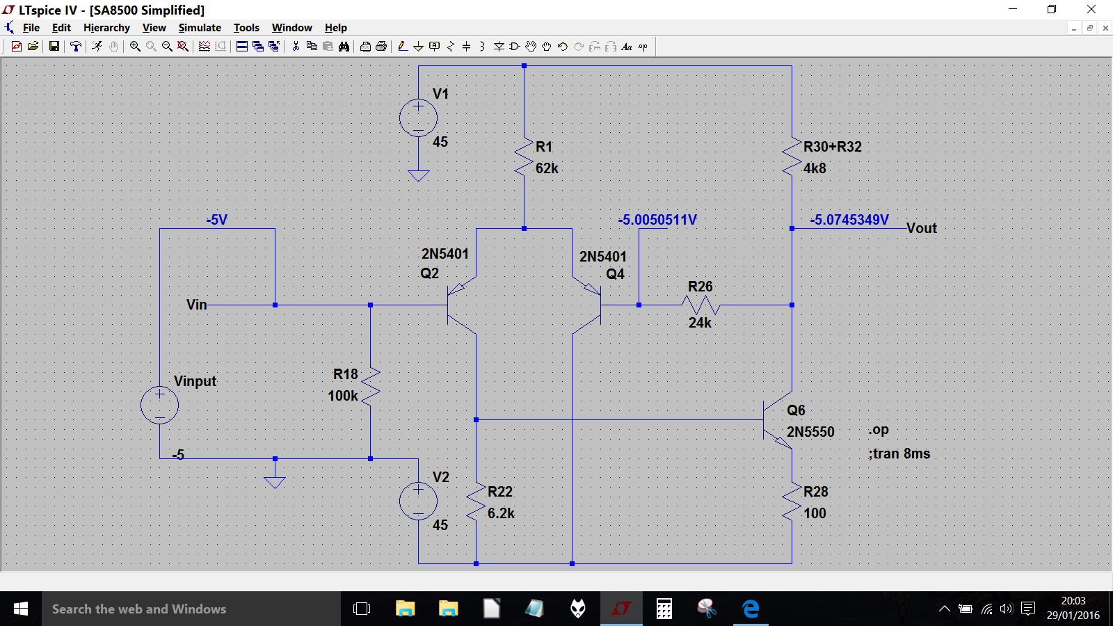

So here's your amplifier cut down to the essentials. No capacitors are needed yet. You'll perhaps notice that at this point the amplifier only seems to have a voltage of 1 or unity. Giving it gain is the next bit of the puzzle and is done with just two components.
This diagram is more than just a drawing, its a working simulation where we can explore how it all works and what the effect of changing parts would be.
So here it is with +3 volts and -5 volts applied. The simulation has put these voltages in automatically, not me.

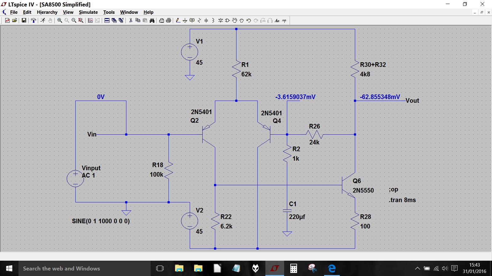

And the voltage gain thing... why only a voltage gain of 1. Well if you look at the circuit you will see R24 and C10 connected to Q4 base. With AC signals (music) the cap appears as a short... it passes the AC. So pretend that's linked out. That leaves us with a voltage divider of R26 and R24.
So how are the 'scales' kept in balance now ? Well the output must now rise enough to still keep the voltage at Q4 base equal to Q2 and that means it must rise by a factor that overcomes the division ratio of those two resistors. So we have gain, as much or as little as we want, and its all set by altering the ratio of those two resistors.
And here is the simplified version with the magic 'gain giving' resistor added. The numbers don't work out absolutely correct because of slight imbalance in the circuit and the fact its not really designed to work at DC. The theory holds good though. If we added the cap in series with R26 then the gain is always 1 at DC (a good thing, we don't really want fully DC coupled amps) but has a gain equal to the ratio of the resistors at AC.

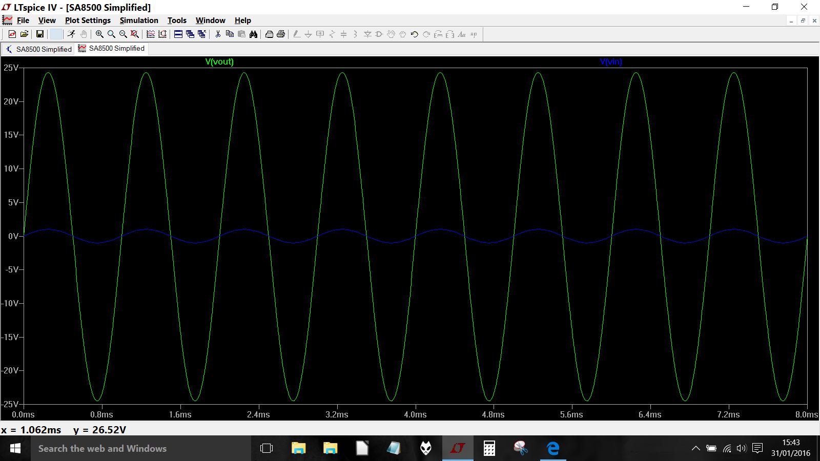

The gain is Gav = (R26/R24)+1
And adding the cap and looking at an AC input signal of 1 volt and we get 25 volts AC output.
Here is the cap added. Notice the DC values are now just nominal 'offsets' with the AC waveform now present.
And here is the output and input voltages for comparison. 1 volt in, 25 volts out.

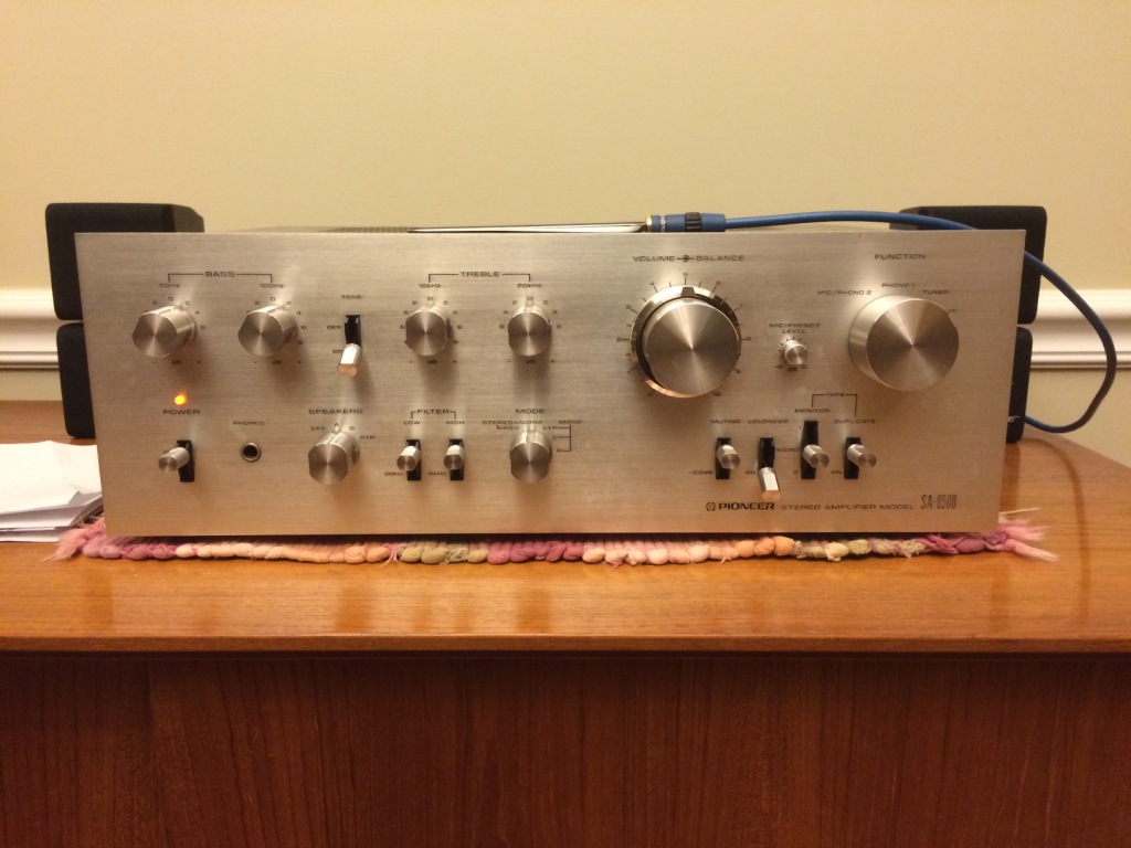

So, I ran the SA-8500 yesterday for about 6 hours hooked up to a pair of Bose cubes. No issues, no over-heating, no relay clicks...
So I'm following you more, just takes a bit to soak in. Again, I need to read up on how amplifiers work from inputs to outputs and everything in between.

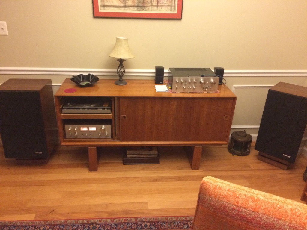

Also, my primary set up is an SA-6700 Amp, SG-9500 EQ and Technics SL-3300 TT. What do you guys think of the SA-6700 vs. SA-8500?
Personally, I really like the simplified looks of the SA-6700 as well as the VU meters, but prefer the added functionality of the 8500: more power (60WPC vs. 30WPC), low/high filters, muting and 2nd phono stage.

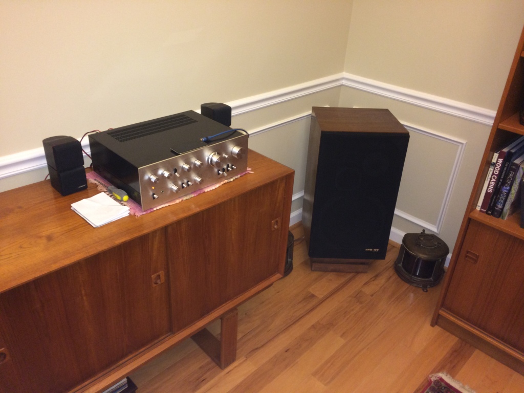

Anyway, here's the SA-8500 driving my expendable Bose cubes. As I said, it ran fine yesterday for a good 6 hours. So my dilemna, is do I replace my SA-6700 with the SA-8500? I will be temporarily setting things up with the SA-8500 just to hear it on the HPMs!

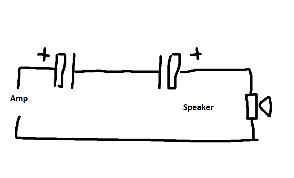

Running an old amp with unknown history (and a fault that has kind of healed up on its own) into expensive speakers is a gamble. That doesn't mean its going to self destruct and take your speakers with it... but you have to be realistic and realise that these are old products and that there are some parts that have a reputation for failing such as that series diode chain do-dah. They crop up in many products and they do seem to fail judging by the reports.
You can make the amplifier 'speaker safe' by incorporating two back to back large capacitors in series with each speaker. Each cap must be the same value and they would need to be rated at 63 volts and have a value of at least 6800uf. The two in series would create a single bipolar cap of half the value of the two used. You could use something like this temporarily until you 'trust' the amp or permanently. If the caps are to small in value then the bass is attenuated.
It all looks good by the way 🙂
I've heard of using fuses to create a speaker protection circuit, but not capacitors. I assume these would be inline on the positive lead to each speaker, right?

Fuses can be OK... the downside is that they take significant time to react if they are sized to allow the full output of the amplifier to be developed. That said, there is a world of difference between running an amp at its full output (sinewave testing) into its rated load impedance (4 or 8 ohms). For music you might typically get away with a fuse that's quite a bit smaller. Fast acting fuses would protect better than slow blow.
Fuses are a very workable option though. If you want to do that then try something like a 2 amp fast blow and see if it survives your typical usage.
The series caps mean that DC can never pass into the speaker and so its essentially 100% safe from most of the destructive faults that can occur.

I'll look into creating some series cap protectors. Sounds like something every vintage enthusiast should have in the mix.
