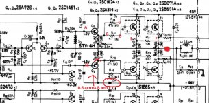

OK, Q6 (Left) is at .544 V while Q5 (Right) is at .729
That is very suspicious. See what is on points A and B and then re-check the B-E across Q5 to be absolutely certain.
0.7 volts should be turning it fully on and pulling the output negative and its not doing. This is typical of the kind of failure I was thinking of right at the start in mentioning these transistors.

Mooly, when I'm measuring voltages at the points labeled on the diagram, am I connecting black meter lead to ground and the red lead to the point I'm trying to measure and compare?

The transistor arrowed should have no more than around 0.6 to 0.7 volts across B and E.
There is also a diode. Check that its not open circuit. There should be MINUS say 45 volts on each end give or take.
Yes, black meter lead to ground for checking those voltage.
When we check the base and emitter voltage (this magic 0.6 to 0.7 number) then we measure across the junction with one lead on the base and one on the emitter.
For the NPN devices the base will be the more positive, for the PNP's the emitter is the more positive.
Arrows pointing out on the transistor symbol are the NPN devices and those pointing in are the PNP.

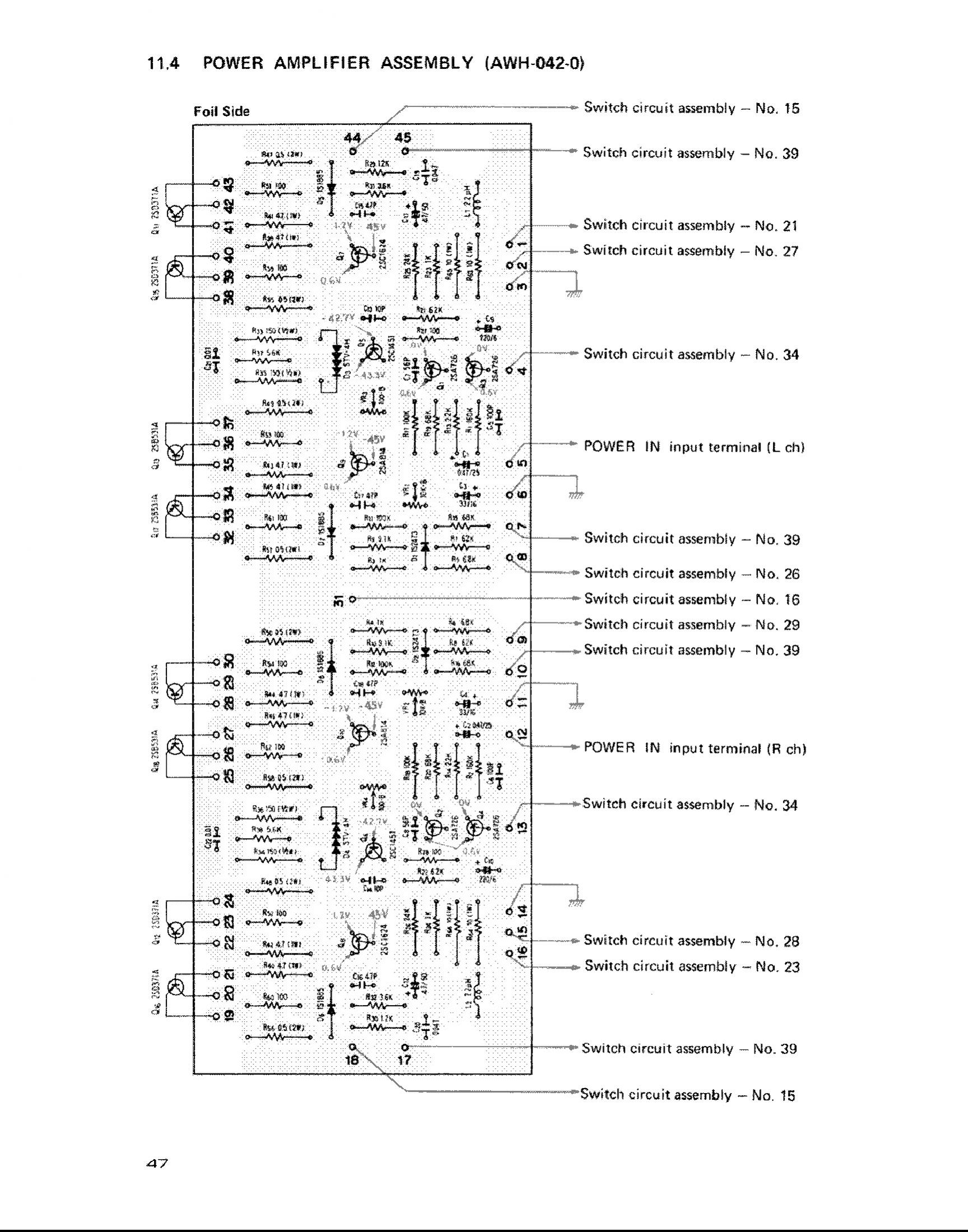

Mooly, I'm trying to compare your diagram to the one in the SA-8500 service manual and I don't think they are the same. Note I have a Mk I, original 8500, not a Mk II.
Chris, your references of Q5 and Q9 are for left channel. My issue is with right channel, so do you mean Q6 and Q10?
Its vitally important we are working to the same (and correct) diagram.
Do you have the correct one you could post ?
So I'm measuring voltage at transistor points indicated on my schematic with power on.
Right Channel.
Q10:
1 lead should be 45V, I get 43
The other 2 should be .6 V and 1.2 V, my measurements on those two are constantly changing. I'm getting 11-30 V on one and 15-22 V on the other.
Q4:
1 lead should be 0 V, I get 7-8 V fluctuating
Another lead should be .6 V, I get 7-8 V fluctuating
Q2:
Another lead should be .6 V, i get 7-8 V fluctuating

We need to be working off the same diagram. Back in post #17 you mentioned Q5 (right channel), now you are on even numbers 🙂
Its no problem, but we do need to be clear on what we are working on.
Do you have a circuit diagram that corresponds to your MK1 version ?
I might have the same manual as that one. Is page 47 a yellow board layout with the circuit diagram on page 48.
That's the printed page numbers, not the pages as they appear on a pdf reader.

OK. Now I'm going to have to leave it for tonight but what you need to do is tell us which channel is the problem one (odd or even numbered component references) so that Chris and myself (and anyone else 🙂) knows what the score is.
It looks like you are working on the evens... yes ?
We also really need to be working from the circuit diagram rather than the board layout which means you need to be familiar with the symbols.
