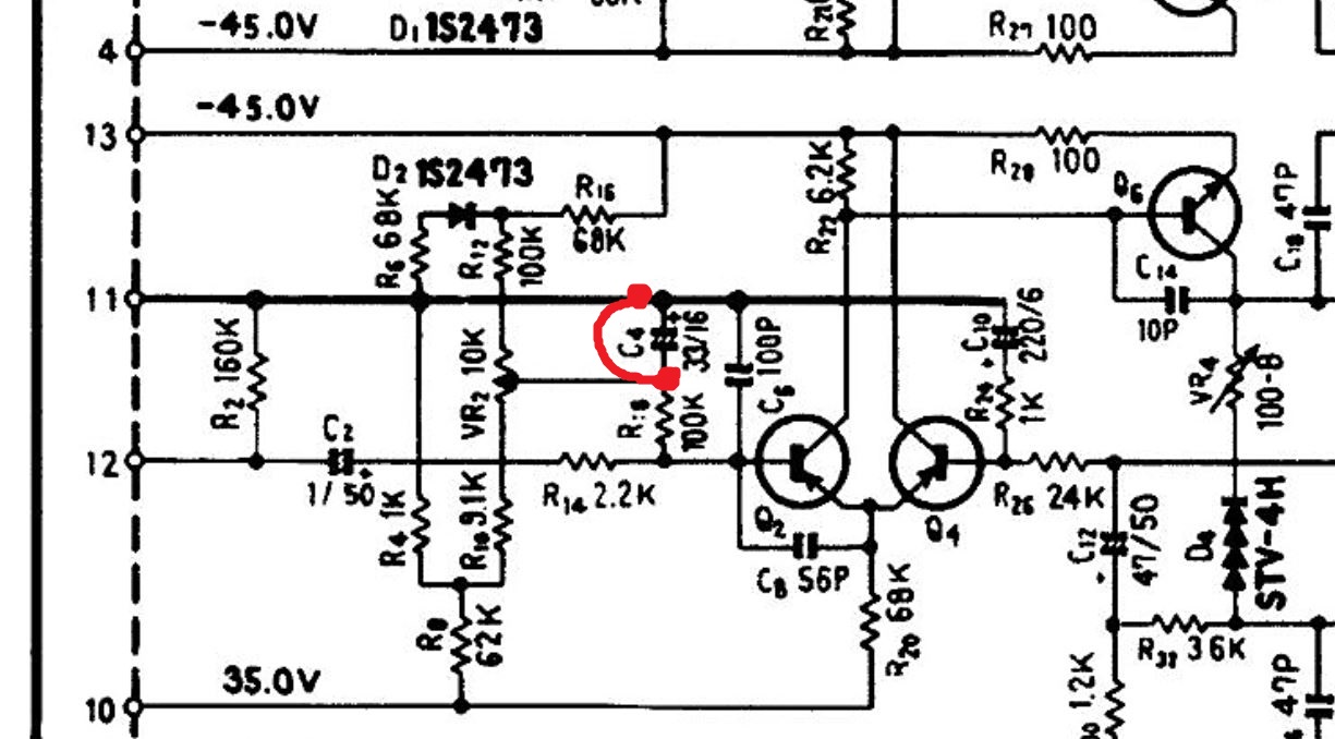

Mooly, with this second short you speak of, can you illustrate on the diagram so I get it right. Thanks.

OK, one more thing. Should I replace the C2 input cap before these next steps:
1/ Leave the short in place.
2/ Lift R18 (the 100k)
3/ Measure the voltage across C4. It should be steady.
4/ D2 should have around 0.6 volts across it by the way.
So the big question... what if its not the control or the diode ?
Well any of those resistors around the diode and control could be faulty but its unlikely. What we would do in that case is one further simple test which is this.
1/ You remove the short previously applied and refit R18.
2/ You now short out C4 instead which now holds the base of Q2 to ground via the 100k (R18). That's a much higher resistance than the 2.2k it was seeing before with the first shorting link but as long as Q2 is OK then it should behave exactly the same.

Ok, with R18 lifted,
C4 is steady at +.065 V
And D2 is +.592 V Across
I'm also hearing the relay click on startup now, but also a couple times with power on for a few minutes during each test.
With the second short, Q2 Vbe is .59
B V is -15 to -16 V (small fluc)
E V is -13.2 to -13.3 V (small fluc)
C V is -40.9 V
Q4 Vbe is .53 to .54 (sm fluc)
B V is -10 V
E V is -14 V
C V is -43.5 V
Those Base and Emitter values should be down at 1.2V and .06V, right?

Where are we up to ? The measured C4 and D2 voltages look OK
We're so close at this point 🙂
Relay clicking. This could well happen if you are measuring voltages around Q2 and Q4. Applying the meter can suddenly change the DC conditions and the relay circuitry thinks there is a fault and isolates the speaker. When you are not measuring then the relay should click once at power on (as it normally would).
At this stage you should still be at the condition where the DC offset was steady at around 0.1 volts.
Is that correct ?
If the above holds true then we move on to replacing the first short with the second.
So you should now be at the stage of the amp being configured as in post #63 above. The first shorting link has been removed, and a new short added across C4. I think you still have C2 removed at this point... that's OK.
The amplifier should still behave as it did in the earlier step. Offset steady, even if its a little higher or lower than the 0.1 volts you measured. As long as the offset isn't to far from zero and is steady then the relay should click once as normal to connect the speakers.
Does it pass or fail at this point ?
If it fails, refit C2 and retest. (there's a valid reason for doing that)
If its still not behaving and the offset is not steady and low in value then we look at replacing Q2 and Q4

Mooly, a bit frustrated...
I went back and rechecked everything starting here:
1. C2 input cap removed.
2. .5 Ohm: 0 to -4 V fluctuating
3. Short in place between C4 and R6.
4. .5 Ohm fluctuating -.04 to -.16 V (i thought I had a steady reading yesterday)
5. Lifted R18
6. V across C4: .05 V and steady
7. V across D2: 0.58 V and steady
8. Moved short to C4+ and R18 lifted hole (VR2 side)
8. .5 Ohm shot up to -35 V and right channel heat sink got noticeably warm
9. Shut things down and removed 2nd short.
10. Replaced C2.
11. .5 Ohm: -.02 to -.21V
So now I'm at a loss? Thought we were making headway, but with the first short in place and voltage still fluctuating???

Step 8 above. You need the 100k (R18) back in place. That's why the output shot to -35 volts.
Is the offset steady under those conditions ?

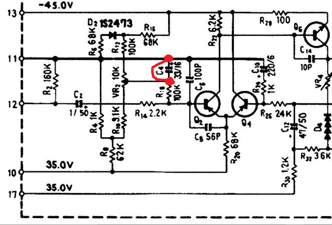

The second short should look like this. All the other components to be in place.
There are only two possible outcomes.
1/ The amp works correctly with a stable and steady DC offset that will be a little removed from zero. If its not to high then the relay should click and the amp should play music.
2/ The offset is still varying which points us to the transistors as being suspect.
(That statement is based on the earlier result that the offset was very much improved from its original -5 to -8 volt value and had come down to just 0.1 volts or so when we did the first shorting link)
