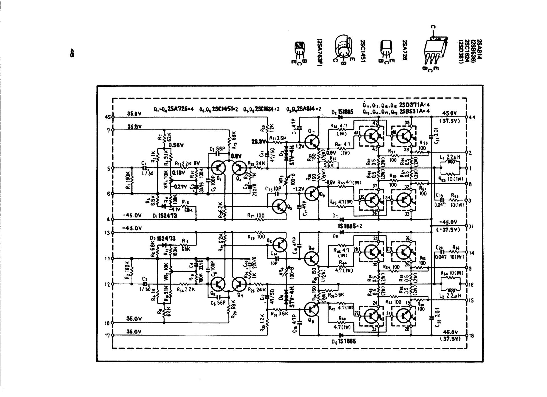

Lets start again at the beginning. The fluctuating readings are odd so we need to look at a couple of basic issues first. If you are measuring on the PCB print or even directly on component legs and leads then its quite common for oxidation and lacquer to be present that prevent the probe making a good contact. Measuring on print and its easily dealt with by firmly pressing the probe point into the board or the solder and twisting it to really push the point home. Component legs are more tricky because its so easy to slip and short something out. So you need to be careful. Also be sure that the black lead is securely attached to an appropriate ground point on the chassis so that it has a good connection.
Measurements.... All these are with the black lead on the chassis.
1/ Recheck the voltage on the 0.5 ohms. Be clear when describing a voltage because the polarity matters. Is it 40 volts positive for example, or 40 negative.
Whatever you see here should be constant. If it genuinely isn't then we need to start looking at other things.
2/ We always check supplies as a first golden rule of fault-finding. There are six important ones per channel here.
a/ Plus 40 volts on the collectors of Q12 and Q16.
b/ Minus 40 volts on the collectors of Q14 and Q18
Those are the four output transistors.
c/ There should be plus 40 volts on both sides of D6
d/ There should be minus 40 volts on both sides of D8
Now look at the lower left of the diagram and the points marked '13', '10' and '17' and the voltages shown.
e/ There should be minus 40 volts on both sides of resistor R28 (100 ohm)
f/ The two voltages marked '35 volts' at the lower left should be present on one end of both R8, R20 and R30.
Note... service manuals aren't always very exact in voltage given so don't worry if the 40v is 43v or 47v and the 35v is a bit different and so on.
Lets how you get on with that for starters.

Also, I tried posting one diagram, but resolution gets lost when pulling page from PDF and converting to JPEG. And the diagrams in the service manual PDF are hard enough to read as they are. I pulled my service manual from hifi engine if you can get it from there.

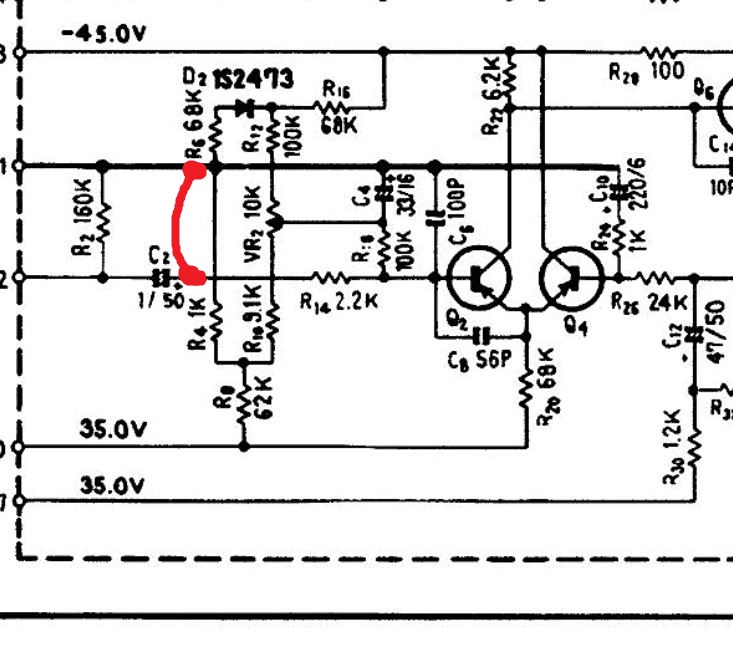

Getting somewhere...
1. I pulled C2 and still had -7 to -9 V at the .5 ohms.
2. I had previously turned VR2 to both ends with no effect on readings. I placed the jumper where you indicated and the .5 ohms now read +0.1 V and appear steady. Note, this is with C2 still removed.
Bad VR2 pot?
Your move Mooly ;-)
Excellent. Now we might be getting somewhere.
Its well worth measuring the voltage across D2 before doing anything else. It should be steady but with a tiny voltage drift as it warms. Yes, it could be the pot itself... it could also be any of the other components around there as well.
What you could do as a test is this,
1/ Leave the short in place.
2/ Lift R18 (the 100k)
3/ Measure the voltage across C4. It should be steady.
Looks like we are on to the problem though.

That's right, the short is actually a valid condition for biasing the transistor Q2. What you have is the base of Q2 returned directly to ground via R14, the 2.2k resistor. We leave the short in place while you lift R18 as Q2 base must never be left floating. It keeps the amp happy.
The network of resistors, VR2 and the diode simply allow Q2 base to be swung a little in each direction and so trim the offset to zero. As measured from ground the control VR2 will have something like +0.2 volts on one and -0.2 on the other. You can check the other channel to confirm that. The voltage on each end of the control should be rock steady. All this allows for Q2 base to be pulled a little each way depending where the control is set to, and that allows us to trim the offset to 0.000 volts (when its fixed 😉).
So the big question... what if its not the control or the diode ?
Well any of those resistors around the diode and control could be faulty but its unlikely. What we would do in that case is one further simple test which is this.
1/ You remove the short previously applied and refit R18.
2/ You now short out C4 instead which now holds the base of Q2 to ground via the 100k (R18). That's a much higher resistance than the 2.2k it was seeing before with the first shorting link but as long as Q2 is OK then it should behave exactly the same.
What would that show... well it should still give a stable DC offset at the amp output just as before. The offset will be a little higher or lower but that's no concern if its steady. If it passes that then we know for certain that the problem is with that little network of resistors, or the control, the diode or C4.
If by chance the fault still showed in this condition then the finger of suspicion would move straight away to Q2 or one of those two small caps connected to the base (the 56pf and 100pf).
Applying a short as we have done at the moment (the first one) is a brute force method that firmly holds the base of Q2 at approximately the correct value for everything to work. If Q2 had failed in some bizarre way (intermittent and/or intermittent low gain) then its failure could be masked by the brute force method of the first short we applied. The second way bringing the 100k into play instead would show if that were the case.
