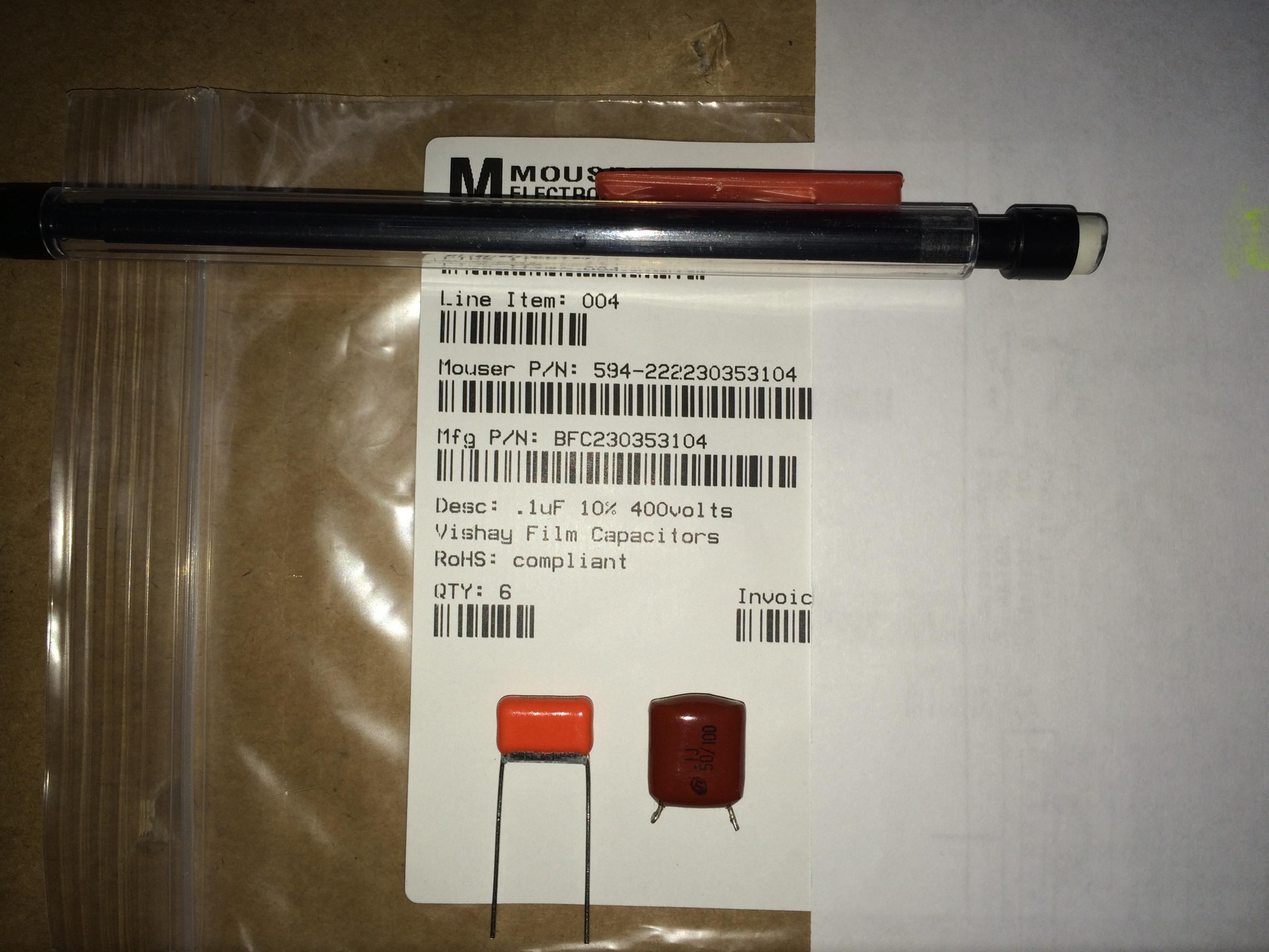

So just want to make sure I replaced like caps on the left output assy. Service manual indicates C39/C41 are .1uF/100v and I used .1uF/400v.
That idle current is crazy, man. Your channel there is obviously oscillating. If you're not getting any sound but you still can measure DC offset, then the relay hasn't tripped, unless you're reading that offset before the relay, rather than on the speaker output terminals.
And that cap should be fine. But you have bigger problems than that.
