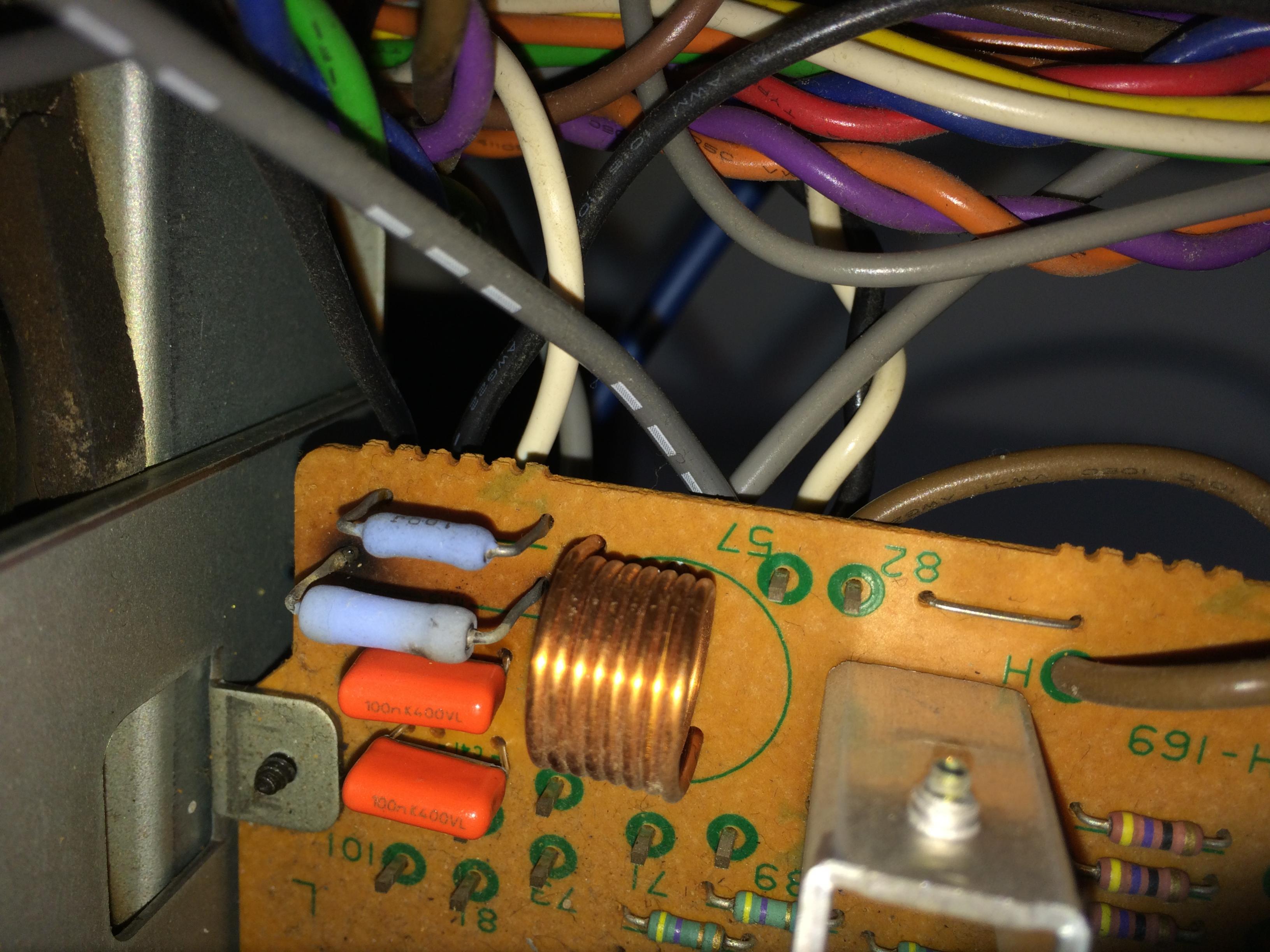

Measure idling current. Put meter on an emitter resistor and tell us the value (in mV). Do this for both channels.
Ok. But forgive my ignorance. I haven't gotten the terms and locations of components down just yet. Which R numbers should I measure?
R99 thru R104, they are dual resistors, do they have test points on top? Measure end to end for now, should be 48mv.

If you notice pins 10 and 12 have the same combined 48mv. So IC1/2 are probably monitoring these voltages and adjusting accordingly. I wonder what else IC1/2 are doing?

That all looks normal, the big 2.2K resistor is dissipating nearly 1 Watt at all times when the amp is on.
