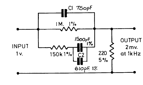

You might like this as something to try with your scope, an inverse RIAA network.
You connect it to a signal generator (read CD player with a frequency sweep) and feed the output into the phono stage. The overall signal produced from the phono stage should be of equal level as the sweep goes from 20 to 20kHz.

A circuit like that can be built in a couple of minutes (honestly) just by wiring it between an 'open type' phono socket and phono plug.
The cap values are critical to it working correctly but the final values can be made up from any combination that gets to the desired value (caps in parallel add in value).

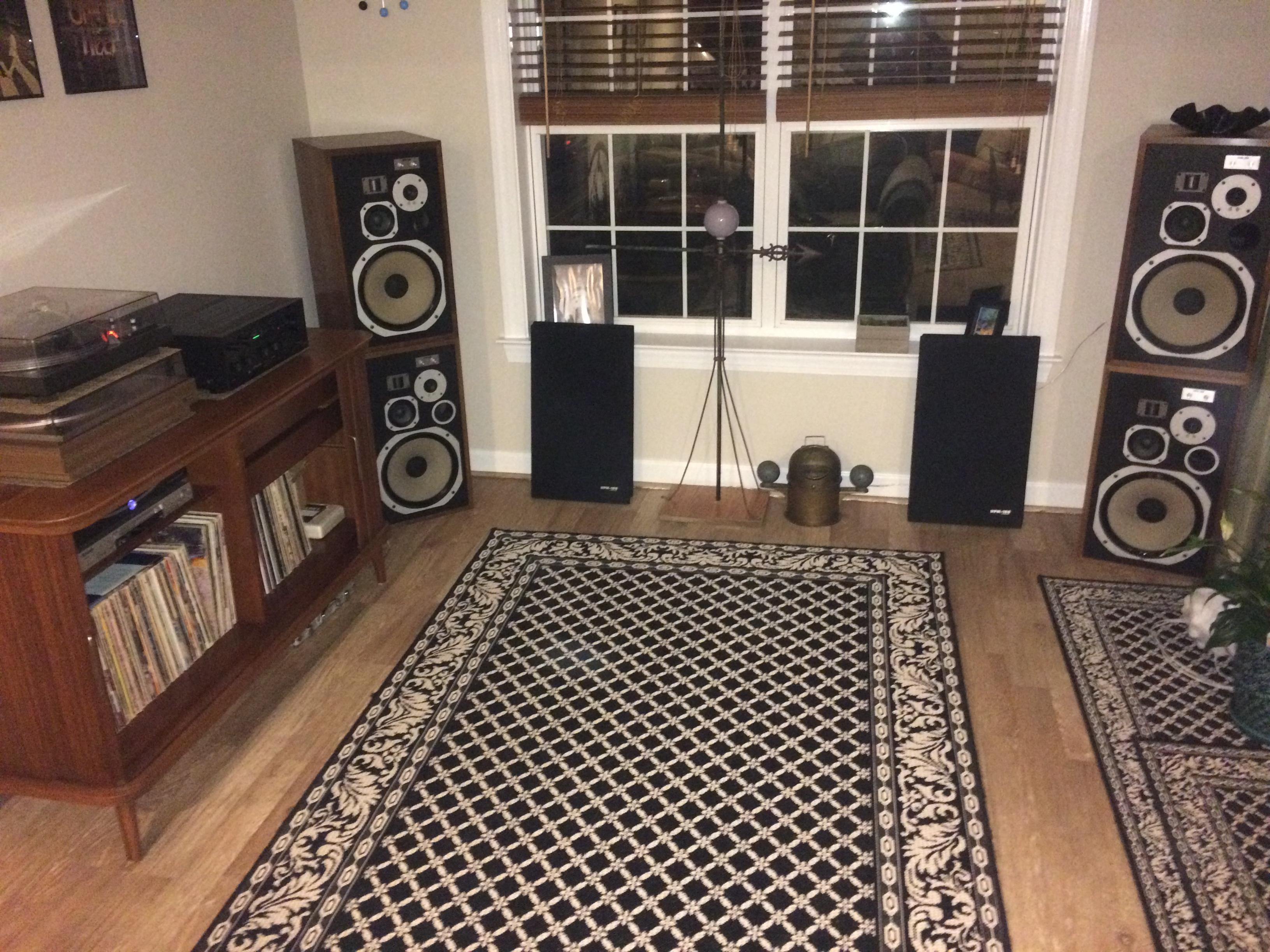

So I gave all the switches and pots a good cleaning with DeOxit and the sound seems much better (even set to MM). I'll check back here form time to time with an update as to how things are going with this amp. At some point I will consider an electrolytic recap, but am holding off on that for a bit. I want to again thank everyone for their help here. I could not have fixed it without the great support here at diyAudio! I have attached a pic of this A-88x's new home in our basement.
