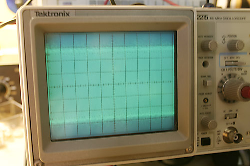

oscillation in a preamp
This is what it looked like on my scope...which caps are my bypass capacitors? Should I check those?

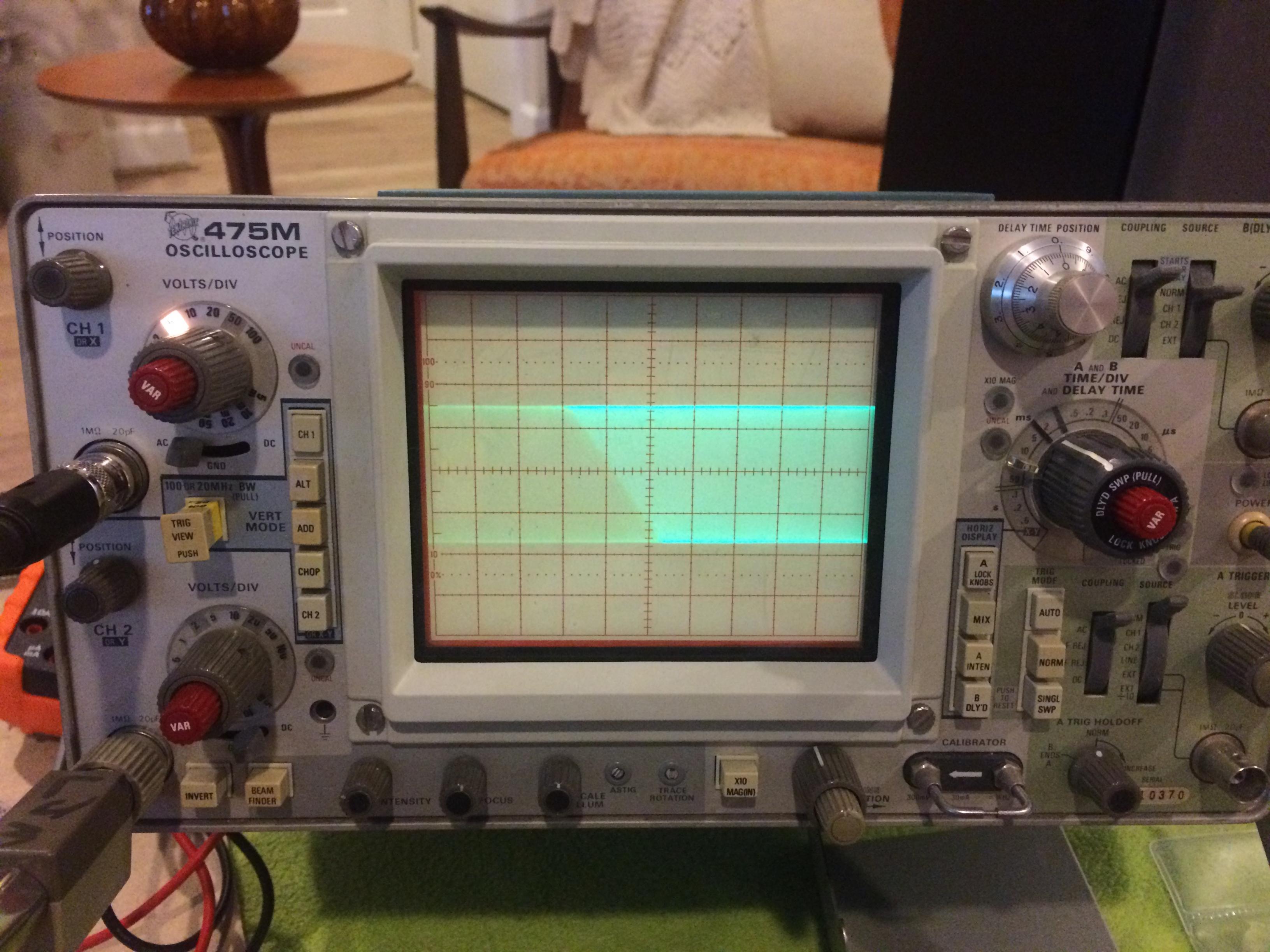

Just caught it. Was playing music on low and turned volume down to zero very fast and scope went blank as trace went off screen. I hear a small pop in speaker when it happens. Changed to 5V/div and here is what I saw. Again, it only lasted a few seconds. Took pic and it went away, back to 7mV.
...what I don't hear is a relay click when it happens. Only small pop in speaker. Yet music stops playing completely on left when it acts up. Right continues to play fine. And it can happen at idle or while playing music...
That certainly looks like instability/oscillation.
And just to be sure, you have the scope connected before the speaker relay so that you are seeing the output of the amplifier at all times, whether or not the relay is active.
Well bypass caps are any rail decoupling... bit of an unlikely suspect I would have thought.
What you really need to do is to see if you can provoke the problem by tapping and bending the board/s. That has to be the first step.
You could also couple the second trace of the scope to the power amplifier input to try and get an idea of whether the problem shows there as well.

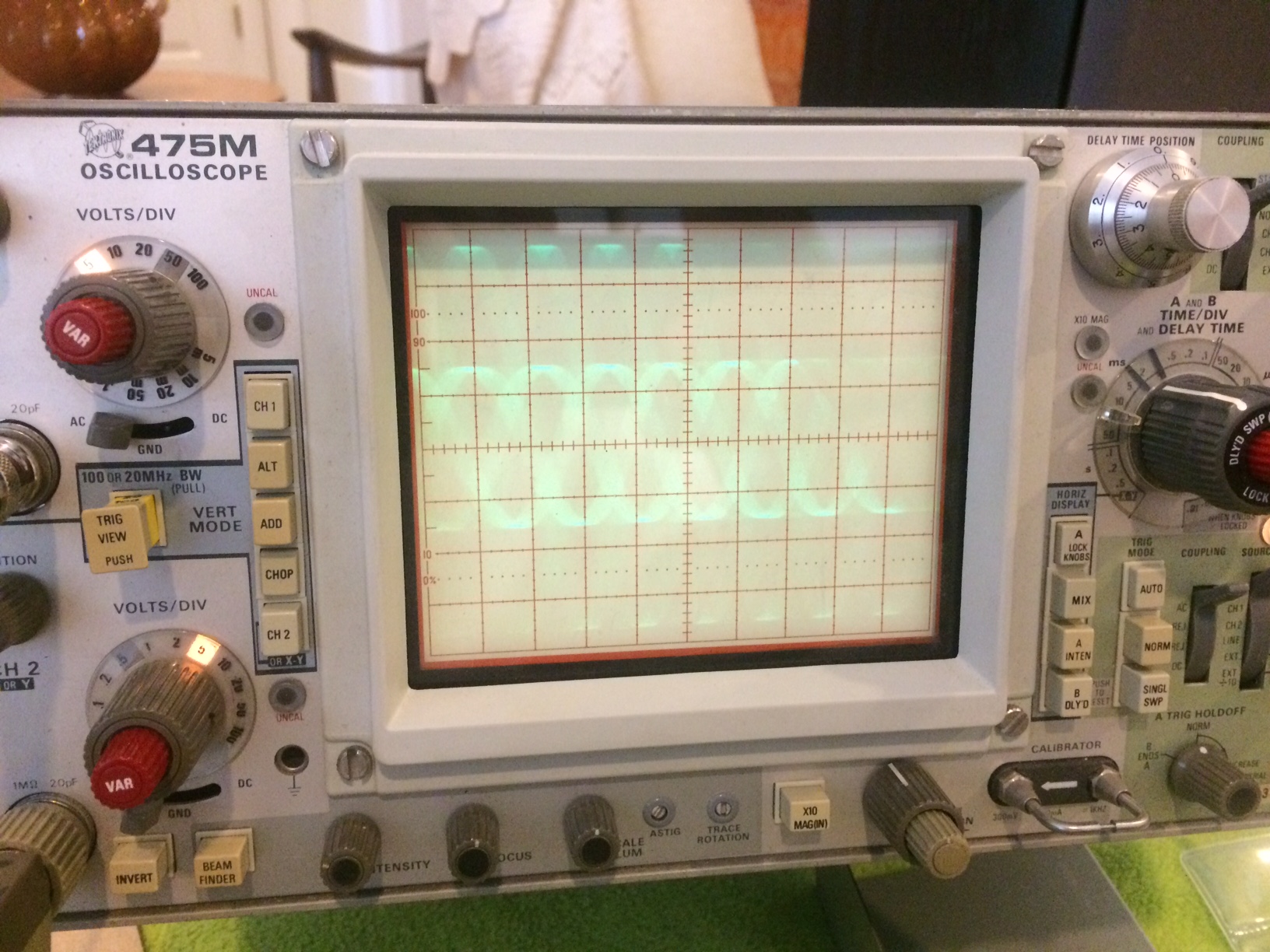

OK, more forceful tapping Voltage Amp Assy board in the area of the Left channel MOSFET got a reaction! Left speaker drops out. Tap some more and it starts playing again. Here is what I see on scope.
Looks like two traces, as probes are not matched even though they are on same settings (5V/div) as I have seen before.
I will try and pinpoint exact component leg and reflow it. If I can't I'll reflow things in this area.
Appears to be in area of C1, R1 and R3 on that board. Flows look good to me, but I will reflow them anyway.
Reflowed them and tapped away with no further response. All's good at the moment. I guess time will tell 🙂
