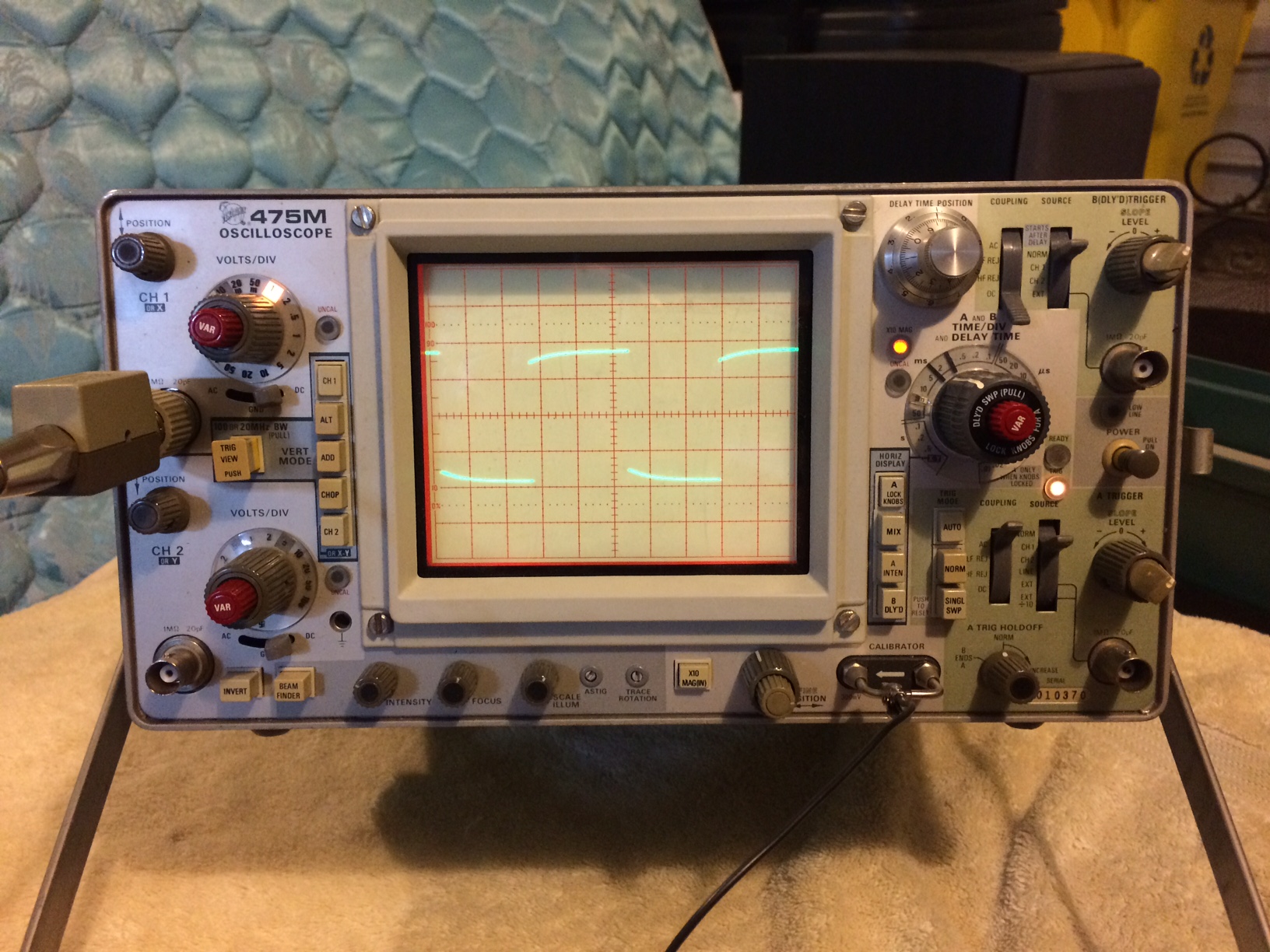

Having powered up the scope, I attached Probe to Ch 1 and am able to see the following when connected to Calibrator. According to operator manual, this is an indication of rolloff. But having looked through the operator and service manuals for similar scope models (can't find a 475M manual), I'm not sure how to make adjustments to flatten the line and eliminate rolloff or overshoot.
One more observation. I can measure a 1.5V battery, and with Volts/Div set to 1V, the beam is midway across 2 bar, 1.5V. But I can't seem to measure the -4mV on the right speaker outs of the amp, or the 7.4mV of the left. Setting Volts/Div down to .1V does not seem to help. I get a flat line across the 0V line.
The probe is fine. The 'roll off' is because the probe isn't compensated to match the input capacitance of the scope.
Look carefully at the probe. There should be a trimmer, probably in that box contraption 🙂 or on the probe itself. Give it a tweak to flatten the trace.

Found the probe adjustment and now have a flat line without rolloff. This scope has Volt/Div with settings from 5m to 100. I assume that is 5mV up to 100V. But the dial only allows me to go down to 50m. I cannot turn either Ch1 or 2 any lower than 50m. I cannot select 5m, 10m or 20m.

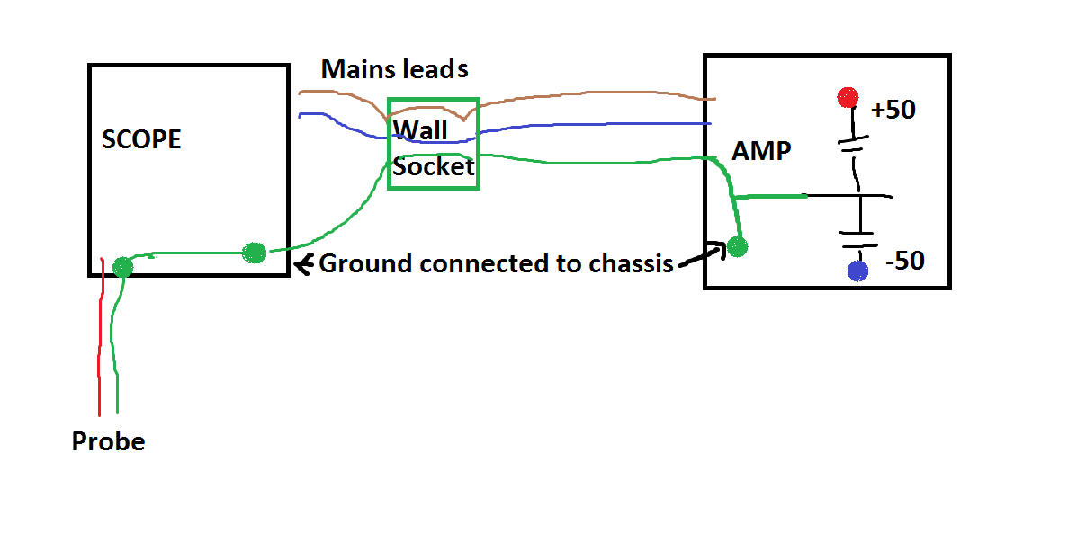

The grounds...
Imagine taking a piece of wire and shorting one of the big reservoirs cap out in the amp. You wouldn't dream of doing that...
That is exactly what can happen when both amp and scope are grounded.
Think of the path... the amp chassis is mains grounded (via a 3 core mains lead or via the input leads and a CD player etc that is mains grounded). The scope is also grounded. Its the same connection. So touching the scope ground lead (the probe tip is safe to touch on anything in the amp) on anything with voltage on it will place a dead short from that point to chassis.
Draw it out and it will make sense 🙂

In your picture you seem to have x10 magnification selected (led lit) which looks like it applies to the horizontal axis. You don't want that on.

Thanks Mooly. I'll try it tonight. As for your diagram. My amp only has 2 AC prongs on power cable. So it isnt the same ground shared by the scope. Right?

Your amp having no ground of its own means that wherever you connect the scope ground to within the amp will become 'ground' as well.
So... and DONT do this... you could connect the probe ground to say the positive rail in the amp. Then the scope would be measuring all voltages relative to that point. Just the same as if you connected your black meter lead to the positive rail. All voltages would then be measured relative to that point.
Your amp would let you get away with that from the point of view of it going bang. An amp with its own mains lead ground would not.
