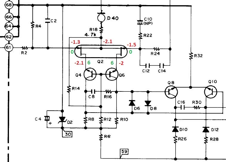

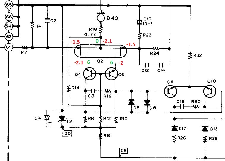

I checked Q1 and Q2 last night. Q1 looks good, but Q2 measurements are off. Q2 itself may be ok, but the voltages coming in and out are off, so something surrounding it may be bad. See diagram I have attached for the voltages I should see in green, and the voltages I am seeing, in red.
If R115/116 are hot that means the amplifier is oscillating. Those resistors should never get hot under normal circumstances. They will heat up if the amp is run into clipping for a time or it's oscillating. Could be why your voltages are off spec.

Is that .9V AC or DC? If AC it's probably much higher but the frequency will be so high your meter won't be very accurate. If it's DC then you have a major offset problem. But if it is DC the resistor won't get hot because of C39/41. There should be NO DC continuity thru C39/41.
As far as the wrong voltages at Q1/2 the only place the negative voltage can come from is thru the FET itself, pull it and check it. Do you have +30VDC on R6,8,10,12?

Q1/2 are dual FETs so BCE don't work. It's Drain, Source, and Gate. Google "testing FETs".
So your voltages are DC, you have DC offset and if the resistor is hot you oscillation on top of that. This is going to be a fun one. You might think about pulling the fuse on one channel and work on one channel at a time.

Preferably don't fiddle with the JFETs, they are very ESD sensitive and very obsolete, so if they die, you're in a bad situation.
Just need find the current of a 10YD45AFD, 4.5ma maybe? Then measure across R17/18 to see if it jives.
Craig
Craig
Add up the collector currents plus some for the 30V Zener and it's pretty damn close to 4.5ma.

Craig/Jaycee, I'm not sure I follow what you are saying in the last 3 posts. I can pull D40 to check it but help me understand the 4.5mA tests.

D40 is a current regulating diode. I've seen these go bad.
Pulled one lead on both D39 and D40. And using Diode setting on my DMM, I get 000 reading in both directions on both diodes.
Picking up a new DMM today as mine doesn't seem to measure resistance accurately (not getting readings I should on known resistor values). So I'm not sure I trust the Diode readings either.
You can't read a CCD (constant current diode on a meter). If its a 4.5ma device as Craig and Jaycee and llwhtt suggested then you should see up to, but not more than around 21 volts across R18. If the reading is less then its not necessarily the diode at fault, the FET's could be biased off more than they should be.
A 0.00 reading on the meter could be OK depending what range you are on as the diode is simply a junction fet configured as a current source.
