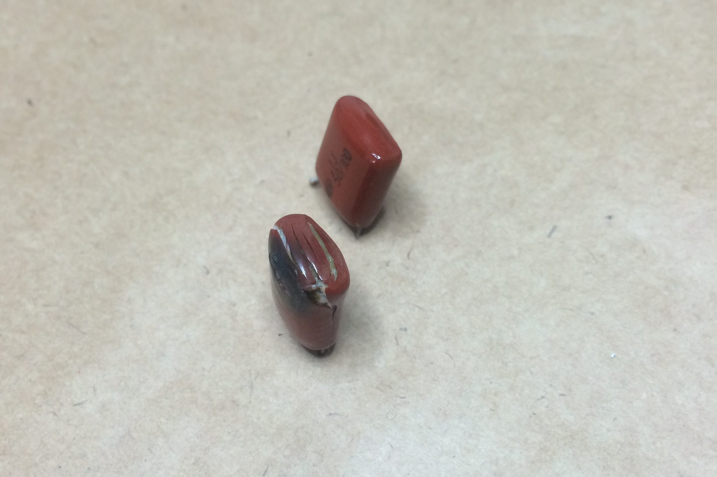

Update. The left channel was bad. The fried/cracked cap is C39. It was touching R115, 2W 10Ohm resistor which probably gets pretty warm. I replaced both C39 and C41 with new Vishay .1 uF Film Caps.

Here is a pic of C39/C41 caps.

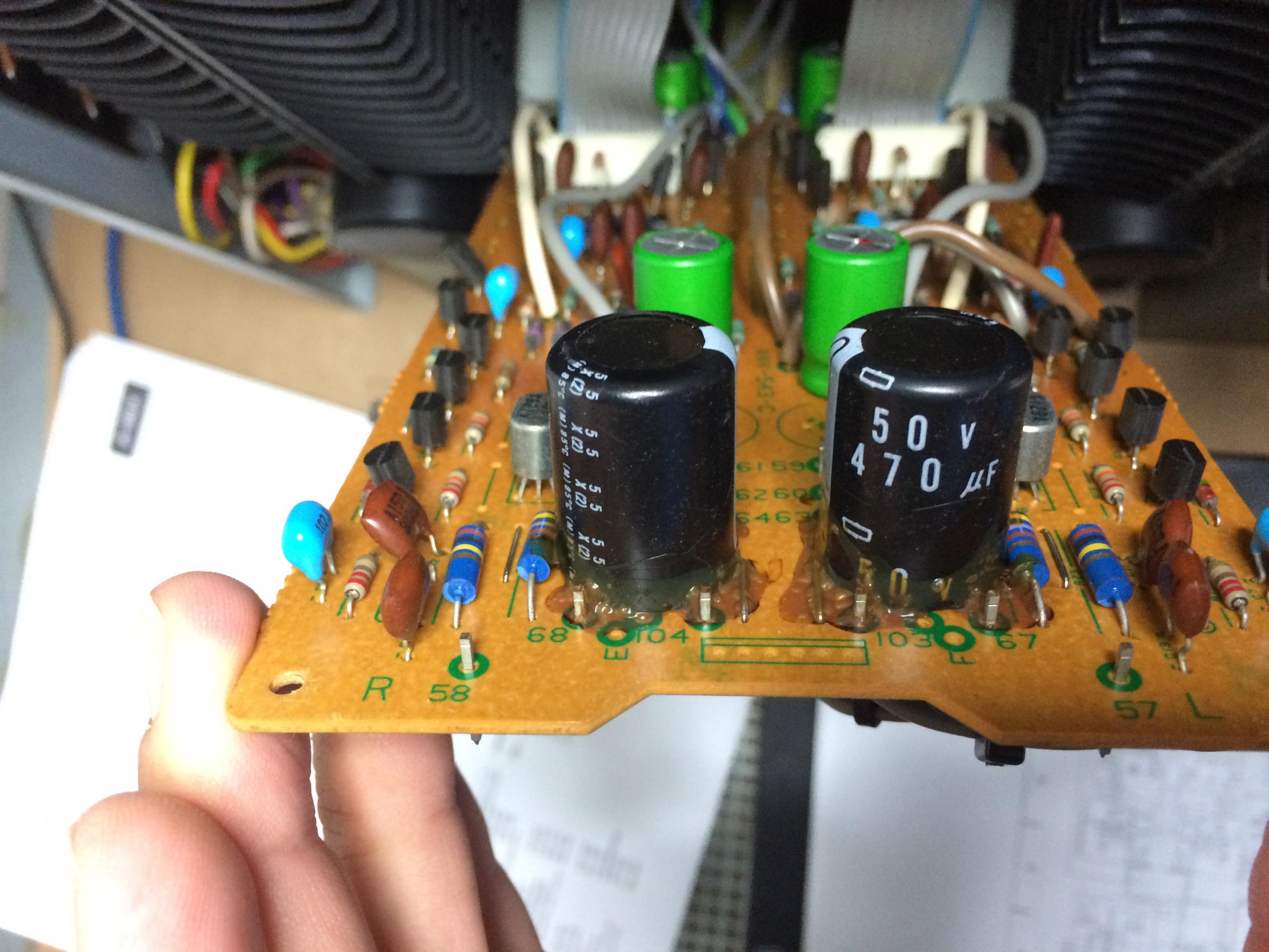

Well, what do you make of this? According to schematic and Parts Location diagrams, C9 and C10 are supposed to be 470uF 25V NP. Non polarized. But mine are 470uF 50V polarized. I assumed the gunk around them was glue. Or are they leaking?
