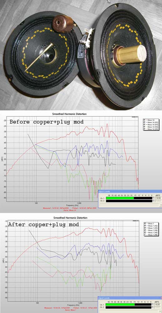

John L, I suggest you put copper cap below phase plug.
I tried it with pa160 driver, and it does reduce distortion.
(mostly 4th and 5th order) those caps are sold in home depot,
in plumbing supply section. and cost about $2 each.
you just need to drill a hole in that cap and attach it with
brass screw, going through magnet and cap into phase plug.

MisterTwister said:John L, I suggest you put copper cap below phase plug.
interesting. do you have any literature I can read about this copper advantage? Also, I cannot place a screw in the middle of the phase plug, because that is where the wiring will travel to the rear of the B20, through the new hole in the pole piece.
I don't know where you can read about copper advantage. I did my own distortion measurements. I'll post some pictures later. I mistyped driver's model, it's pa165
MisterTwister said:I don't know where you can read about copper advantage. I did my own distortion measurements. I'll post some pictures later. I mistyped driver's model, it's pa165
Both the PA165 and the PA130 seem to have great potential. They are inexpensive AND quite efficient. They are not the prettiest in the world, but still look good enough.
Wouldn't the copper cap in that position work as a copper shorting ring and a copper heat sink all at once? That can't be bad for performance.

MisterTwister said:I suggest you put copper cap below phase plug.
Are you talking about a copper disk or a cap...
dave
dave
Good question. If a disk, I don't have to get a smaller dowel. With I cap, I will.
The problem with a cap is that it needs to cap the pole piece not the plug.
dave

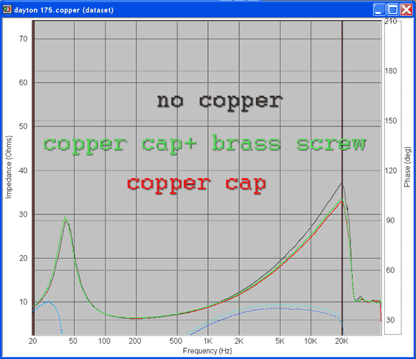

here is the picture. I couldn't find after mod measurements. I just made a new one, so these are not very accurate. but like in previous measurement there is obvious improvement below 1Khz. I just got these speakers ready for my car. they have very small xmax, so I plan to cross them at 175hz.
here are impedance measurements. they probably make more sence. it is better not to use screw through pole piece. you can just glue cap on top of pole, and ran tweeter wires through hole as intended. the thicker and closer copper cap to voice coil, the better results.
p.s. drilled hole in copper cap is required, so it becomes a ring 🙂
MisterTwister,
A bit of a non standard EnABL pattern. Do you have a subjective evaluation to report?
Bud
Bud
I never tried these speakers in a box. I listened them only free air. I can't say that I noticed any difference. I guess I did it wrong way if you noticed that it's non standard. at least it looks cool 🙂
